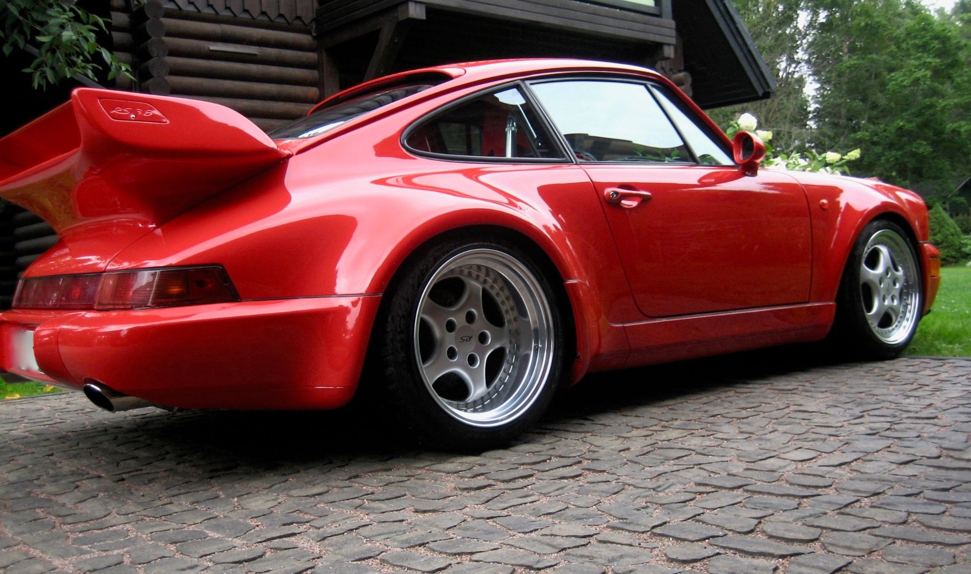

You are going to have lot of fun, when its ready! Just curious to know how about lag with single turbo?
Here is my twin.

Jul 29, 2019 | 02:19 PM
  #44
@Bruni Gorgeous! Some call it turbo lag, some call it staying in the power band - ha. I have a couple big hp turbo Audis, one an inline-5 single and one a 2.7 V6 twin, and there's something romantic about the sensation of the single, but I also fondly remember racing 2-stroke motorcycles which had power bands so razor thin you had to be a magician with the clutch to keep them 'on pipe'. Is yours a C4 or C2? Would love to see more of what you did? And thanks!

  #45
Quote: @Bruni Gorgeous! Some call it turbo lag, some call it staying in the power band - ha. I have a couple big hp turbo Audis, one an inline-5 single and one a 2.7 V6 twin, and there's something romantic about the sensation of the single, but I also fondly remember racing 2-stroke motorcycles which had power bands so razor thin you had to be a magician with the clutch to keep them 'on pipe'. Is yours a C4 or C2? Would love to see more of what you did? And thanks!
This is C4. I like 4WD cars and i had them as Audi S2, Lancia Integrale 8v, and 16v.
