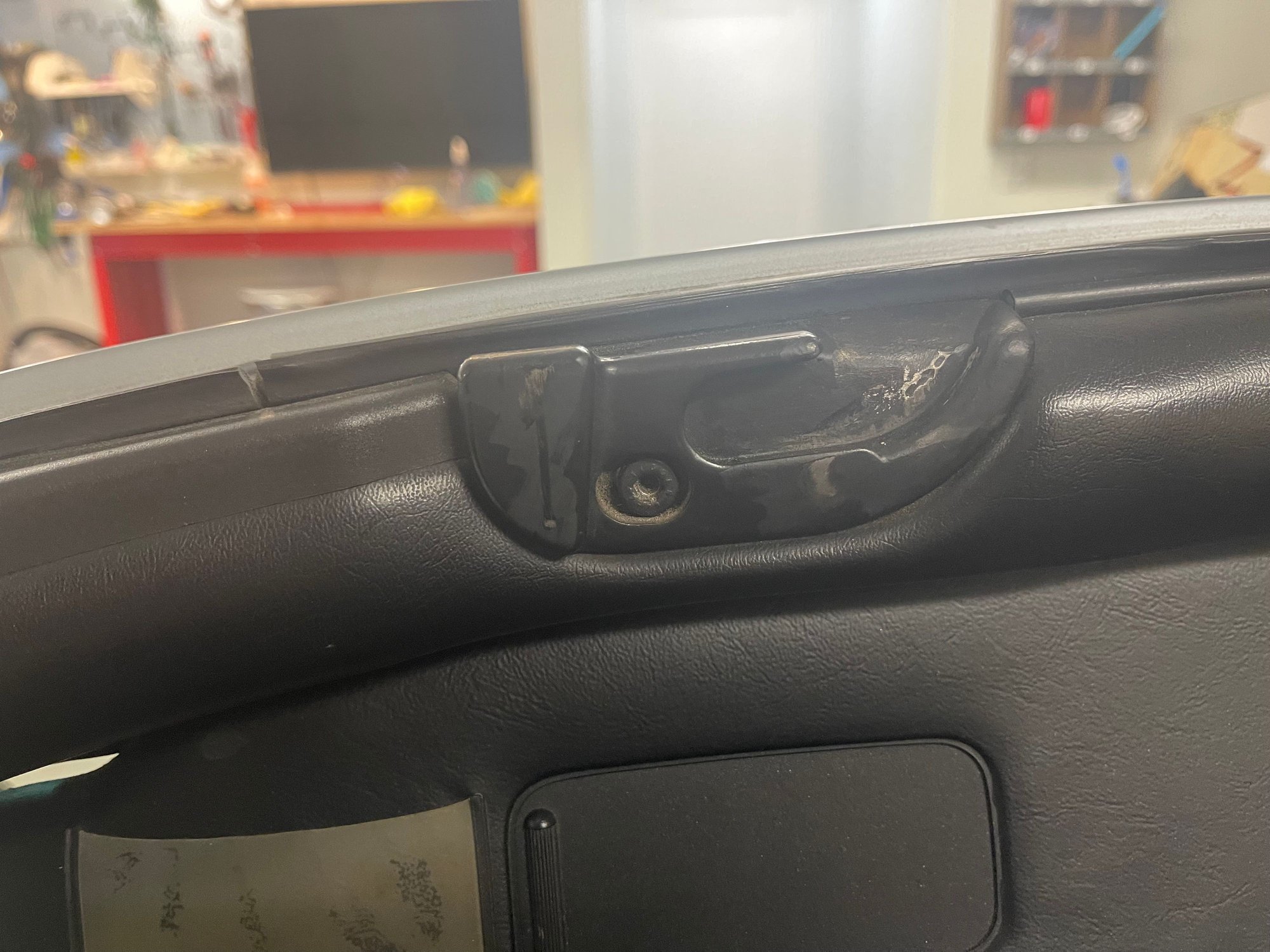

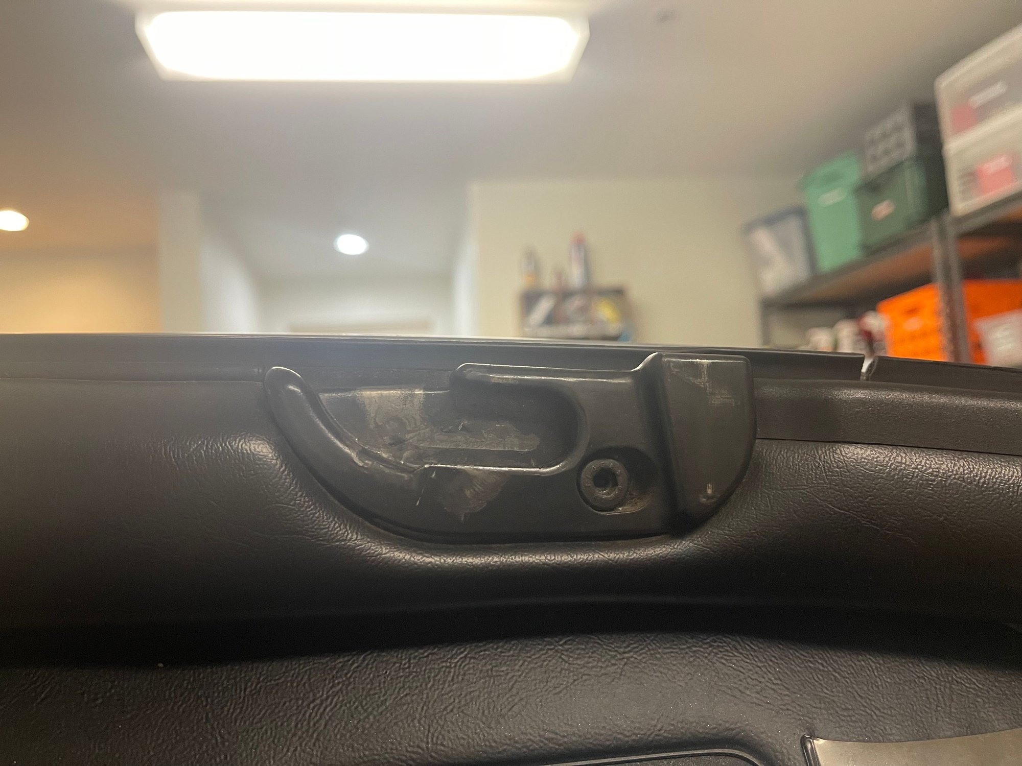

Finally have been able to source the right side latch used for a decent price. Question now is how to remove the parts from the windshield header? I can see the one fastener but how do you access the bolt behind the upholstery? I don't want to just start prying on stuff and damage anything. Any tips?

So does anyone know how to get to this bolt?? How do you remove the trim that’s covering it?

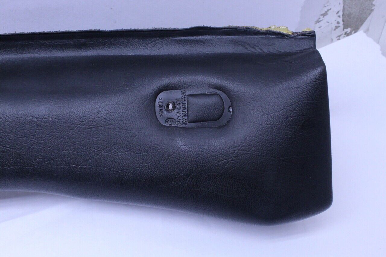

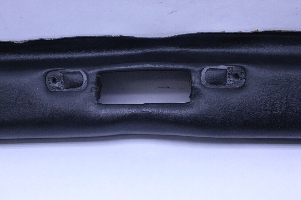

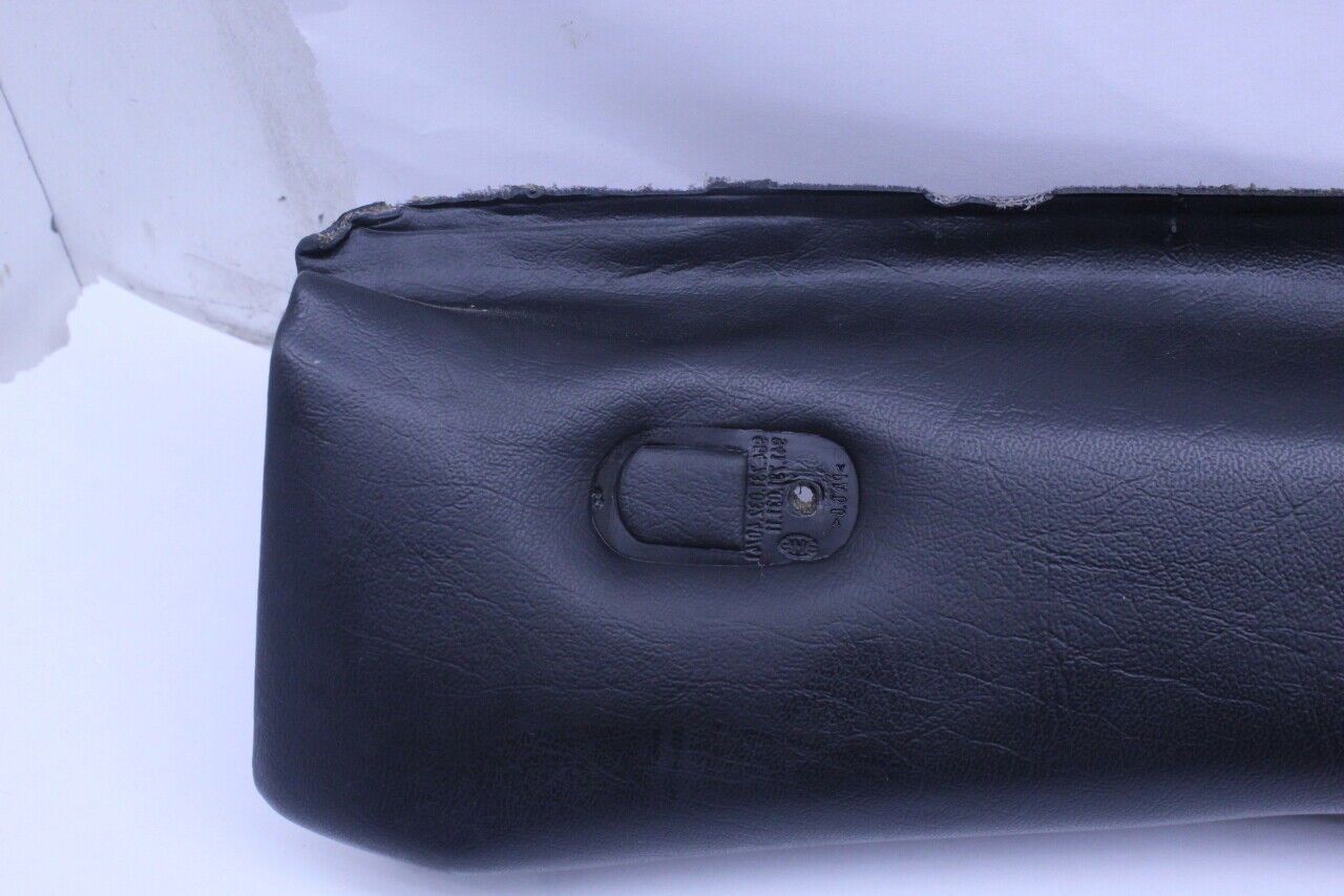

I meant to reply earlier but I got sidetracked. Looking at this listing from eBay , it looks like that panel is held in by the sun visor screws. Perhaps there are a couple clips or some adhesive to deal with, but my guess is that you should be able to gently pop that panel if you remove the 4 sun visors screws (+ maybe 1 or 2 for the dome light). Looking at my cab, I don't see anything else obvious holding that panel in place.
