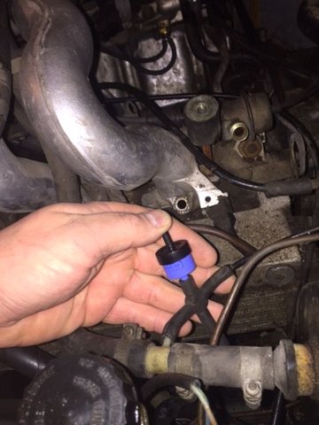

i was working under the hood today, added thisblack and blue thing ( old one was all broke) where does the vacuum line go from this to what????

Line from the brake booster check valve fits there.

What Sean said.
Red circle here.

Make sure that vacuum check valve is oriented in the correct direction. Vacuum flow is towards the intake.
