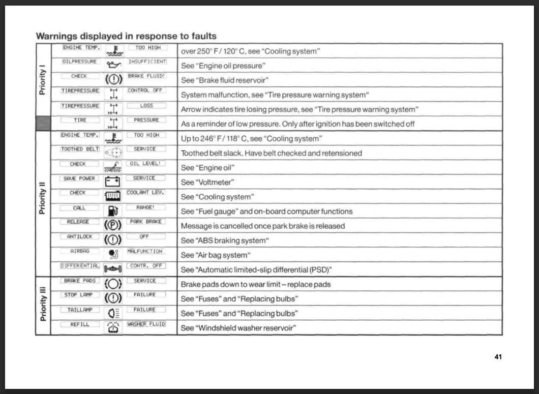

I hope this will help.
This is from the '91 owner's manual.
Thanks AO.
Looks like low voltage. Alternator, loose belt?
