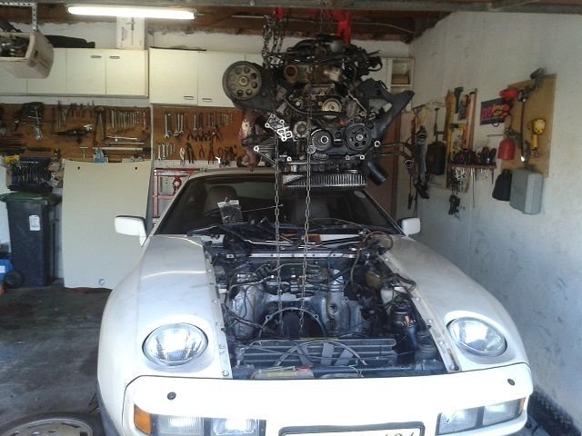

Second day I had the car I already pulled the motor to make life easier and to check everything.
I am going to stop beating myself up about this and simply spend the money on the cam and rebuild.
Still have to check if I have any bent valves.
Any ideas on how to do that without removing the heads ??

Without being able to spin the engine, I don't know of a way to check for bent valves. You can't do a compression test like it sits.
If the engine is already out it's not a big deal to pull the valves. However, if you have bent valves, I would expect to see witness marks in the top of the piston as well.

Check for bent valves with a leakdown test. The test puts air pressure in the cylider with piston at TDC on the compression stroke. The 'leakdown' test is a flow measurement through a precision orifice, with pressure upstream and downstream of the orifice used to figure out how much air passes through bent valves and/or leaking rings.
For just a simple test go/no go on valve leakage, you can put each cylinder at TDC and put air pressure on them. It doesn't take much, and you really don't want a lot since you risk the air spinning the engine. Test is usually done with 100 PSI to make the flow test easy, less needed to just listem to the exhaust and intake for leaking air through a bent valve.
