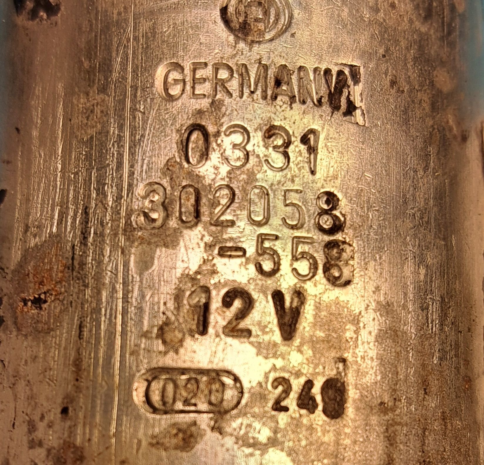

I have just refurbished parts of the startersystem and solenoid. The startermotor and solenoid come in different parts and are not difficult to take apart. The solenoid has stamped numbers on it and can be found NOS or used on ebay. My startermotor was perfectly fine but the contact/relayplate on the solenoid was bad. I my case my starterrelay was also bad so make sure you look this up also. There are good write-ups online on how to test the starter and solenoid functions. To change the solenoid this way is about a 5th of the cost of a whole startermotor/unit.

Starter Solenoid part number is Bosch 0 331 302 058, correct?
Old Feb 4, 2025 | 06:57 PM
WestInc's Avatar
WestInc
Joined: Oct 2021
Posts: 900
Likes: 755
From: Sweden
Yes, on my 1983 Euro 928s it is that number.

Alternate Starter Solenoid Part Numbers
Bosch: 0 331 302 058
Wagner: W450-35
Lester: 16609
OBB: 66-9158
Accumax: 10-BO158
ERA: ZM528
ACE/Accurate: 7-749
HC-Cargo: 135358
Kailiec: BO-158
Renault: 77 01 348 605
Be sure to check fitment before ordering.
