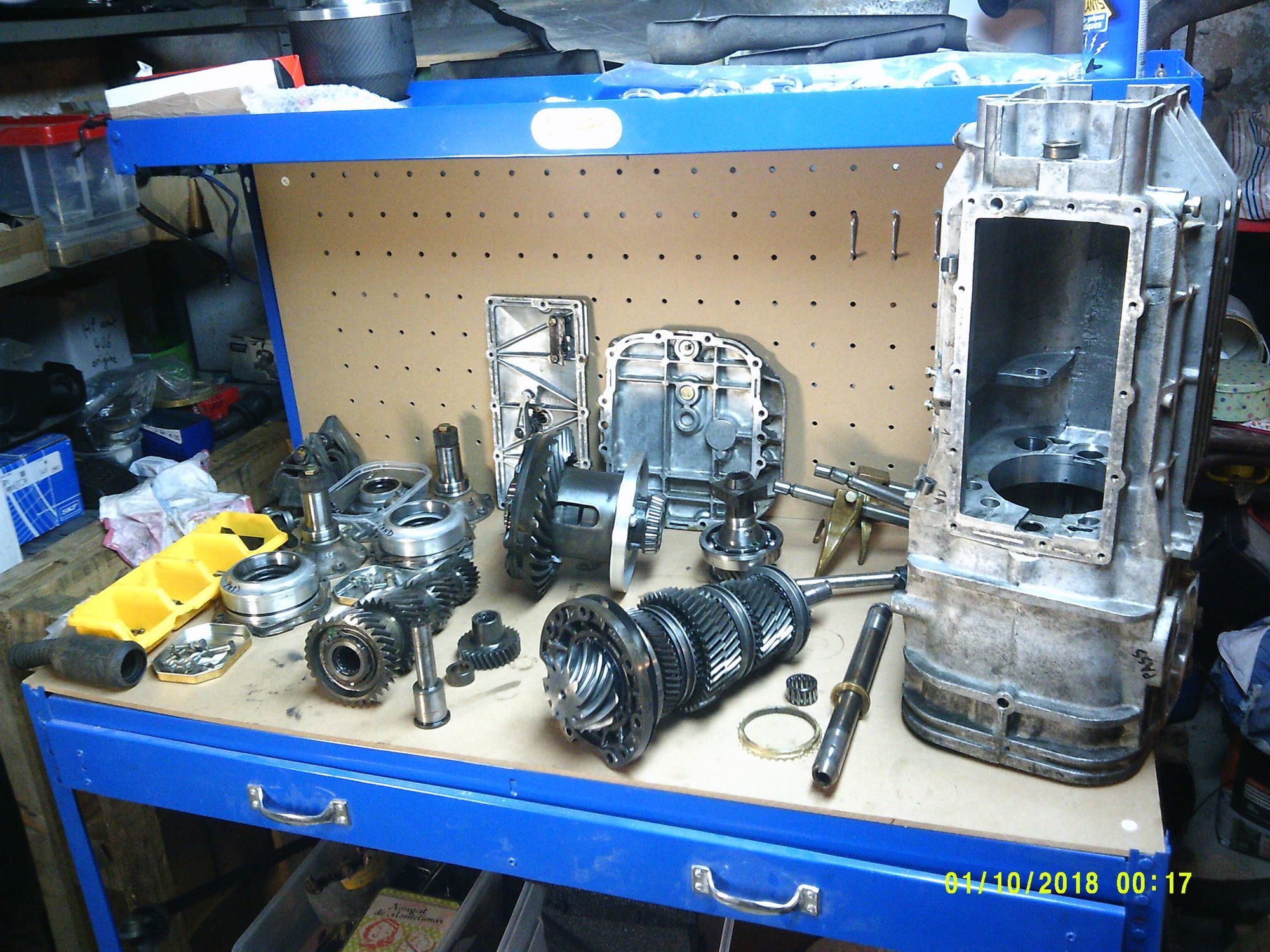

Bonjour,
Gearbox disassembled... it remain the main shaft to unscrew... I'm waiting to find a correct solution to do it correctly (a deep 41mm socket)
I have received my syncro...
Steel version of 928 304 211 05 :
The syncro looks to have exactly the same dimensions than the former brass 928 304 211 05. The nub has the same width : half an inch.
And here, 928 304 211 30 syncro :
It has half number of teeth but I was rather worry about the width of the nub : only 0,4"...
So I tried all the syncros in place of the 5 gear syncro and they all fit... Even the 928 304 211 30 :
The syncro looks to fit... and to shift correctly... I hope it will be good.
But as all syncro looks to fit here on gear 5... they may all fit at other locations (1 to 4). So steel version of 928 304 211 05 looks to interchange with 928 304 211 12 also...
Greg, you confirm I'm right?
My original brass syncro on gear 5 looks new so I will let it in place. I plan to put the steel version of 928 304 211 05 on gear 4 and 928 304 211 30 syncro on gear 1 to 3. They (1 to 3) all looks worn out. I will also change the reverse syncro but for this one I will use the former 928 304 211 02.
If you have any comments or confirmation it will be greatly appreciated. Removing all this staff is not piece of cake so if I could avoid to do it twice!!!!
