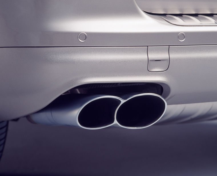

As you can see, the rear bumper cover has dual exhaust outlets in non stock locations. A new exhaust will be fabricated. At this point, I plan to fabricate some exhaust tips out of oval stainless pipe that will mimic the look of the tips on an early Cayenne Turbo. What do you think?

Nice choice, those Cayenne twin tips will look great. What color interior are you going with ? T

Of all the body mods i would like to do to my car, having a dual exhaust with dual tips like that is top of the list.
