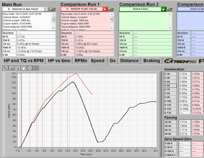

Originally Posted by SQLGuy
I've seen a few postings saying this (that the twin screw setup is best overall, especially for low-end).
That's because people like to confuse "boost" with "power". Just because you are making boost doesn't mean the car is making any power.
As for the claim "no power under 4k".......the person claiming this did not buy a Murf928 kit, and the setup he did buy also had him buying a SharkTuner to tune it himself.
I'll stop there to avoid saying something I might regret later. It's just a perfect example showing there is a lot more to making power than simply shoving some boost at the throttle plate.
How about actual performance? Isn't that what we are really after here? To actually go faster?.....what a silly concept.
I don't putz around town in 5th gear all day.
Here is a good comparison.
Same day, same road, one right behind the other. Here is a Murf Stage III S4 Automatic versus AO's twin screw GT:
The red line / box is the Murf928 Stage III
