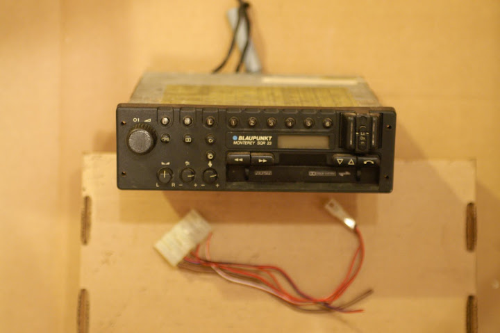

Just out of curiosity anyone recognize what kind of radio that is? I can make out the Blaupunkt...
It looks to be the original radio, option M158 - Radio "Monterey"

Yep, that the same radio that is in my car. My casette door is also off, I have it though. Some of the buttons on mine are no longer working also, like one preset, AM and SW, but FM still works.
