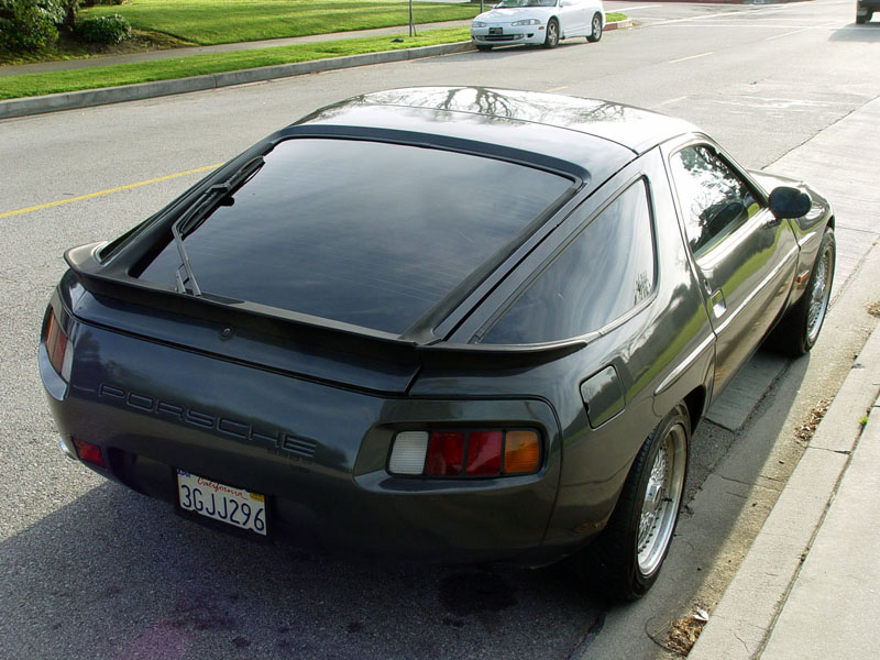

One thing that will help that gap, is to add VW "fender beading" to that gap.
It's the same stuff that lines the bumper covers. You just unscrew the trim
piece, and insert the fender beading, and bolt it back down. It's a nice mod,
and it looks a lot better... It's only $12 for a roll of it...
Here's a couple pics of my car after the fix:
A little hard to see, but you get the idea...
http://www.thedeathknight.com/928/92...ear_top_34.jpg
http://www.thedeathknight.com/928/928_rear_logo.jpg

Hey bcdavis. You have the same problem that I do. Your wing on your hatch doesn't quite line up with the wing tips on the hips. Is this normal? Maybe I don't have a problem after all.
