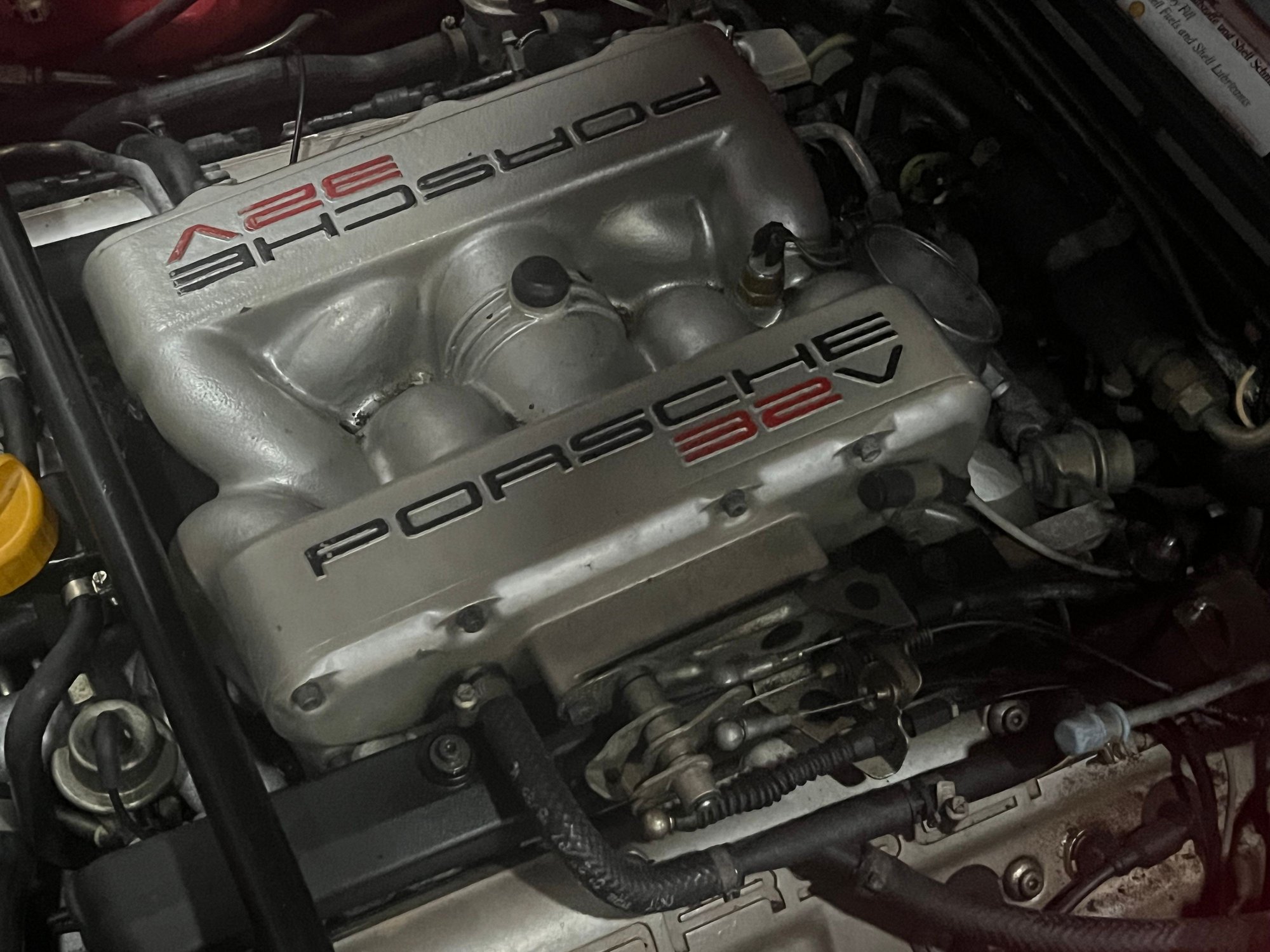

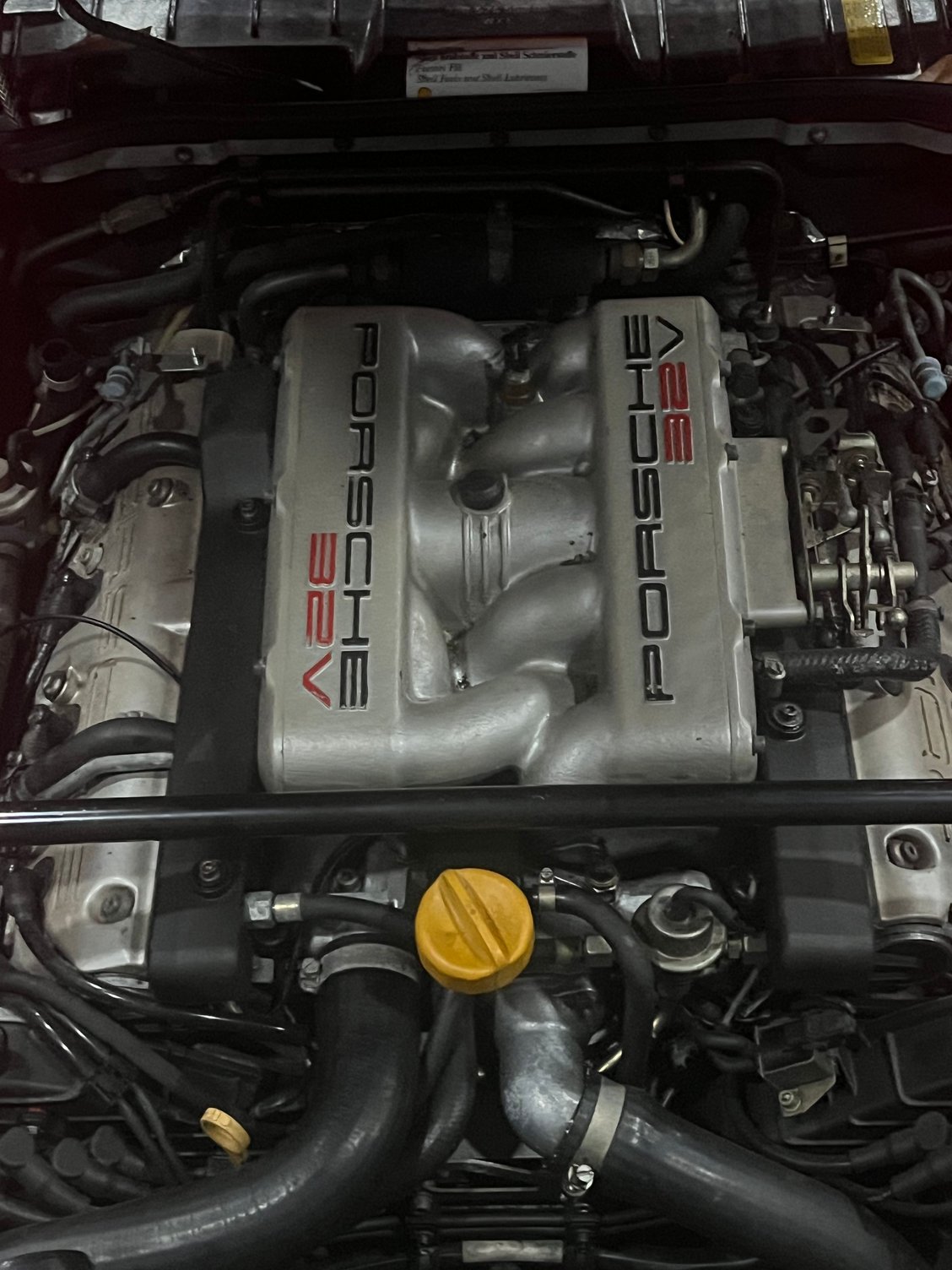

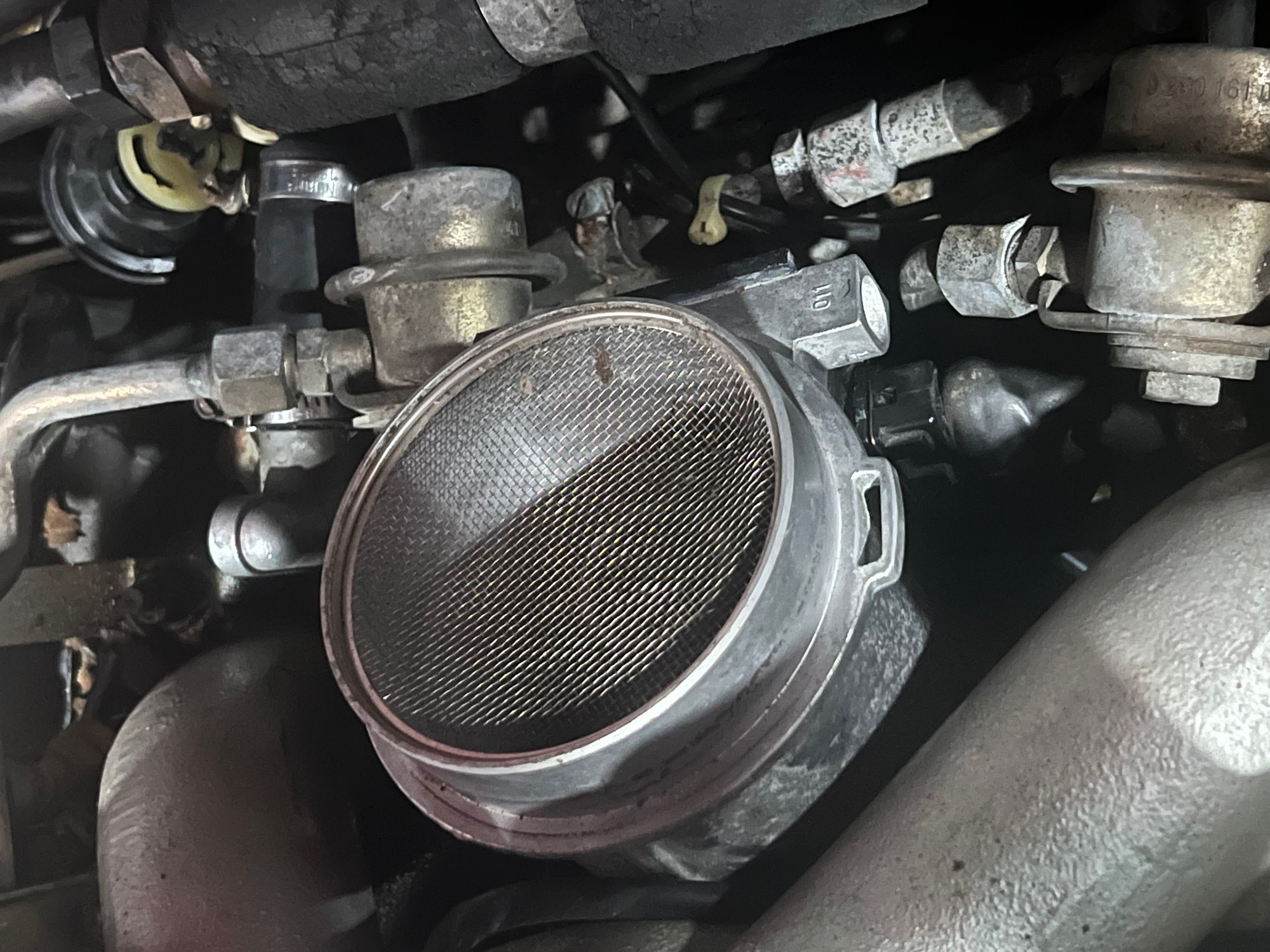

Very confused. Checked the above relays and could feel a light click with key on. Just for the hell of it I switch the horn relay to the EZK relay and it start. Very crappy sounding but started. Now here’s the screwed up part. I had unplugged the intake and had forgotten to plugged it back in and therefore figured that was the cause of the crappy idle. So I put it all back together, plugged the intake which I assume is the MAF , reinstalled the air cleaner etc. go to start the car and No Start. Just crank. And cannot reproduce it. I switched out the three relays mentioned with a good horn relay , unplugged the MAF , No Start! Back to square one. So what the hell did I do that got it to start? !
Old Apr 22, 2026 | 09:55 PM
Mrmerlin's Avatar
Mrmerlin
Team Owner
Joined: May 2004
Posts: 31,233
Likes: 4,218
From: Philly PA
before we go much further please post a few pictures of the engine
Old Apr 22, 2026 | 10:01 PM
Drswiger's Avatar
Drswiger
Joined: Dec 2016
Posts: 72
Likes: 33
