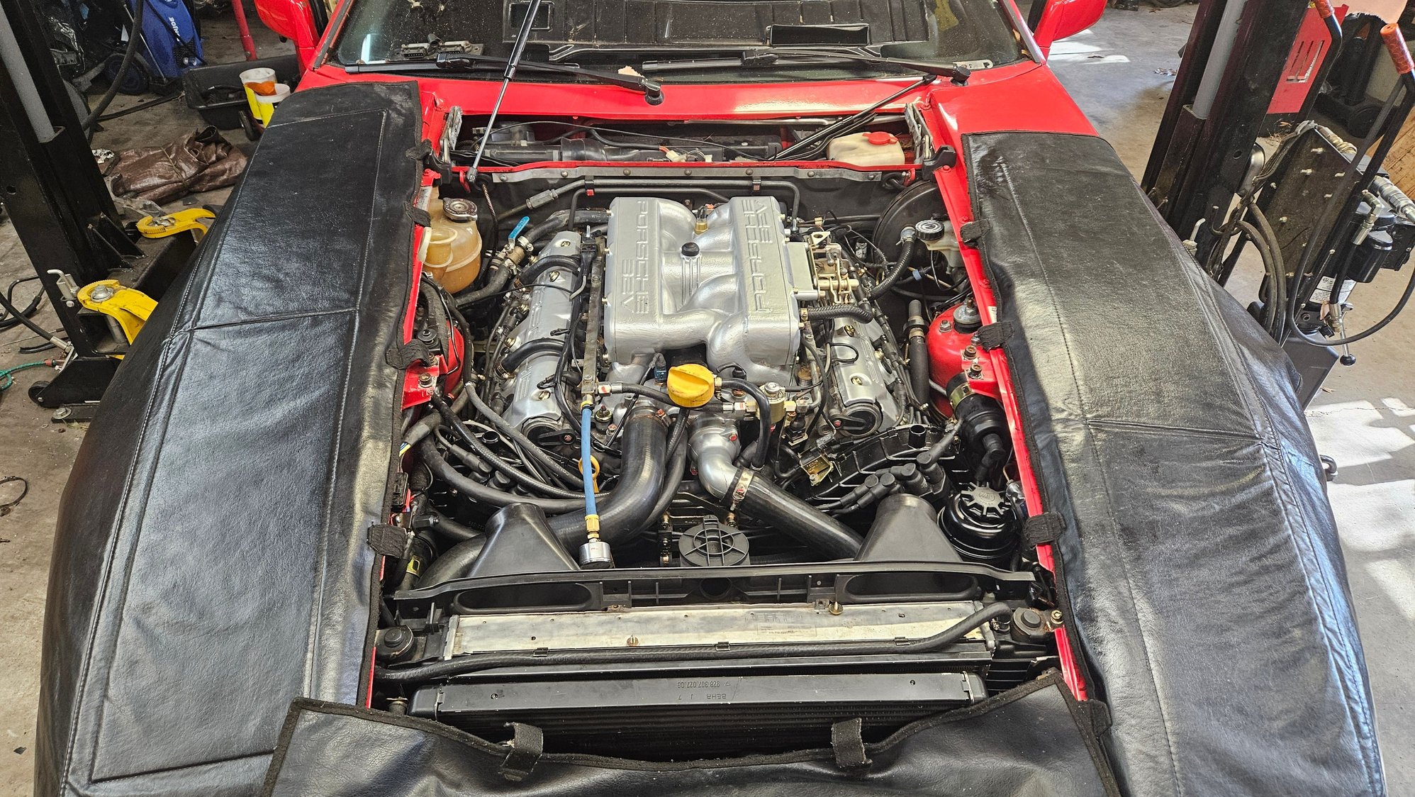

Just got done with an engine out refresh.
Replaced everything that could be replaced per the customer.
Warm start idle is 675. After a few seconds drops to half that. Idle is steady. New idle air valve. Don't think it's the new air valve. But anything's possible.

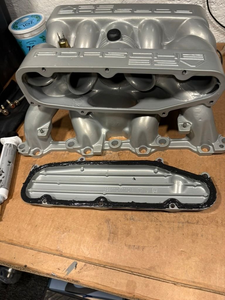

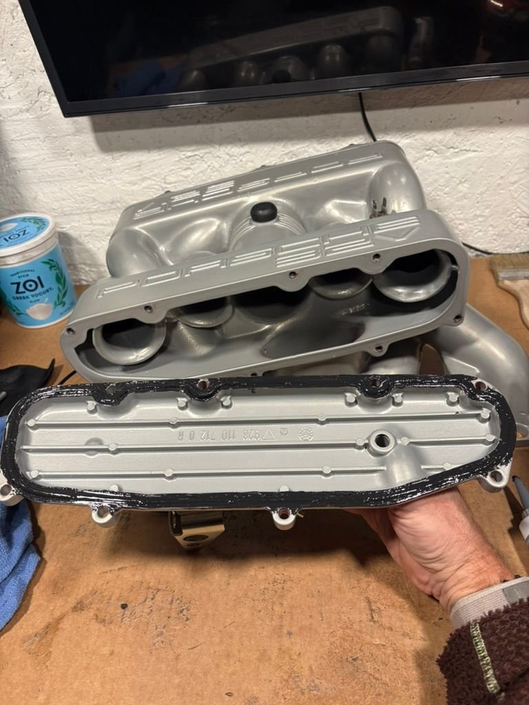

When you did the top end refresh, did you put additional sealant on the manifold side caps? That is a place that can develop vacuum leaks espcially after powder coating. @Mrmerlin turned me onto that one. My focus on idle vacuum is around the vacuum feed to the FPR, do you have enough.

I always inspect the manifold mating surfaces after powder coating. My guys are pretty meticulous.
