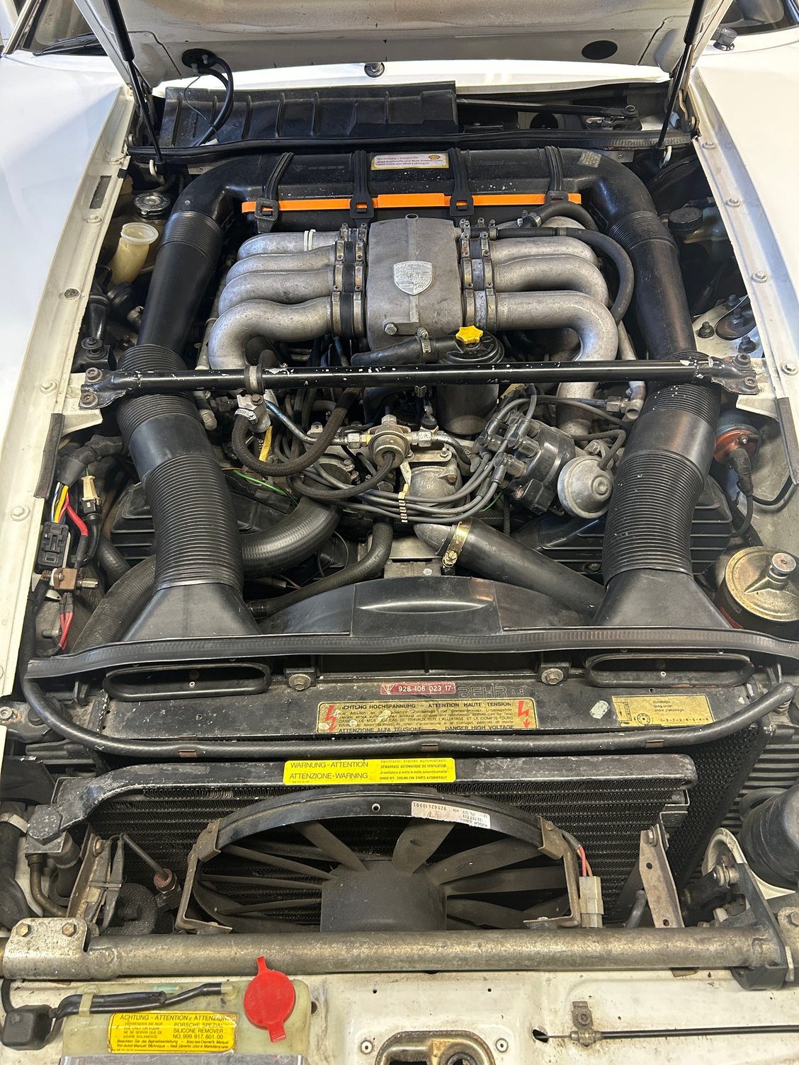

upside down air cleaner filter,
no hot post cover ,
coil cover missing
Green wire looks new is it a Bosch wire or URO version?
Eductor port misrouted SB going down between the two aft legs of the spider
Washer spout cap missing
no hot post cover ,
coil cover missing
Thanks for the input.
air cleaner is easy to fix
Hot post cover in a bin in the garage - looking for opportunity to install
Coil cover is needed
Green wire is the Porsche (Bosch) version. FOE installed (thanks Sean Ratts for supplying the replacement)
Attempted to locate the port plumbing but was not able at the time -- will look at it again.
Washer spout and the spout cap need replaced - used part is in the same bin as the hot post cover. awaiting opportunity to install.
My 928 is a project. I am enjoying the journey as well as the finish.
