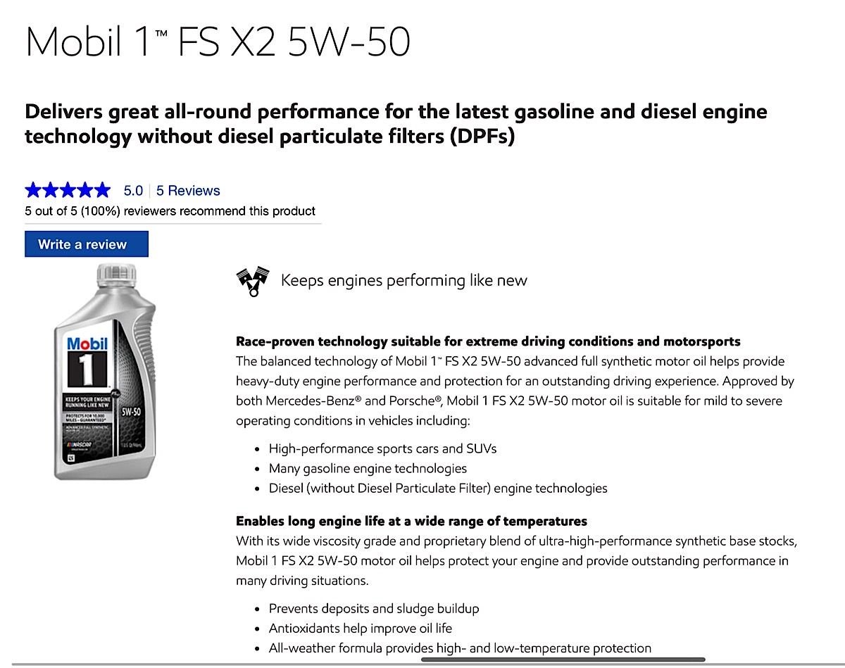

Anybody looked into Mobil 1 5w-50? For those using their 928s in winter conditions.

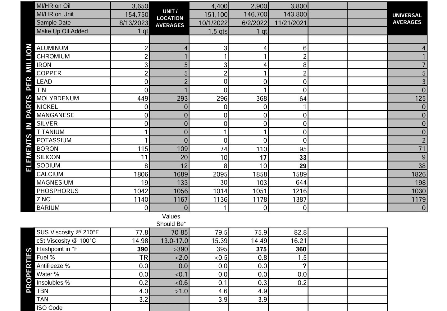

Here's an 84 Euro S where PO used Shell Rotella which is a popular 928 choice. Oldest sample is Rotella with the rest bring Driven DT50
Here's a 944 S2 where PO used Valvoline VR1, another popular oil. Driven DT50 better than that too
I use it in both my 928s, my 914, and a wakeboat.
