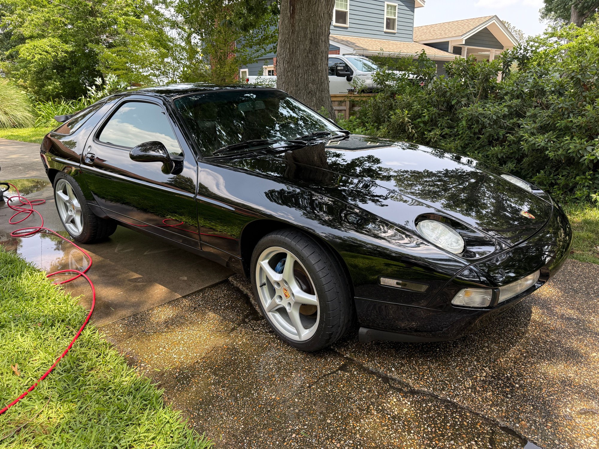

Six months or so ago I decided it was time to get a 928. I wanted an 87 or newer, automatic and already loved. I planned to drive this often and didn't want to worry about ruining a low mileage car. I found a 1988 S4 5 speed at a decent price with 181,000 miles on it here on Rennlist. I rode up to Richmond area with a friend and we drove it home. It had some issues....
When I picked it up the seller had just driven it for 'the last ride" and the idle was hunting a bit. I took it for a test drive and the steering was whacked. I thought maybe both tie rod ends were shot. Anyway, it was about what I expected and I figured the steering wouldn't be a huge issue. The first owner drove it daily in NJ/NY I think selling it around 115k maybe (I have the records but dont recall). Second and I think third owners drove it to 177k. Fourth owner, the seller, bought it around 2013 and only drove it 4k miles or so in 12 years.
I knew it needed a timing belt service and something with the steering. A good cleaning and probably some odds and ends. It had a Spectre intake on it which I planned to remove and it lacks cats and a read muffler. Id like to add one or both of those back, it's a bit too loud for what I want this car for. If anyone has a stock exhaust or something similar, please let me know. Someone replaced the radiator with an aluminum one so thats good. Many of the fuel lines and pieces have been replaced, I think the only one that hasn't is the large front one. Vacuum lines are original, I picked up a kit from Roger. It has a short shifter as well.
So where are we now? Work completed; timing belt, water pump, oil pump seals, oil pan seals, front crank seal, cam seals, valve cover gaskets, valve cover plate upgrade, Porken tensioner, fixed the alternator fresh air tubing, radiator mounts, rotors, caps, wires, plugs, fuel filter, brake flush change transaxle fluid, power steering fluid and of course oil and coolant.
So where am I now?
Last night I cranked it over for the first time since everything but the fuel filter was done and it fired up after about 3 turns. Great! Went to bed dreaming of a nice test drive this morning. Well that didn't happen.
This am I went for a test drive and the first 5 minutes were great! Then it started to bog down and loss of power. The engine took a deeper note, huge loss of power and did not want to stay running. Turned around and limped home. Power would return randomly for half to 3 seconds and then loss of power again.
Opened the hood and grey/blue smoke came from the backside of the engine compartment. Im not sure what that was but it went away. Maybe the timing is off? I brought it back into the garage and checked the timing. Timing was advanced on both cylinders. I reset to 0/0 hot. Dropped one of the screws for the Porken tool and sounded like it went into the timing belt cover. $#%^@# Looked for a bit, stuck a magnet down into the cover, no luck. Looked all over teh floor, in all the apparent places it could fall and get trapped, nothing. It must be in the timing cover. Lunch time. Made burgers and sausages. Mmmm.
Back to work, have to take all of the front off to get that damn bolt. Started to pull the fans and radiator and then decided I might be able to get this done without pulling all of that and dumping fresh fluids. Got the car in the air and slid under to start working. Decided to take another look for that bolt and FOUND IT! It had fallen between the alternator and the vent tubing. It took my 10 minutes but I got it out. Buttoned it back up from the timing reset and out for another test drive.
Better but not right. Power felt better initially but as it warmed up the same problem came up. Headed home again. Figured one of the coils wasn't firing properly so took the IR thermometer and checked all cylinders. Same temp more or less everywhere. Unplugged coil on passenger side and started the car, ran like it did while on the test drive. Unplugged the coil on drivers side, same thing. At this point it seems like it's got to be a fuel issue. I had not changed the fuel filter yet so went ahead and did that. Off for another test drive. Didn't get far, same issue.
I sent a DM to Mrmerlin and he suggested the temp2 sensor or connector court be bad or the MAF. I did a quick search and it appears that if you disconnect the sensor, the brains decided to use a preset based on duration of running rather than using the sensor. This can lead to hard starts and poor running when cold. But my engine was hot already so we are good to go! Went for another test drive. Near success! Longest run yet with fewest issues but, the same issue is still occurring just at a reduced rate of occurrence. So I'll replace the sensor and connector just because.
Now, what am I seeing besides low power randomly inserting itself into an otherwise fun test drive?
Warning lights - Coolant, Stop Light, Belt Tensioner (this one is randomly on and yes I grounded the wire out as instructed) and the voltage gauge reads 12v.
Not sure it matters but I did oil the K&N today. I did not clean it because I didn't want to wait for it to dry so I quickly oiled it and waited 20 minutes as instructions say. I dont think I over oiled it, quick even passes using the aerosol. I have heard of K&Ns causing MAF issues if you over oil them so I was pretty careful.
So what do I change next?
