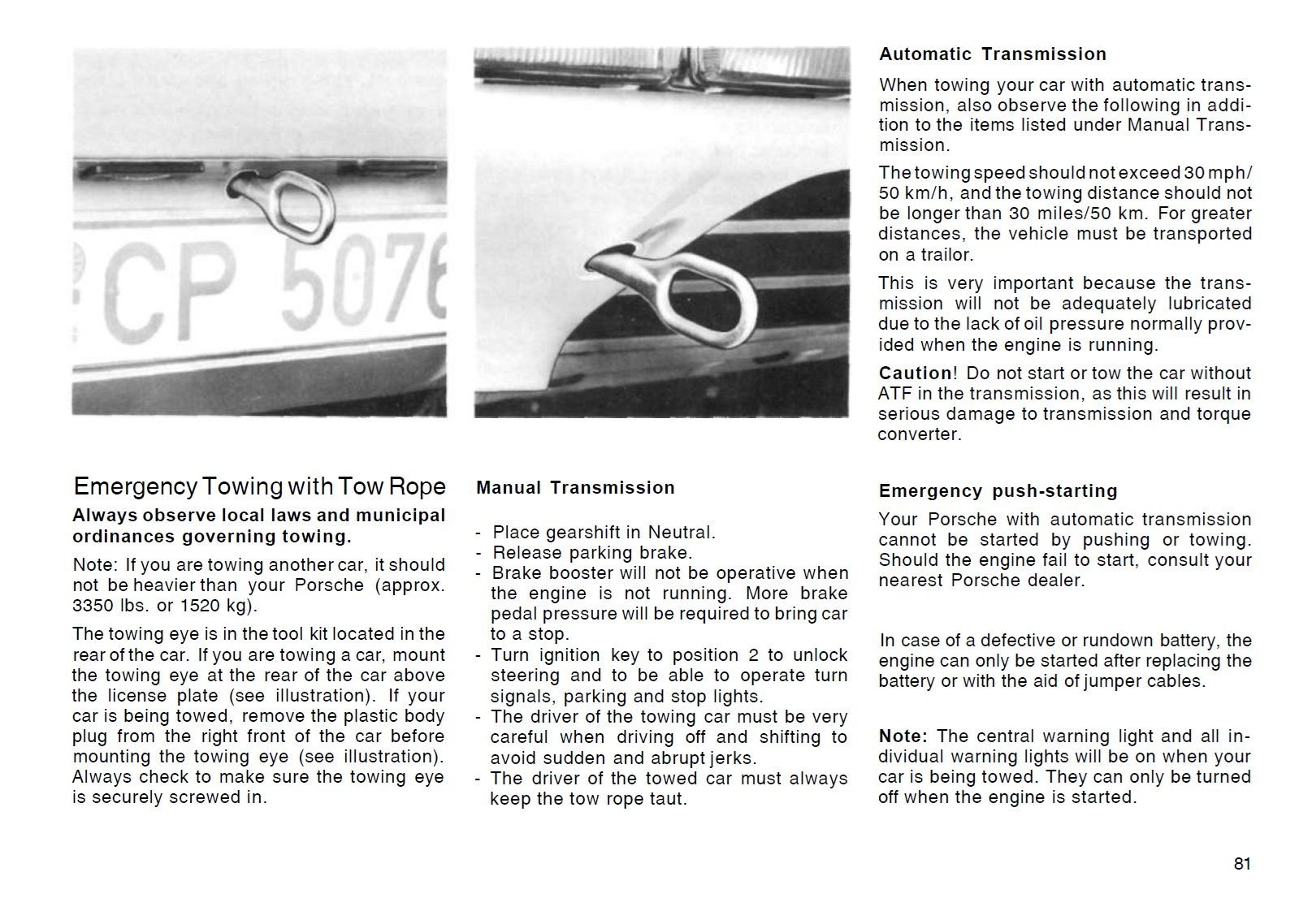

with a manual trans in neutral there should be virtually no load on the gears train.
Excerpt from the 82 owner's manual,

Thanks all! This is a 5-speed manual, so I think I would be good with a few miles on a dolly. Although I'm glad to know how to tow in an emergency, I don't think I'm ready to trust that eye-hook and someone's foot on the brakes.
