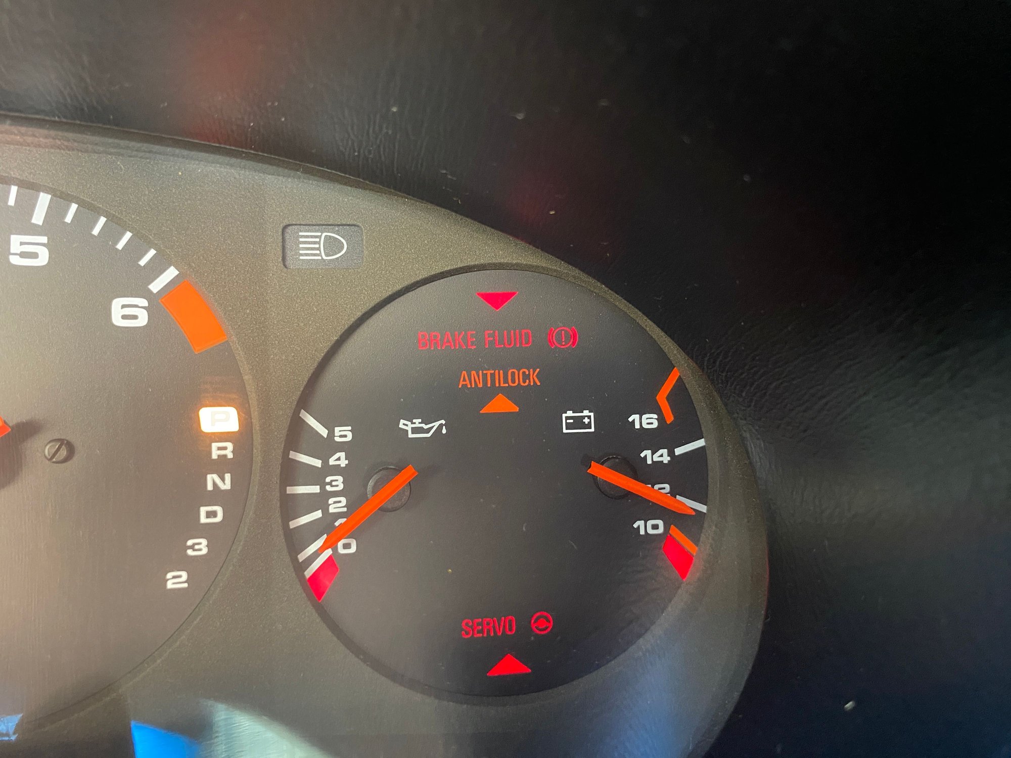

Hey all, wondering if anyone can tell me what it means when you get just a down arrow warning light without any other warning lights on a 1986.5 automatic. Happened to me once while taking a "strong" corner but then went away, again while just driving straight down the freeway. After the second time I was getting ready to do an intake refresh so I just parked it and forgot about it. Now that I finished the refresh, I took it for a test drive, and it came back while driving at about 35mph. I initially thought maybe a light was out but tested my dash lights and they all seem to be working.
Sorry if this has been covered, I promise I've been searching and can't seem to find anything on the subject.
Dash light while driving
Testing dash lights

based on your picture the brake fluid is low.
That said best info is in your owners manual.

Thanks @Mrmerlin I thought the same thing at first and checked the fluid level and it was full, I also would have thought the actual brake fluid level light would have come on.
Also, my owner's manual doesn't match my dash light cluster. It shows an antilock/ABS where my top arrow is, and my car has ABS but no dash light for it. Maybe an ABS issue?

I wonder if someone swapped out the right gauge cluster (oil press. and volts) with a gauge from a 944. I believe the 944 on some years had the SERVO light associated with the power steering.
example of a 944 instrument cluster, though admittedly is doesn't have the SERVO light illuminated

I was noticing that the only example I could find that matched mine was a 944. And... now that I'm thinking about it the servo light comes on when my parking brake is on.
I'm guessing it is an ABS warning and I need to get the correct gauge back in.

It looks like your pod may have been swapped to a different set of gauges from another model like a 944,
the 928 doesnt have the arrow heads at the warning lights.
Disconnect the battery and remove the pod then remove the gauges.
Look for a part number sticker on the gauges that will tell you what they are for.
NOTE I have never seen this done before putting in a set of 944 gauges into a 928,
it doesn`t mean it won`t work .
