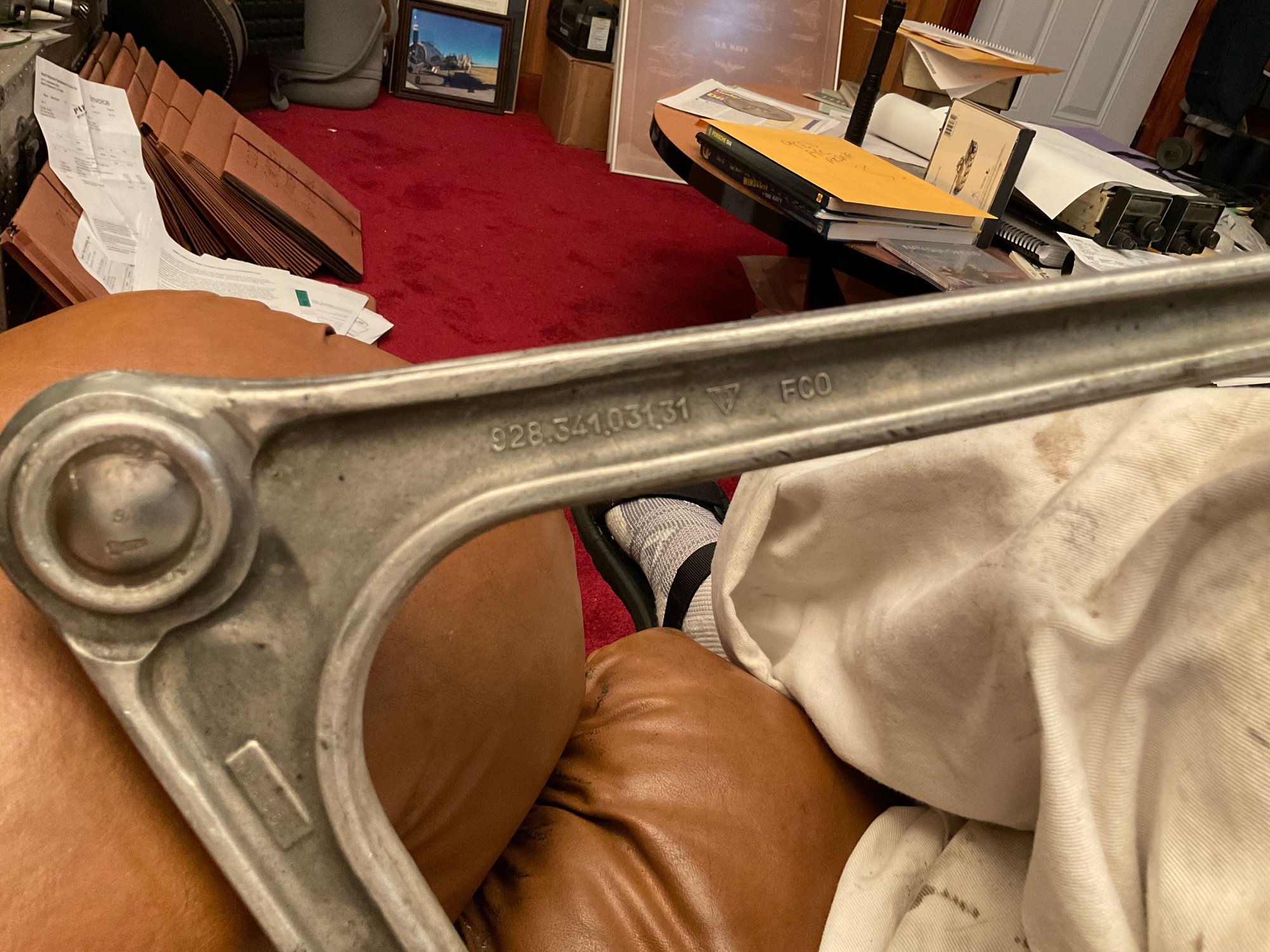

1987 five speed, replaced both lower ball joints noted the upper ball joint on the left was very lose, but a PO had a good used one in the box of parts 5hat came with the car. So I used it and now the front left tire has very positive camber! Note the arm had his spacers on each bolt and I used them putting on the arm. I am suppose to get a full front end alignment in 5he mourning. But I thought I would take the old one along, but checking the parts diagram for my year it shows a different part number? 92834102737 is what the parts book says. This is the one that came off my car.
Just removed with a worn out ball joint.
putting the number in a web search shows GTS?

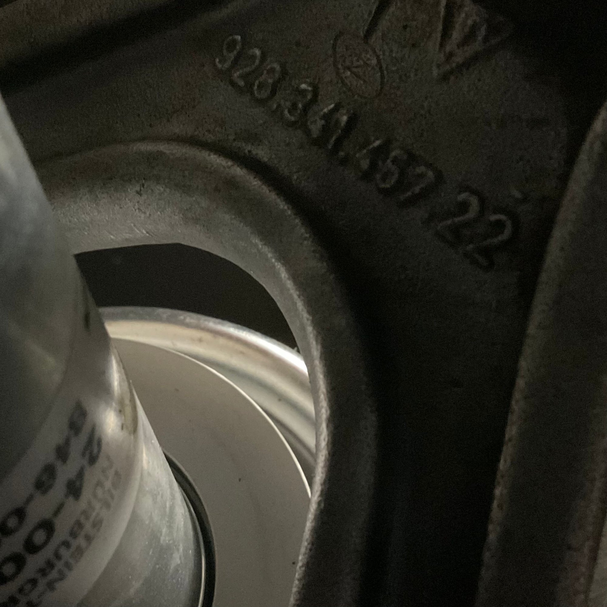

Pulled the tire, got under the an arm got this number!
Different number than parts book?

With a web search it looks like the number for a Porsche rebuilt arm?

I believe you installed an early arm which has a different length
