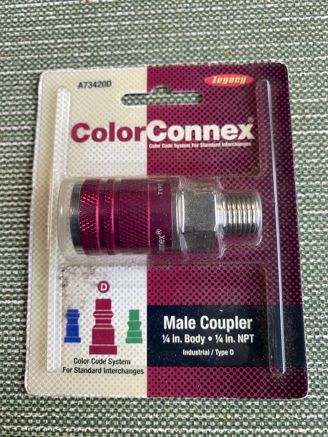

The return line from the ATF cooler has on the right hand side of the tranny, a filling device. This has a cap over it that has to be removed and then there is a quick fit connector that should be used to transfer ATF from a filling device. I canot rfemember the name for this type of connector but it is also easy enough to slip a piece of hose over it. I used a 10 litre pressurised garden spray bottle to transfer ATF via this connection. When adding ATF I know the cold amount my tranny needs, I simply add that amount and then run the motor for 5 minutes or so to warm up the ATF and then check the fully warmed level mark.

“ I can not remember the name for this type of connector but it is also easy enough to slip a piece of hose over it.”

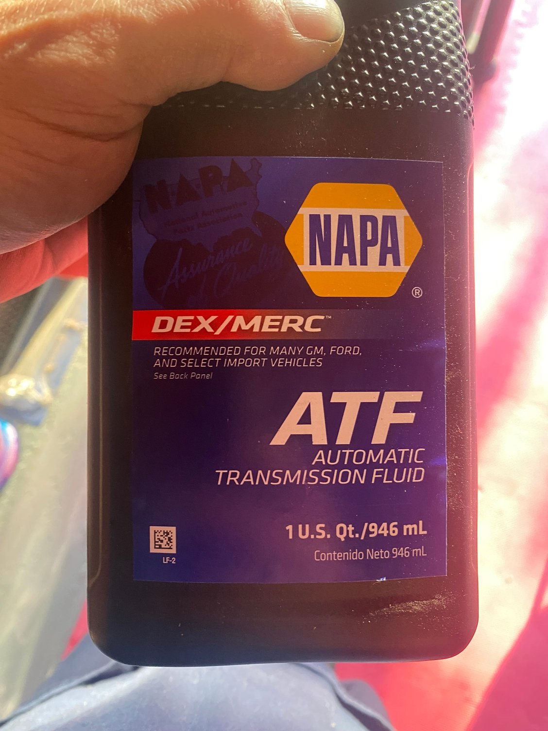

Not familiar with that trans fluid-
It’s listed as Dextron II
I have always used Dextron III

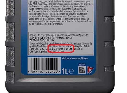

Old May 30, 2024 | 10:43 AM
NoVector's Avatar
NoVector
Joined: Oct 2004
Posts: 2,942
Likes: 363
From: K-town, Germany
Thanks for posting the picture of the Mobil ATF 220, I didn't know they made a Dexron II D formula. I try to use original manufacturer recommended stuff rather than the new and improved "one formula works for all" stuff. Mobil ATF 220 seems perfect.
