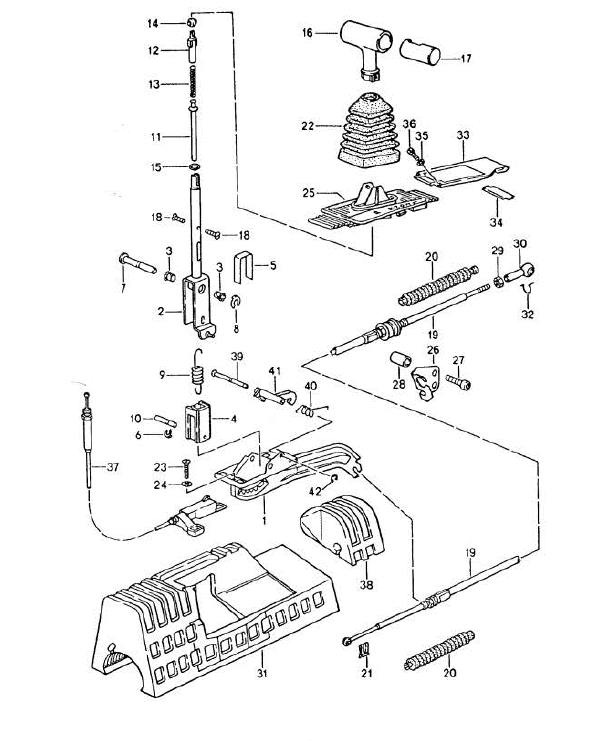

I think Stan is referring to part #37 (shift lockout cable, 928 426 013 00), which is GTS only. Didn't know this existed, I don't have the faintest idea where the anterior end goes but it looks like the switch mounts on the shifter frame.
Old Apr 3, 2024 | 02:20 PM
NoVector's Avatar
NoVector
Joined: Oct 2004
Posts: 2,942
Likes: 363
From: K-town, Germany
I don't recall seeing anything like that either(?) At least not on the bottom veiw.

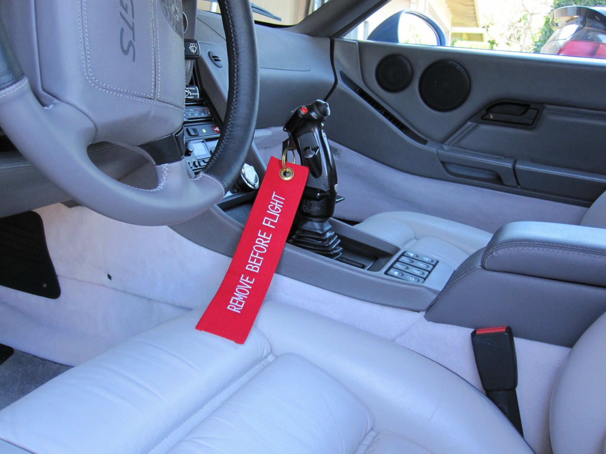

Old Apr 3, 2024 | 06:22 PM
AJTONY's Avatar
AJTONY
Joined: Dec 2023
Posts: 12
Likes: 14
From: San Jose CA.
Shows switch location and the shift lever.
Old Apr 3, 2024 | 07:11 PM
Rob Edwards's Avatar
Rob Edwards
Archive Gatekeeper
Joined: Sep 2002
Posts: 18,761
Likes: 3,930
From: Irvine, CA
How do you engage lower gears and Park with that joystick thing, and could it be part of your issue?
Old Apr 3, 2024 | 08:08 PM
AJTONY's Avatar
AJTONY
Joined: Dec 2023
Posts: 12
Likes: 14
From: San Jose CA.
The F104 control lever works just fine! One has to push in the black button in the middle of the control lever ( rocket fire switch) in order to move . I modified the control unit to function in all positions.
The unit has been working for 20 years!
