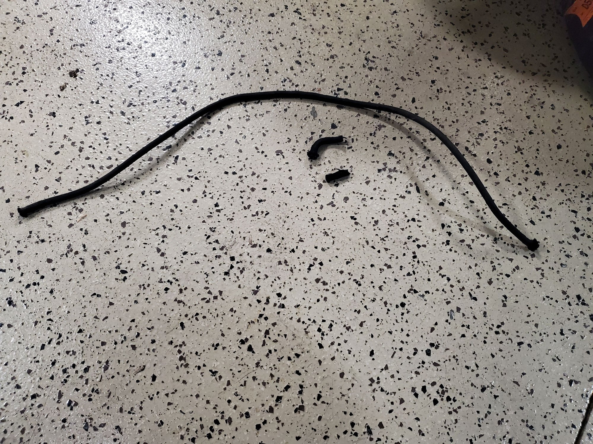

Having owned my '84 Euro S twin-dizzy 16v auto 928 for 2 years now, today I replaced both flexible vacuum hoses for the auto transmission, and can't believe how smoothly these cars can shift.
Mine was always a little abrupt and clunky and just thought it was the way they were, but after noticing it was a little worse recently, I did a little research and decided to check the flexible vacuum lines that connect the hard lines together and to the trans itself.

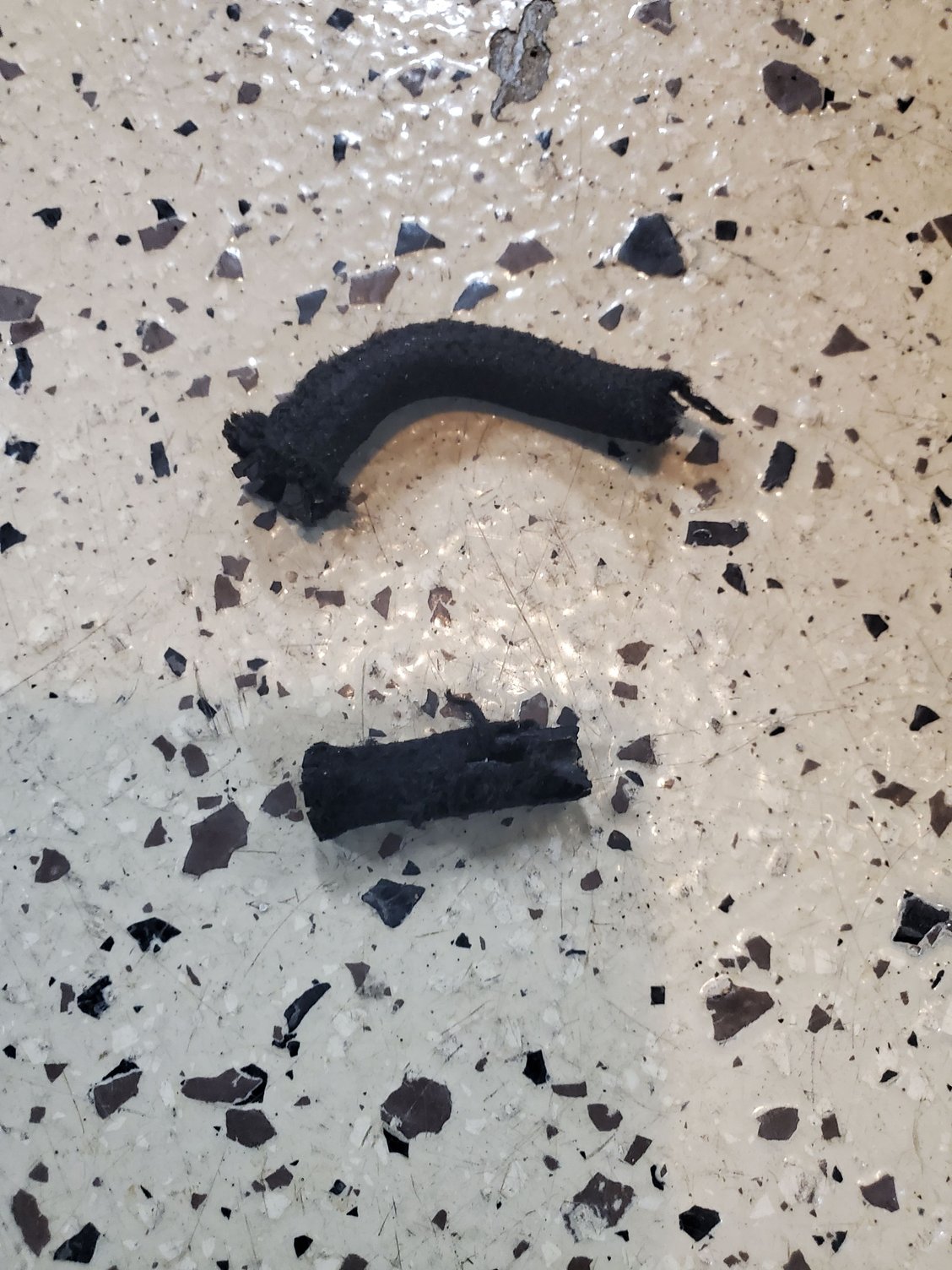

Well, the front one cracked in half when I touched it and the rear one slid off the port with hardly any force applied.
I was able to replace both just by jacking up one side of the car using a lift at and a jack-rod.onnmy jack. I achieved enough access just by removing the heat shields and the cross bracws that they attach to and using a long 90 degeee needle nose pliers to work the silicone vacuum hoses onto the metal hose ends.
The shifts were.most abrupt at light throttle and slow speed so I drove it around the neighborhood and couldn't believe the difference. I'll do a more extensive test drive on the open road soon, but expect it will be great.
Front one shown in 2 pieces & rear one is the long one that goes up over the transmission.
Front hose came off like this once touched.
