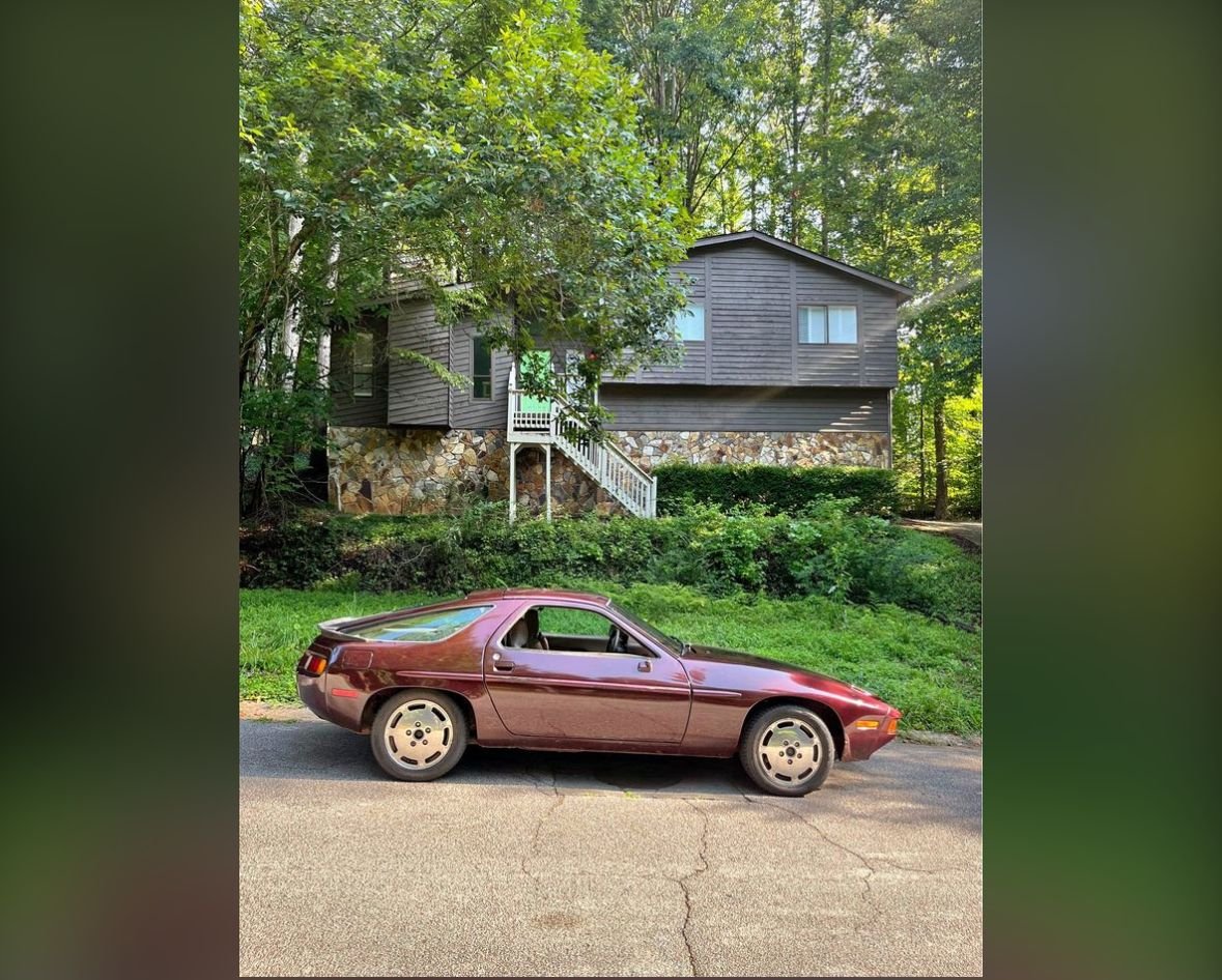

Looking at a 1983 928s and was wondering if this is even worth a meet up and I’m not wasting my time. The description of the condition below
“1983 Porsche 928S
10K OBO
Runs, drives, stops
New tires, recently polished wheels. Car runs excellent and has no issues with drivetrain. Drive it home! This car could drive anywhere without issue. Porsche 4.7L V8 with a 4spd automatic transmission, amazing highway car. True Mileage Unknown, a common issue with 928s.
Color is ruby red metallic, has a two tone brown/tan interior. Power drivers seat, manual passenger seat. Excellent power, new belt set, pulley set, green wire, rebuilt axles, and much more. Very reliable, easily a daily driver.”
The interior needs a lot of work and this is before I can even bring it to a specialist to get a second opinion. Just want some opinions before I get into the thick of it.

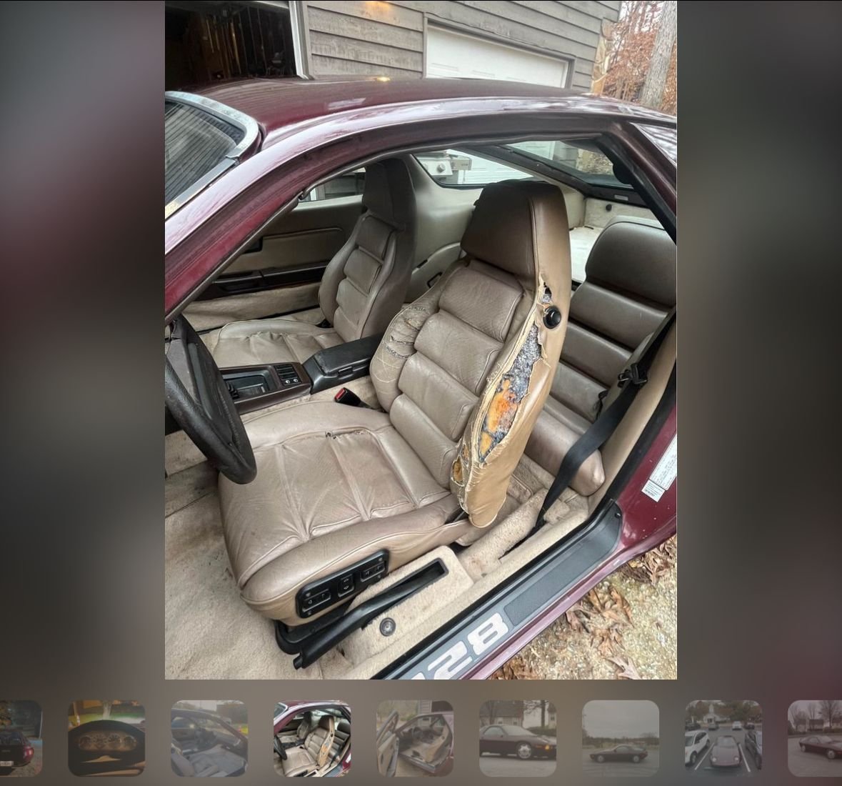

The interior is standard condition for many 928s. The dash is cracked and the front seats need to be reconditioned. Mine looks way better but still needs the same items so it will cost me the same. I would take a good look at paint and body for that price.

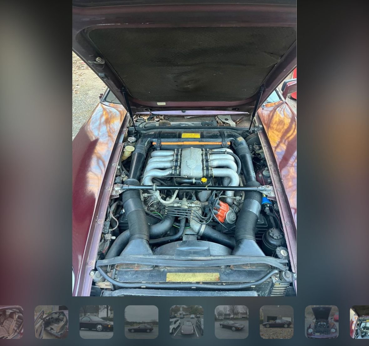

It’s got the early L Jetronic system which isn’t bad but I think the LH version is much better.

If the paint is presentable, that will save you a lot of money. The int will cost a lot to get it up to snuff - $2-4K depending how handy you are and how good you want to make it. Owner claims it's a daily driver but chances are it needs the normal maint of timing belt / water pump, fuel and pwr strg lines, and maybe an intake refresh. Parts are $1-2K. If you're handy these are doable DIY jobs but will cost you sev thousands if you hire it done.

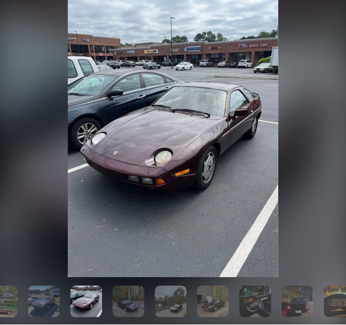

Sharks had a long production run - 78-95. There are bundles of yrs that fall into similar categories - the OBs (78-80), GTS (93-95), S4s, etc. The 81-84s tend to fall into the least desired / least valuable group, esp if they're an automatic. That doesn't mean they aren't cool or fun or worthless, it means there's a shark hierarchy and these are towards the bottom. A decent 83 in today's lower mkt is prob around $15K, and by decent I mean the paint & int are presentable, maint is current, and it drives well. This one barely checks 1 of these boxes. Honestly, with the cost of all the work needed just to make it presentable, not concours, it's prob not worth more than $5-6K and that's being generous.
It depends on where you live but I think the interior is way more than $2K to $4K. More like $10K -$12K. You can buy a nice 928 with a good interior for $20K. And then what else is wrong with this car?

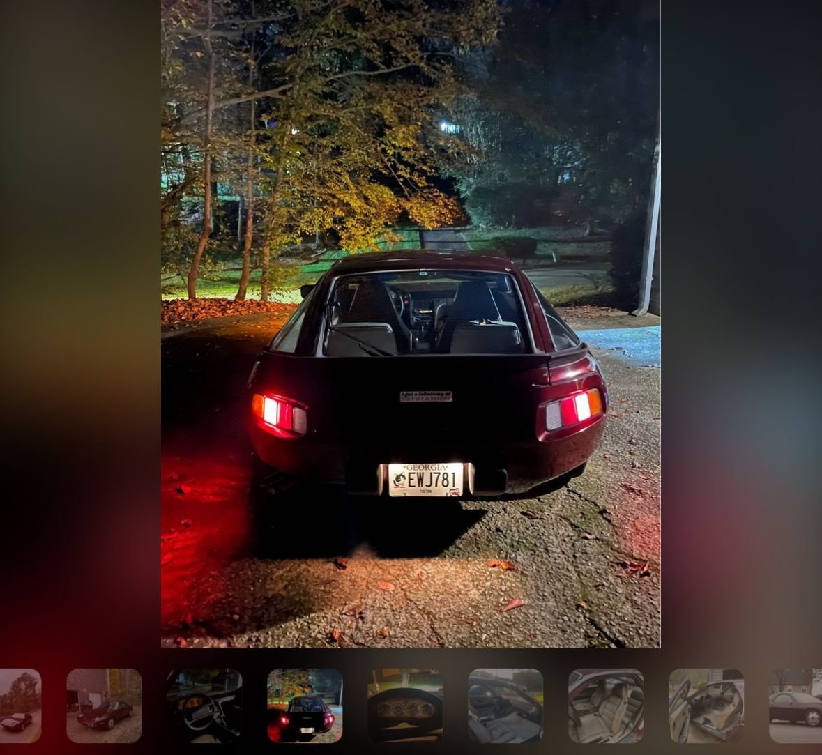

From what I see in the engine bay pics, I'm not sure things are mechanically as solid as the owner states. Wires near the 14 pin look old and crunchy and I'm also concerned about the paint. The distance photos make it look nice and shiny but in the last picture with the hood open the paint on the top side of the fenders looks like it has linear scratches in it and has an odd sheen to it.

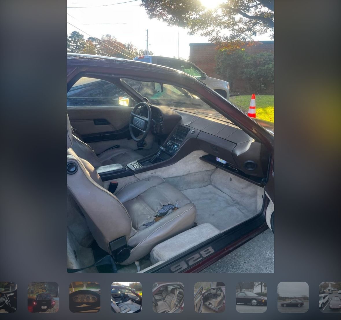

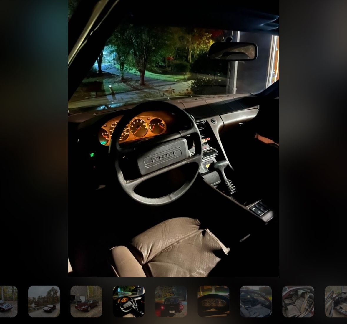

Definitely needs new front seats, rears don't look bad unless they're crunchy and are going to crack when someone sits in them. Dash if obviously bad, but a Dash Designs DashTex dash mat will eliminate the eye-sore so you can drive it while you work on it without having to look at that stuff.
