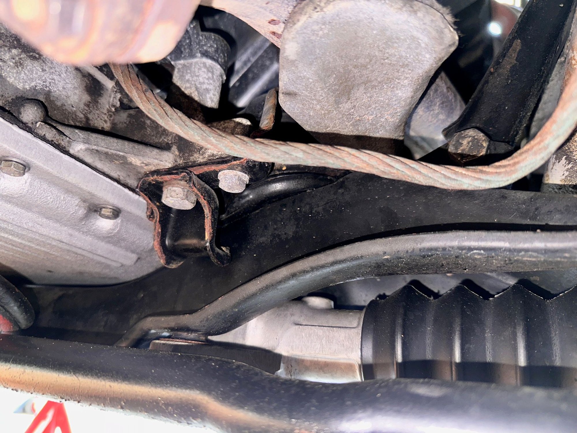

I was under my car last week and noticed the "hook" of my engine mount to be pretty low.
Is it time to replace the mounts?

Absolutely yes!
And take a look at transmission mounts too!

Pete in that picture you should untie the slave cylinder hose from the sway bar .
NOTE as the bar is moving whenever the suspension moves, as well as the engine moves when ever its running
this will reduce the life of the hose, as it will be forced to be flexing constantly.
NOTE also move the battery cables away from the swaybar for the same reasons,
as the insulation can wear through and short out the system.

Thanks Stan. Will do.
