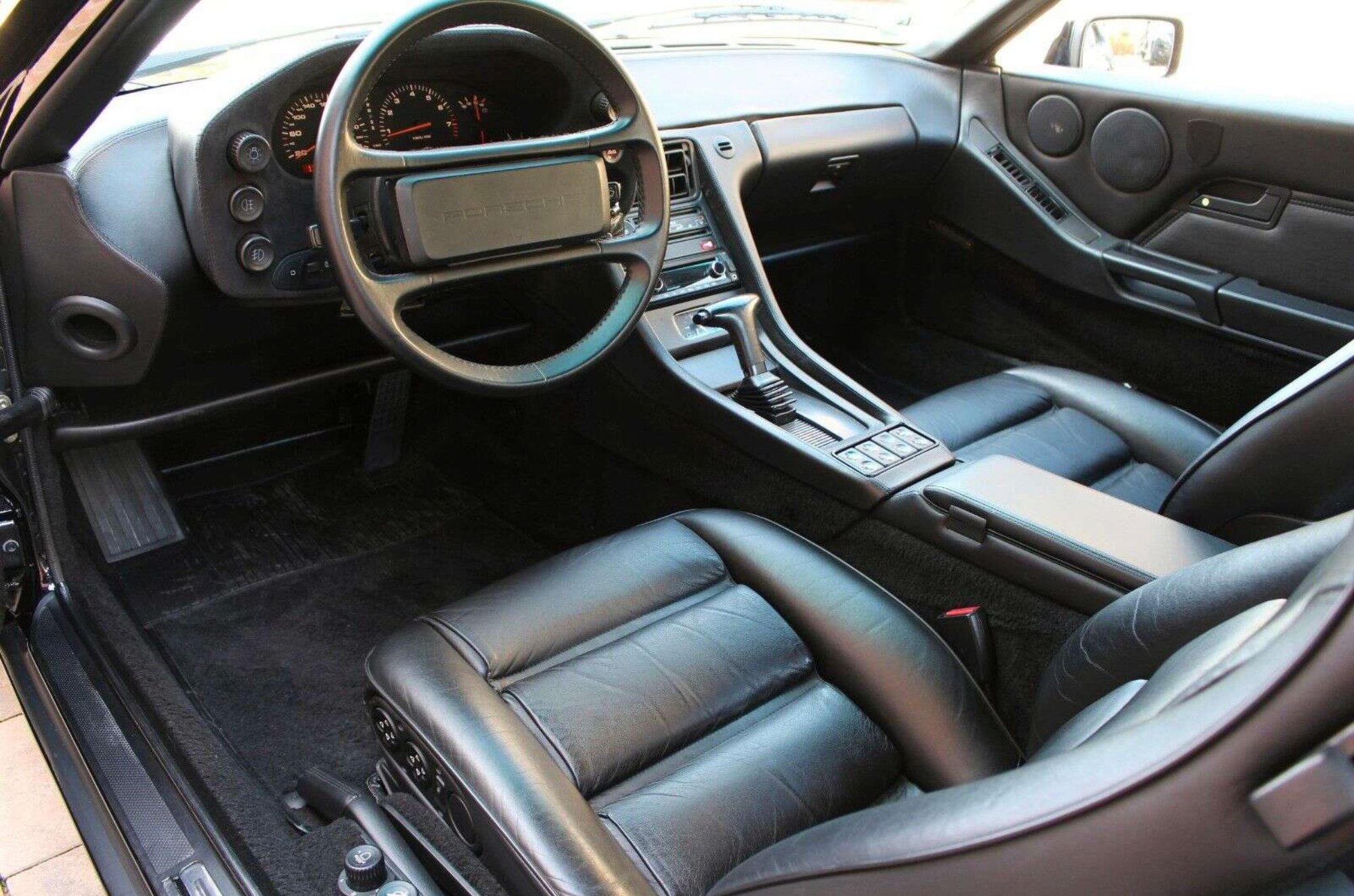

Rob,
here is an example of a 1991 RoW interior with no airbag as a reference of my plan for the car.
