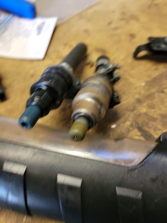

An update...
I changed out 4 of the injectors to the best looking old ones (I haven't tested/cleaned the old ones).
Fired right up! Still running rough. Here is a picture of the existing and the new one(s). They ends look quite different and I'm curious if these are somehow the wrong injectors for my car. Roger is always on top of it, so I maybe sent the wrong info?
Thanks

Call Roger?

Either email me or let me know your name please?

Thanks. That was my next step. Roger, I'll shoot you an email.
