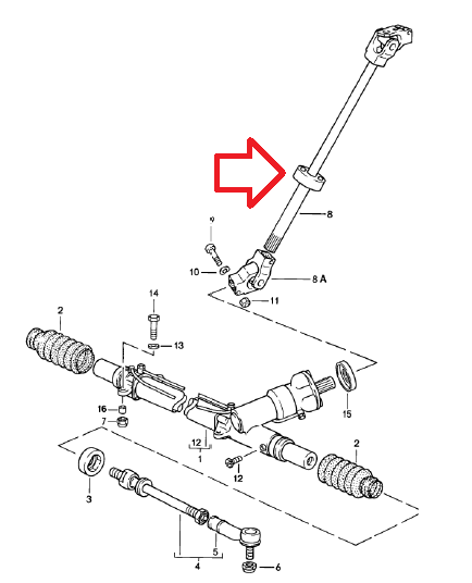

Originally Posted by GregBBRD
Or at the rubber coupler, which will probably need to be replaced also, if the column bearings are bad.
Rubber coupler? Is that this part?
Yup, if you can get to it.
Hmm, Getting to it shouldn't be an issue if I'm separating it from the bottom universal joint near the rack, I just don't see a part number for it.
8A

Sorry for my ignorance, but 8A is listed as the lower universal joint, not a rubber coupler. Unless that's where you suggesting that's where I disconnect the shaft, which is the plan. I'll check it for play regardless when I remove it. Thanks.
Oh ya..when you said "universal joint" thats where I went.
I dont know what year you have, but call Roger at 928srus.com. He will have the one for you.
