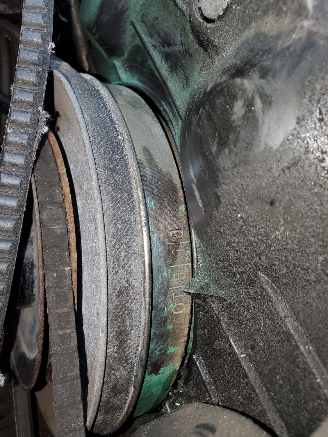

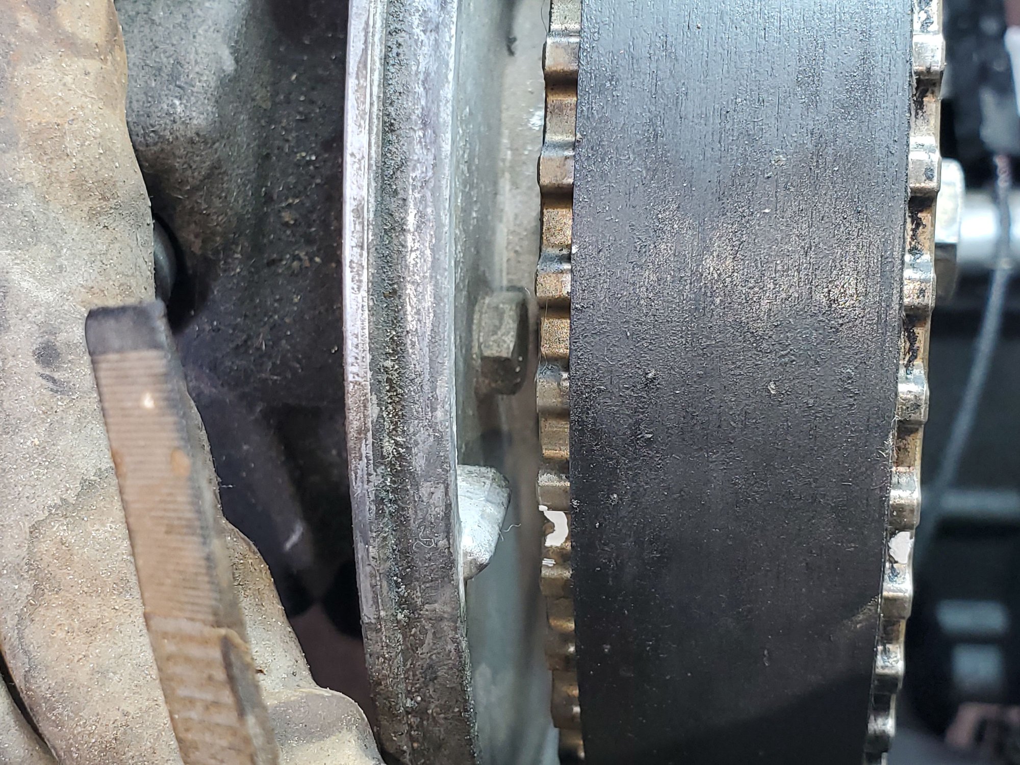

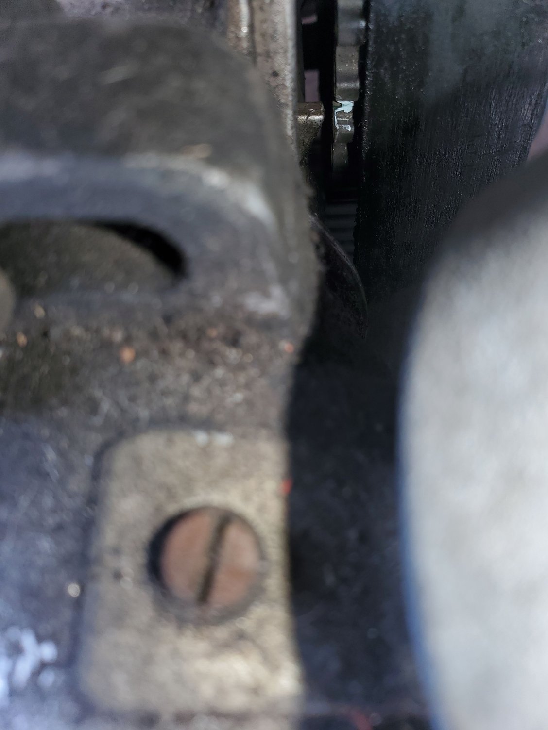

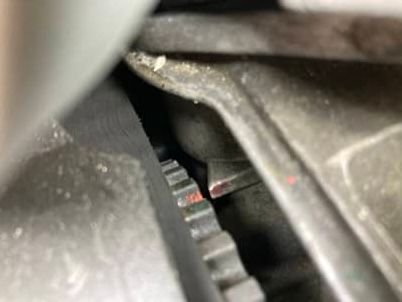

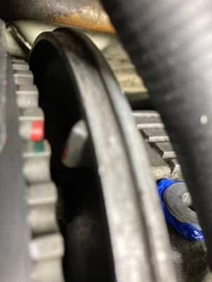

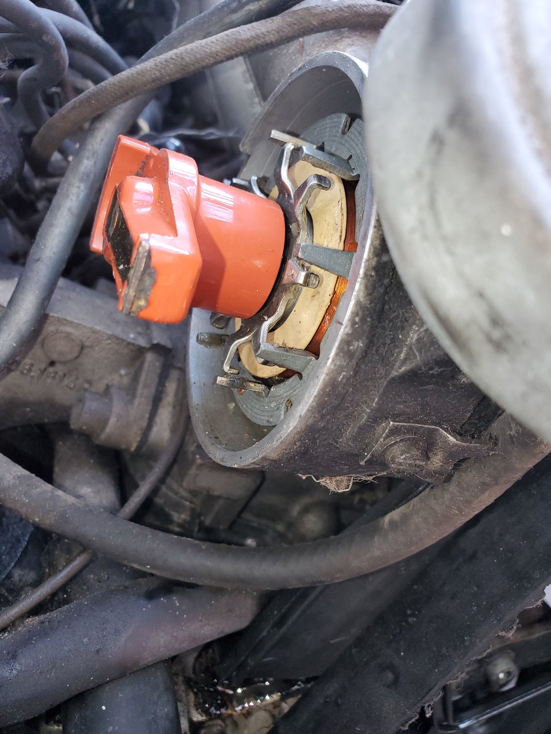

Last fall I decided to get it running (it has been sitting for about 10 years). I cleaned the fuel system back to front. The tank was bone dry. I replaced the seized fuel pump, replaced the filter, and had the injectors cleaned and flow tested. I also ran some sea foam through the fuel lines while I had the system open. I was able to get it running but it ran like crap. It barely had enough power to move around the driveway on its own and had a terrible miss. I replaced the plugs and checked all the wires. The wires checked fine. Still it had a bad miss.

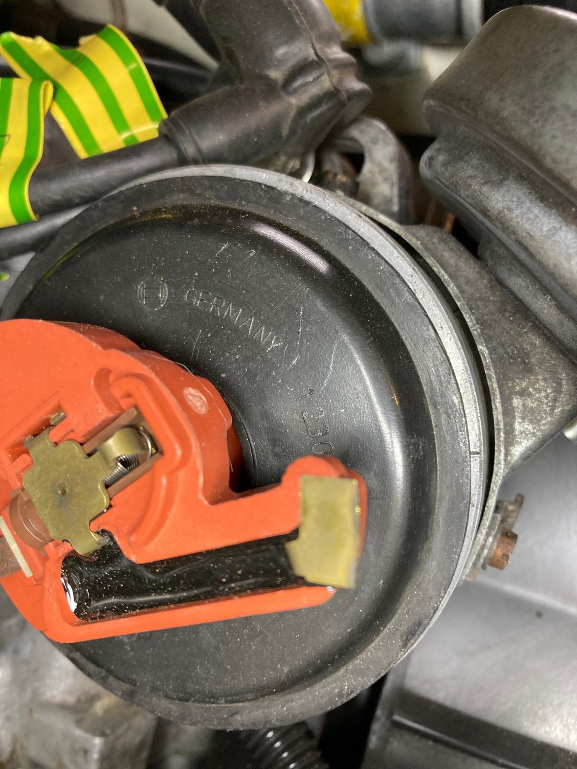

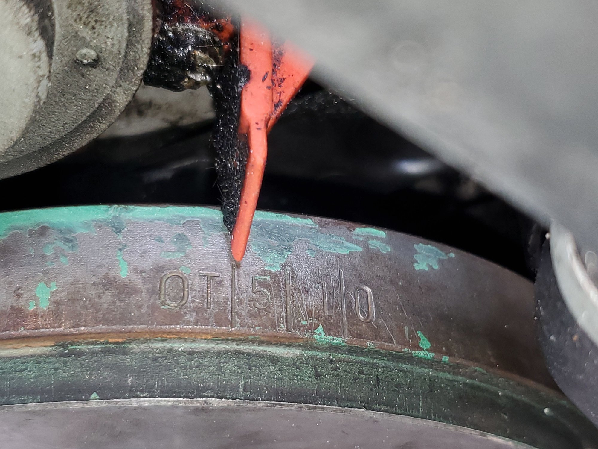

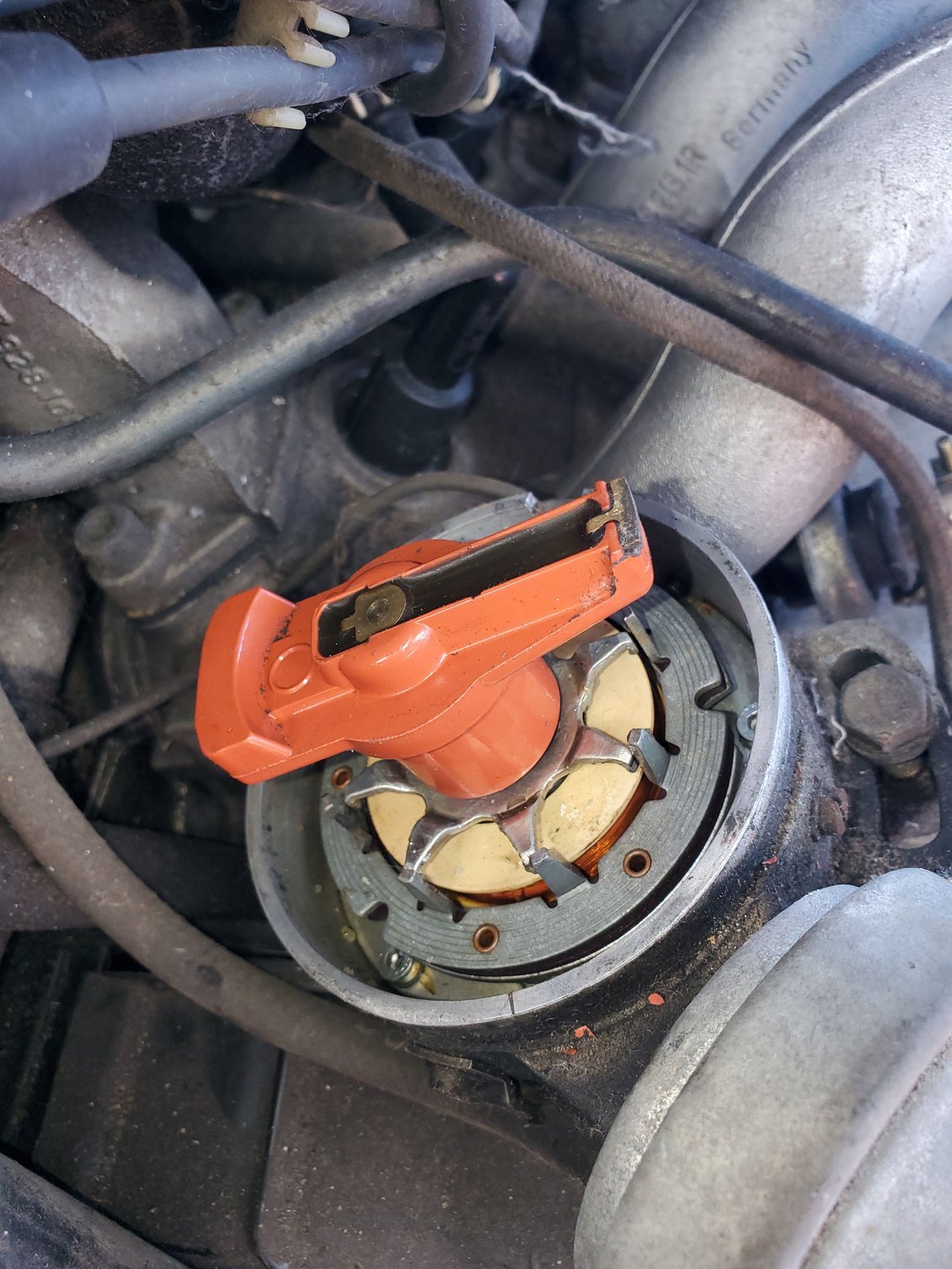

I decided to get back on it today and believe I've found the issue but wanted to check with folks that have more 16v knowledge than I have. I believe the timing belt has jumped multiple teeth from what I can see today. I believe I have the crankshaft at TDC. It seems to be marked as 0T| on this car (I'm used to 0|T on my '86). The pictures below show the position I have the crank at and the position of the rotor. From the pictures do I have this at TDC? If so, it appears to me that the belt must have jumped. Also, is this damper flipped around backwards with the numbers upside down or is that a 16v thing. Let me know what you think.
Thanks,
-Ethan
I know it looks a little off in the picture, but the pointer is on the | before T0
If I'm at TDC this shows that the distributor is off about 1/4 turn correct?

Hello Ethan,
apparently damper has been set reversed on the engine. You should be able to read the numbers normally and not up side down.
Here are the settings you need to have with cams aligned and rotor correctly positioned:
all is set at TDC

Its kinda amazing how often this happens. They are never aligned or timed correctly like this, and run very poorly.

Thanks for the confirmation and information Gerrit. I'm going to flip that balancer around and then see how things are lined up.

It really is Karl. It ran pretty well when I was driving it 10 years or so ago. It seems like it would have had to have been a lot of work to try and get the cam timing close with the balancer like this. I'll remove/reinstall it correctly and wee what things look like.

The cam timing looks good now that the harmonic balancer is installed correctly. The balancer and pulleys are marked from 928 Intl. I know this car was hit in the front at some point. I'm guessing the balancer and pulleys were replaced as part of the repairs for that and the timing belt was left alone.

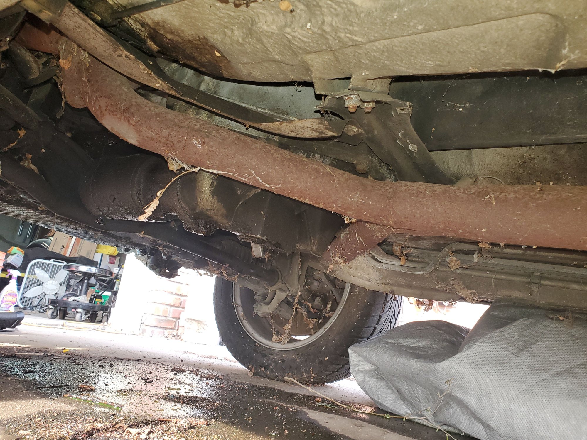

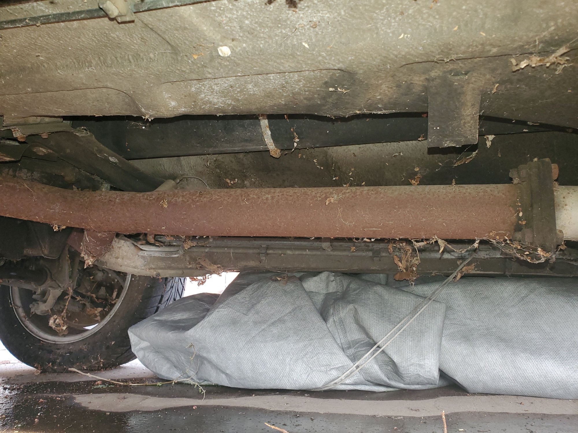

I noticed a few things while working on it today that make me wonder if it might be a ROW car. It has a factory looking tensioner for the fan belt where the smog pump would be and it appears to have a factory y-pipe with no cats and there isn't any heat shield where the cat(s) would have been. The engine is a M28 14 which seems right for a '80 auto US spec. What do you folks think?

1980 928s never had a smog pump, US or ROW. As for the Y pipe, it is definitely aftermarket. The ROW cars offered without a cat had a massive muffler in that area.

Thanks for clearing that up for me Blake. I'm guessing there would have originally been a cat in place of the Y pipe since it's a US spec car.
