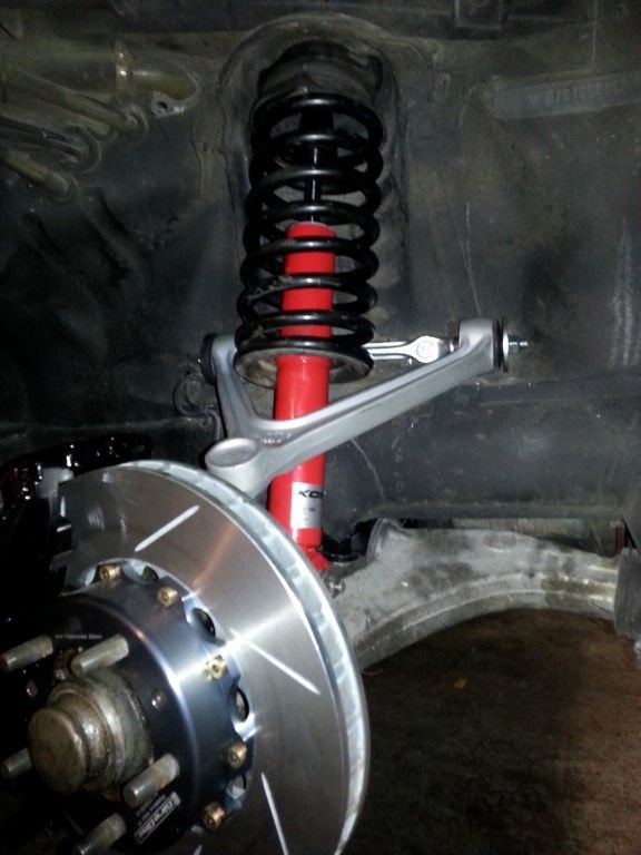

I used caliper adapters and fitted GTS calipers and 993TT rotors on my 79 - no other changes to uprights or anything else.

Petza, I bet that's a bit of an upgrade in stopping power? Looks like an easy switch, easy to undo as well if desired, later...
Cheers
Yep, and I needed it one day on the way to Sharks in the Mountains when a guy coming the other way either didn't see us or accurate assess my speed and our closing distance. He decided he had enough space to pass the car that was in front of him, which he didn't. Was able to just about come to a complete stop from 85 or 90 mph where he had just enough space to get back into his lane before slamming into us head on.
My son looked over and said "glad you upgraded those brakes". Me too buddy.
