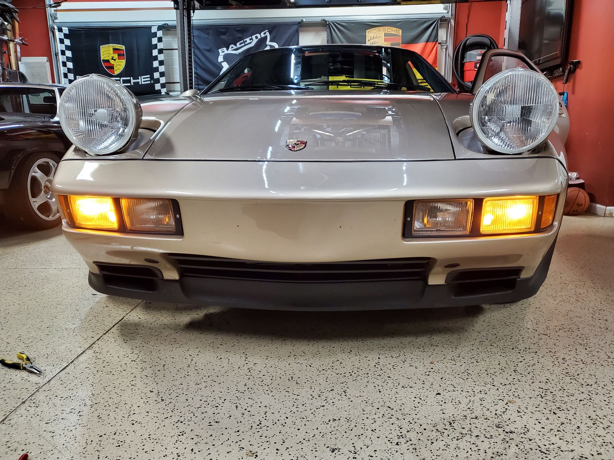

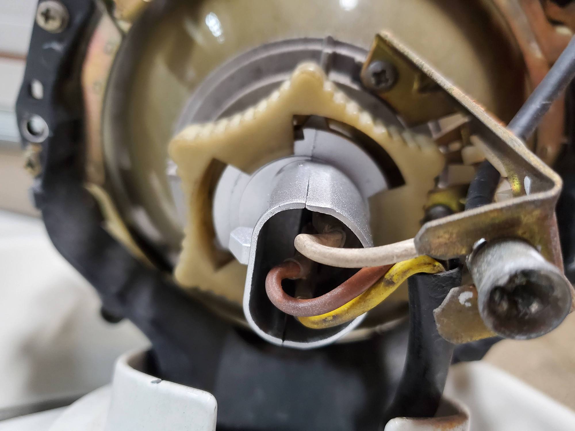

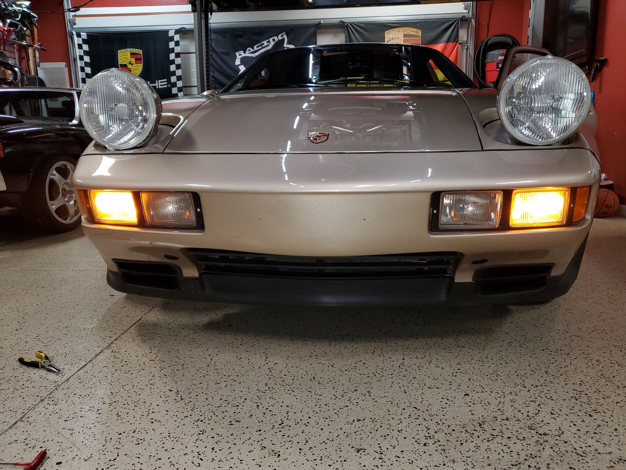

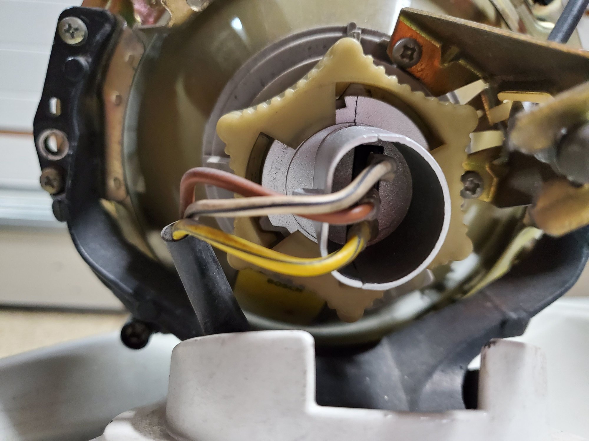

I did all LEDs in my 81 Euro S including the headlights (H4 housings) and the lighting was fantastic.
Here's a picture of an 80W (not 55W or 60W) brand new Hella Halogen on the right, compared to the new LED on the left. Ignore the heights of the beams as this was pre-adjistment.
Both LEDs installed and adjusted
Left side - Make sure you have the wires going to the correct bulb terminals, especially if your car doesn't have the headlight plug any longer like mine didn't. If the wires are crossed up, the low and high beams won't work correctly and you'll see the high beam dash indicator glow all the time
Right side

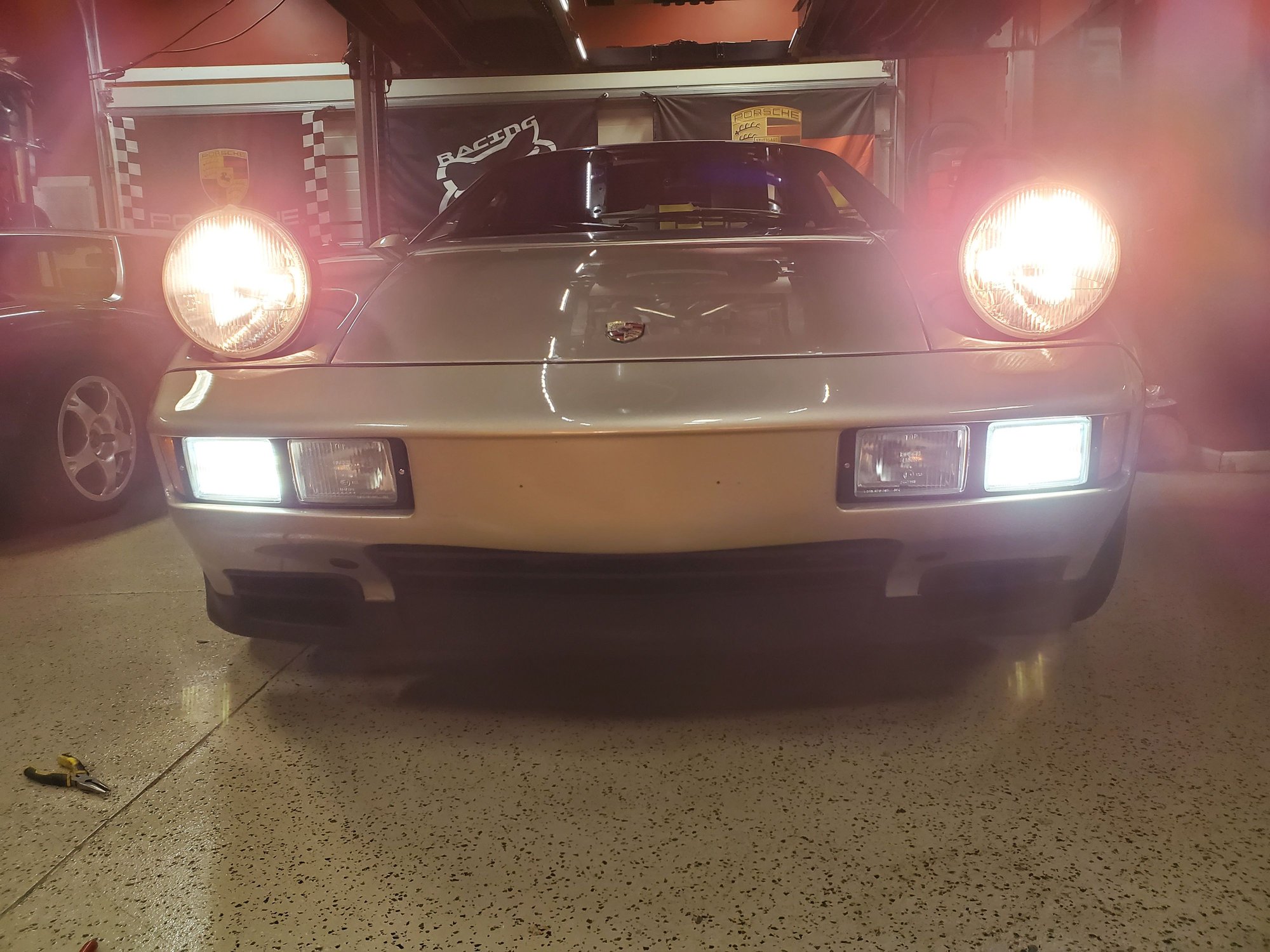

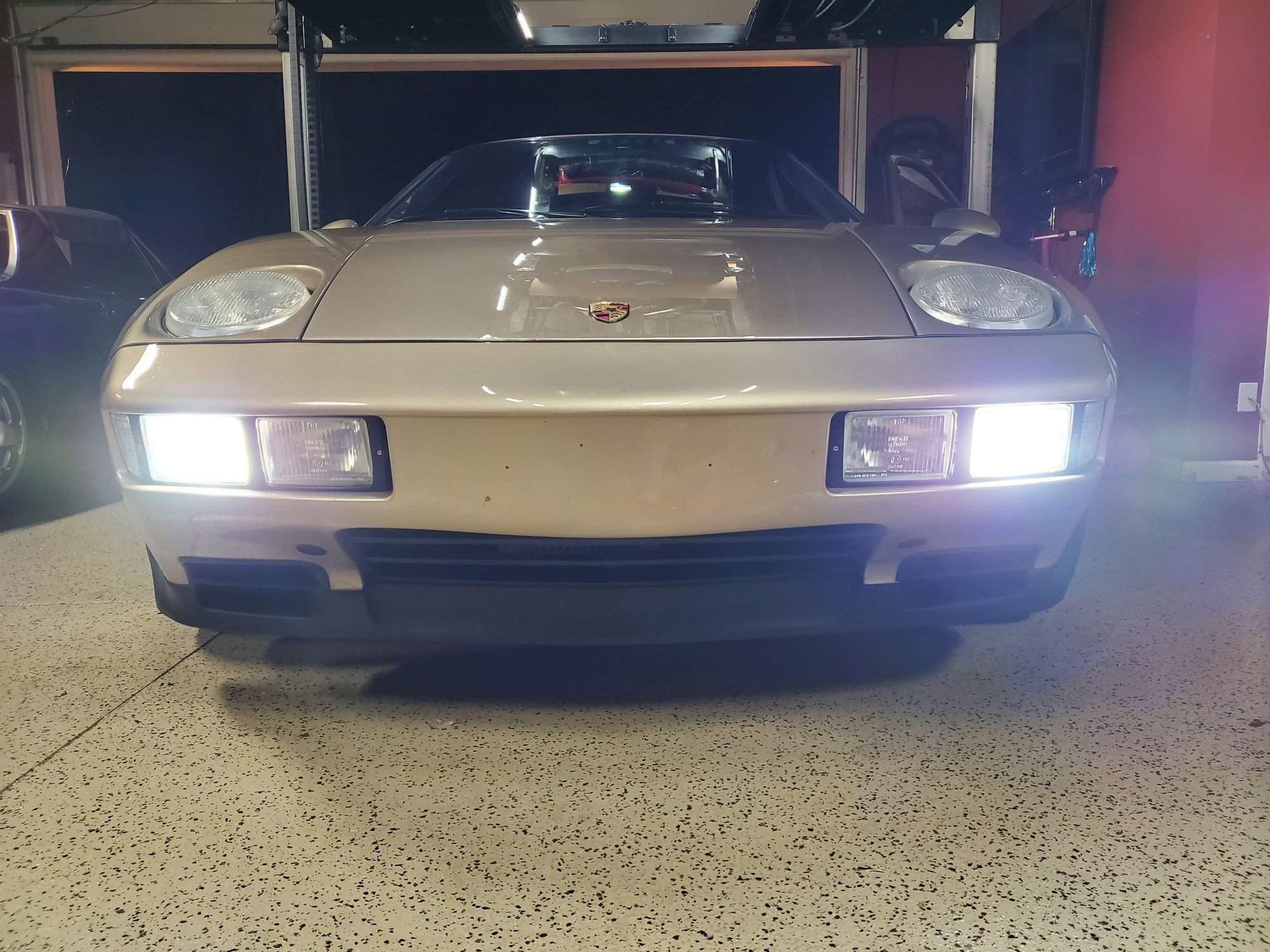

Was going to do the same thing on my 84 Euro S, but discovered the PO installed an HID kit into the H4 housings and the light output is excellent, so didn't change them on this car, but I did do the H3 LEDs in the bumper lights (fog and aux hi-beams), same as on the 81.
Running all clear lenses in this one too that I think cleans up the look of the car
Amber LEDs in the Euro fog light housings. In the Euros the corner lamps are single filament for the turn signals only and the marker lights are an extra bulb inside the fog light housing
When fog lights are on they essentially override the amber parking light so all the projected light is white
Marker lights with headlights up
Fog Lights on with headlights up
Fog Lights with HID headlights on. Whenever I need new HID headlight bulbs I'll get s color temperature that better matches the bumper lights
Fog Lights, aux hi-beams, and HID hi-beams all illuminated
