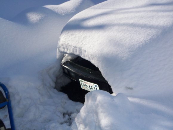

Snow load here resulted in no warping - I'll go with hatch shocks or an obstruction under the hood.
