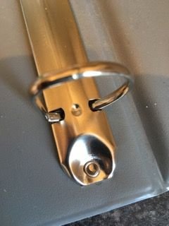

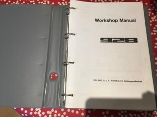

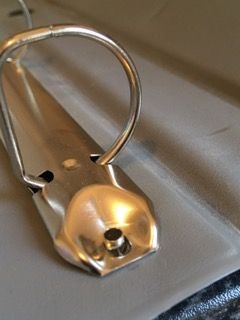

I bought my set well over ten years ago, when people didn't seem very interested in the 928, and I only paid less than $100 equivalent for a set which was unused. Unfortunately the seller had kept the manuals stored flat in a box, so most of the 4-ring binders had distorted so that pages were difficult to turn, and there was risk of tearing to the holes. Some of the rings were in considerably worse state than this, with a big gap between the jaws.
Easiest thing would be to buy another set of grey empty binders, but I could never find any with the right pockets on spine to carry the labels. Yes I could have copied/printed them and fudged a solution, but I like original!

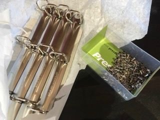

Lockdown creates time for all sorts of projects. I bought some 4-ring A4 binding strips identical in dimensions to originals (80mm between rings, 25mm D-ring size), a box of 6mm binding rivets, and a hand rivet setting tool to match.

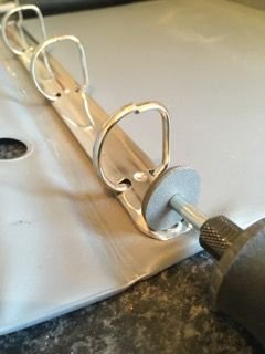

I took each volume, emptied the pages, and used a Dremel to grind down the rivets that hold in the metal binding strip.

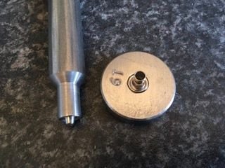

I could then punch out the old rivets with a suitably sized punch and hammer. Next you insert new rivets, locate the new binding strip over the rivets, and use the rivet setting tool to install the rivets. The original rivets are 6mm too, so the new ones fit nice and tightly into the holes in the binder cover. The tool is very nice — it uses a 'male' part shaped for the hollow rivet hole, and a tiny 'anvil' in which the head of the rivet sits. In practice that anvil is sitting on the other side of the folder right hand side, while you set the rivets on the inner side.
