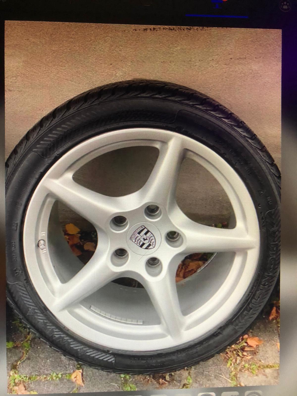

Trying to put this wheels on a 1988 S4 Euro ...does anyone has it on or know if fits ? Front 8Jx18H2 ET 57 997.362.136.00 235/40R18 95V XL M&S DOT (2313) with 7mm - Rear11Jx18H2 ET 51 997.362.142.00 295/35R18 99V M&S DOT (1912) with 6mm Thanks

They fit on my S2. Though I don't have spacers installed.

@85euro928 Thanks ..same size as described ? meaning OEM porsche rim 18" - 8J front and 11J Rear

Yes, see my sig pic

Had the same on my '89, need slightly rolling at the rear fenders with pirelli P zero rosso 295/30R18.

I've had them on my '79, my S4, and my GTS. I love them, but watch out for pot holes as they will bend.

I've got them on my 85, no spacers on the front, and spacers on the rear. I had a hell of a time getting the right spacers to get the rears to fit. They look good, and lots of guys are running them, but frankly, I do not like how the car handles with them. I think they are too big. I'm going to swap back to Cup 1's at some point, which are 17" (and my favorite wheels). YMMV

I have them on two of my cars. For the 86.5, I took the stock 22mm spacers and had them milled down to 15mm, which gave the perfect clearance. I think you can buy 15mm spacers aftermarket though.

That's what I needed on the rears - 15 mm.

Wow, you can get 295s with “slight” rolling? I have rubbing issues with 265s. 🤔. I am planning on switching to 17”s and run a 275, I feel more confident that should work.

The issue is not tire size, but not having the proper rim offset.
On the rear of my S4 I'm running 295's with a 5mm spacer and no rolling required - my rim is:
18" x 10.5" x 59mm
The front I'm running 265's with no rubbing/rolling:
18" x 9.5" x 68mm
