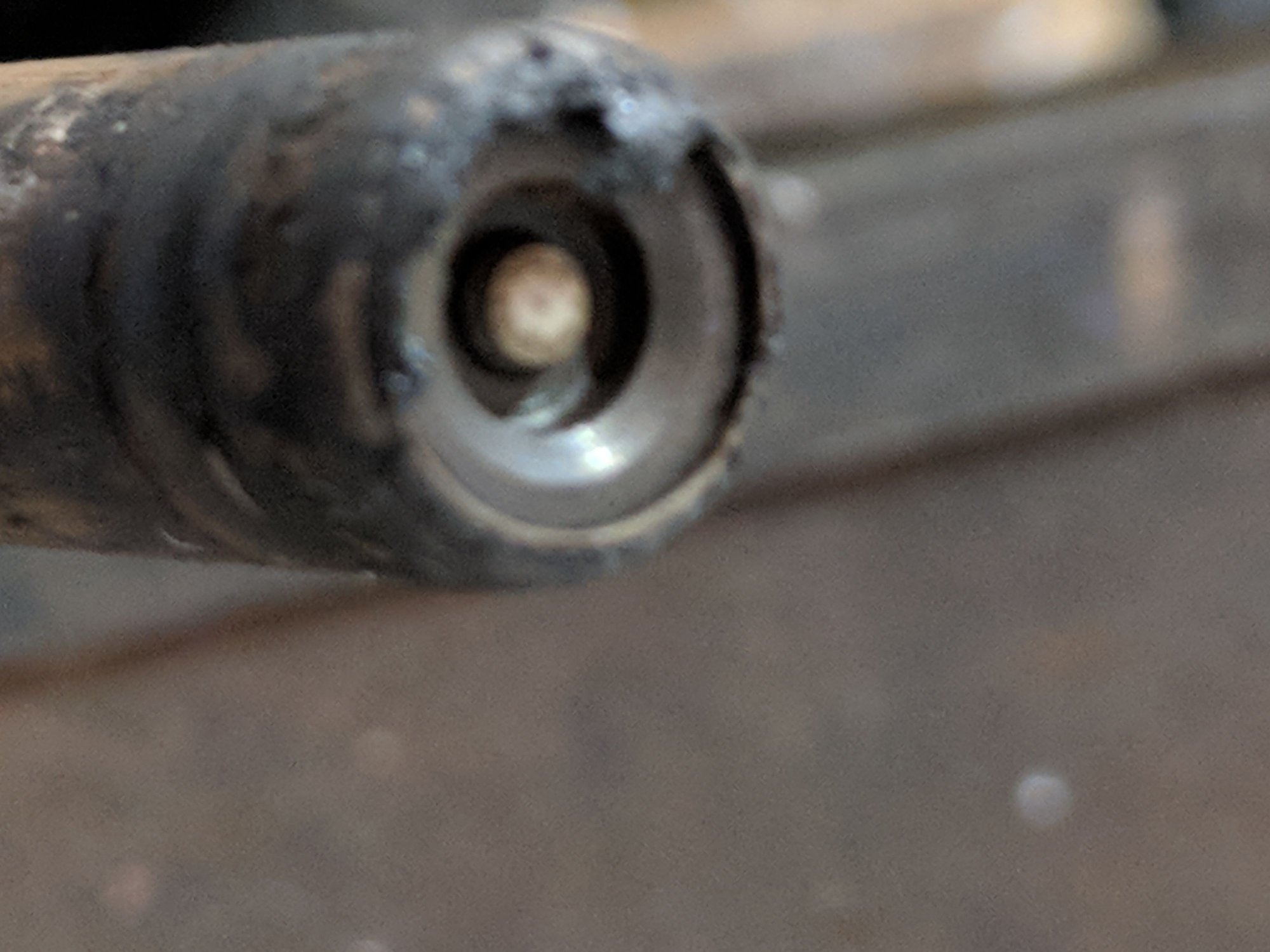

My largely original 78 started backfiring at cold start and also runs poorly when cold, so I'm replacing the injectors and seals. I am following Brad Smith's method he made a youtube video of, but with some twists. I am pulling injectors in car, I used a 1"PVC pipe as it's its much cheaper than copper and won't leave marks. One injector of left side had carbon buildup but the other 3 don't look bad by eye. The new seals have different shape but maybe due to being in there for 42 yrs. The tension sleeves are magnetic so not aluminum as reported.also the injectors were 12 mm. I took an hour to get one side done.
i think a regular nut would suffice, I didn't need more torque than a thread or 2 could handle.
