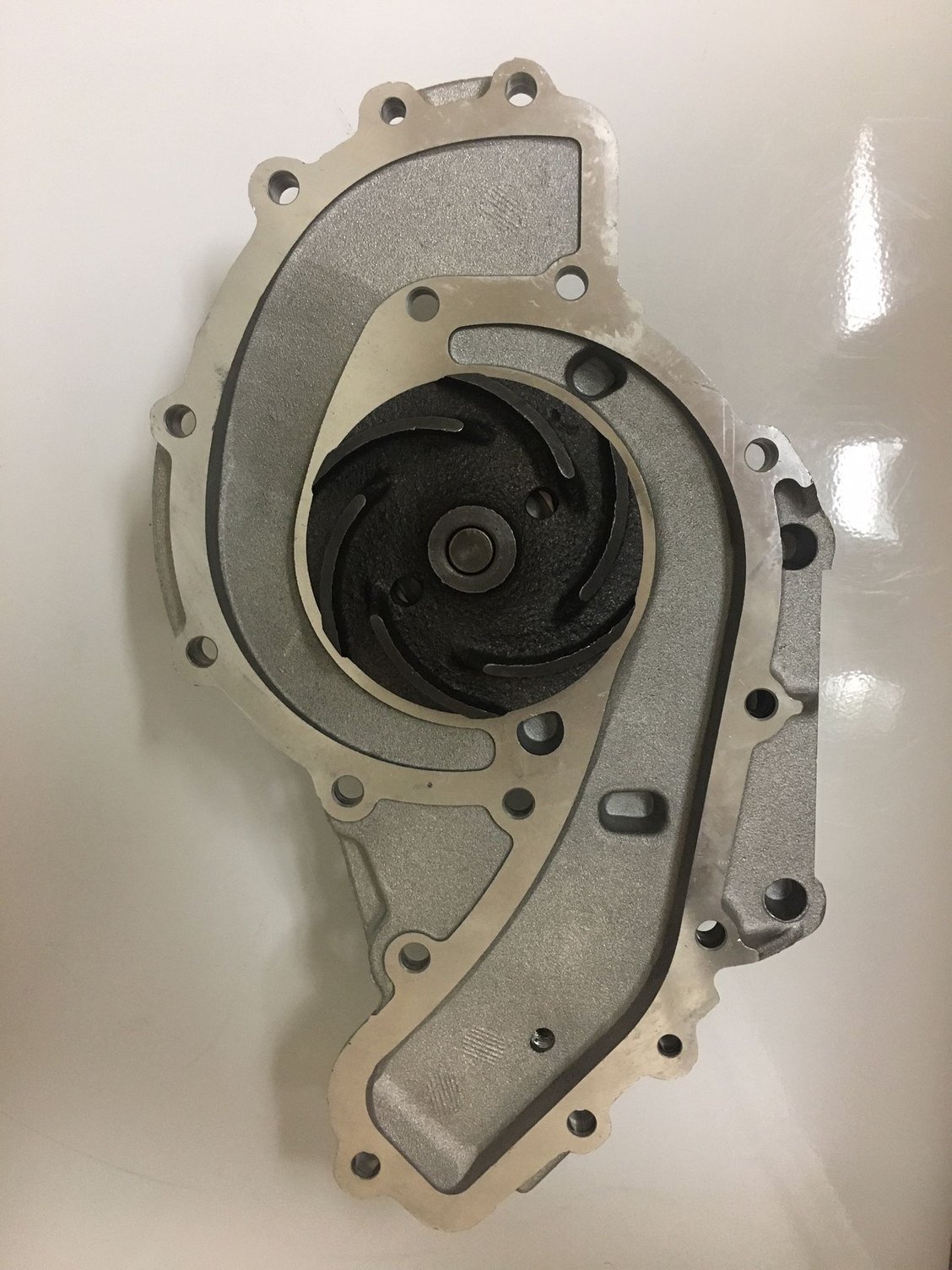

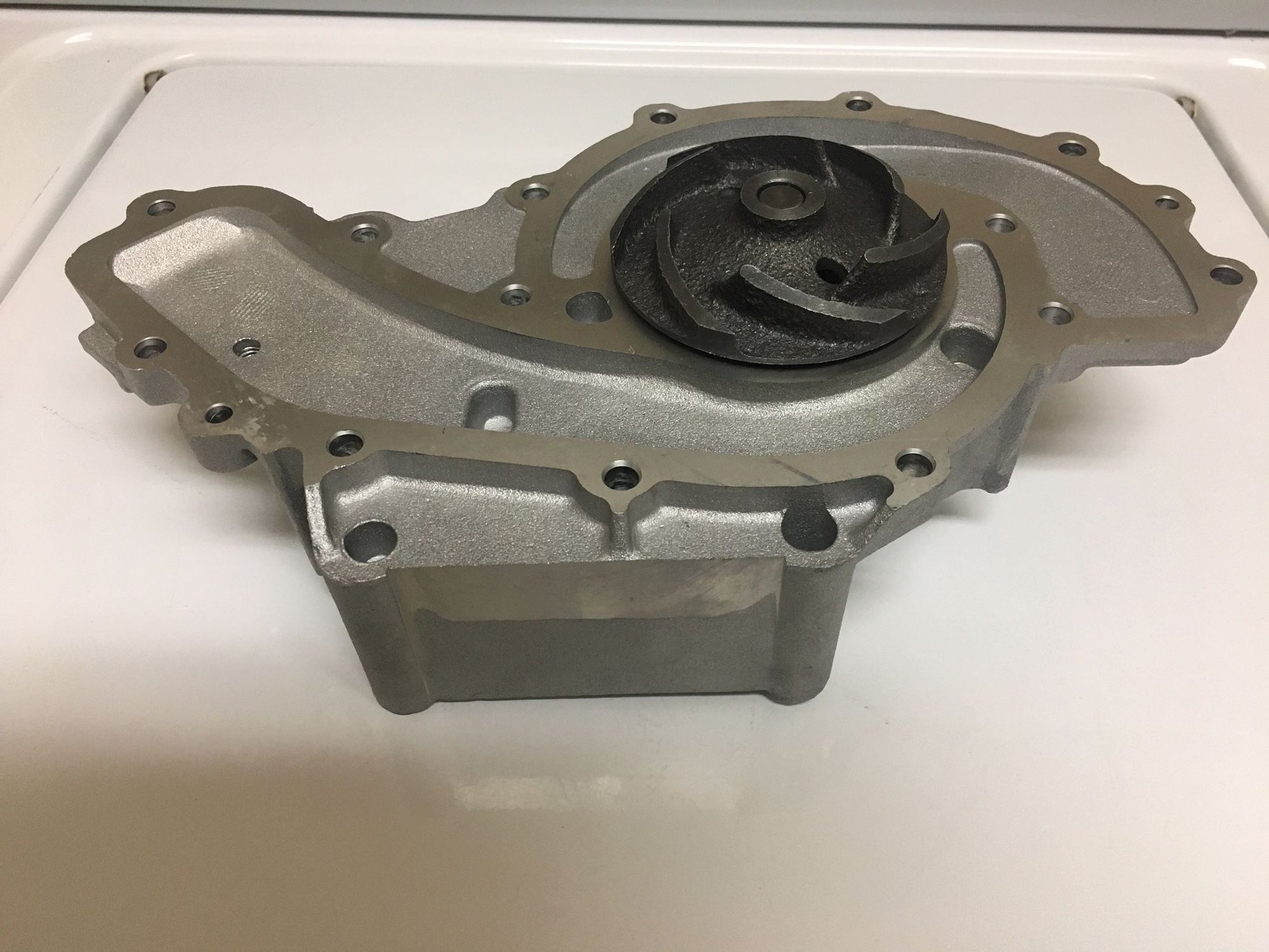

You might have paid too much, same pump is on eBay for $55, '78-87 (early style). Is the pump you are replacing an early style, with the shoulder-bolt and no bracket?
Please post a picture of the backside, it would be interesting to see what sort of impeller it has. And the VIN# of the car would be helpful.
Steel, no doubt.
None of that cheap plastic crap, here.

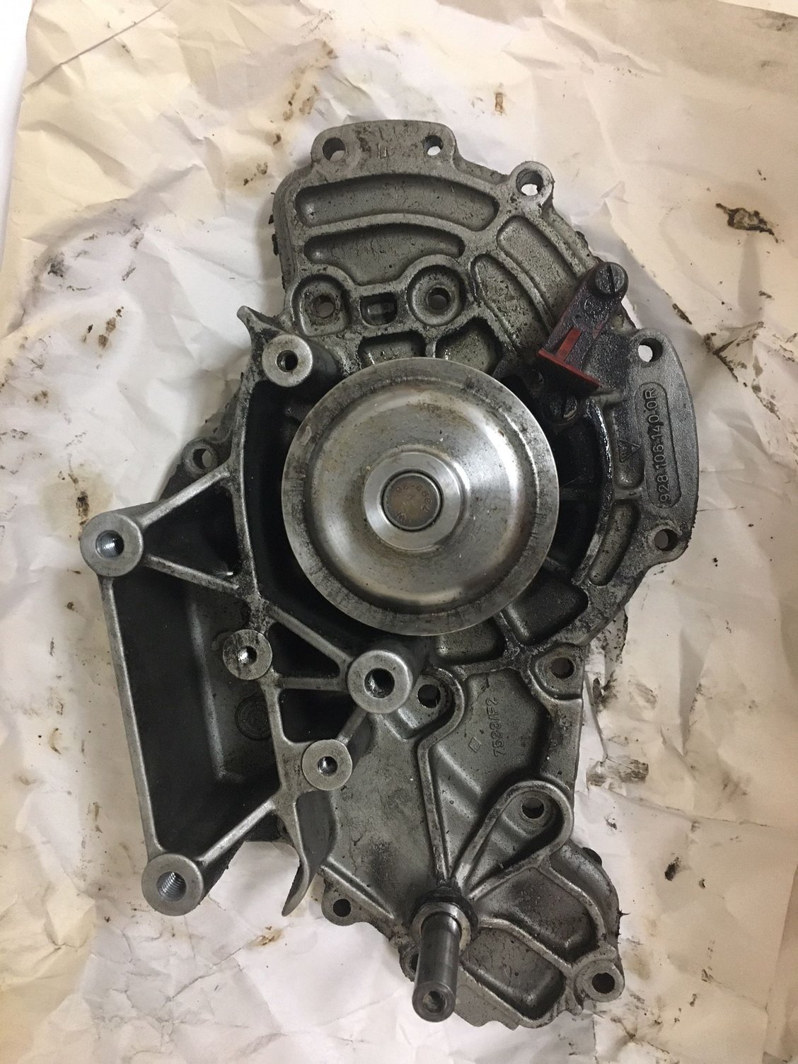

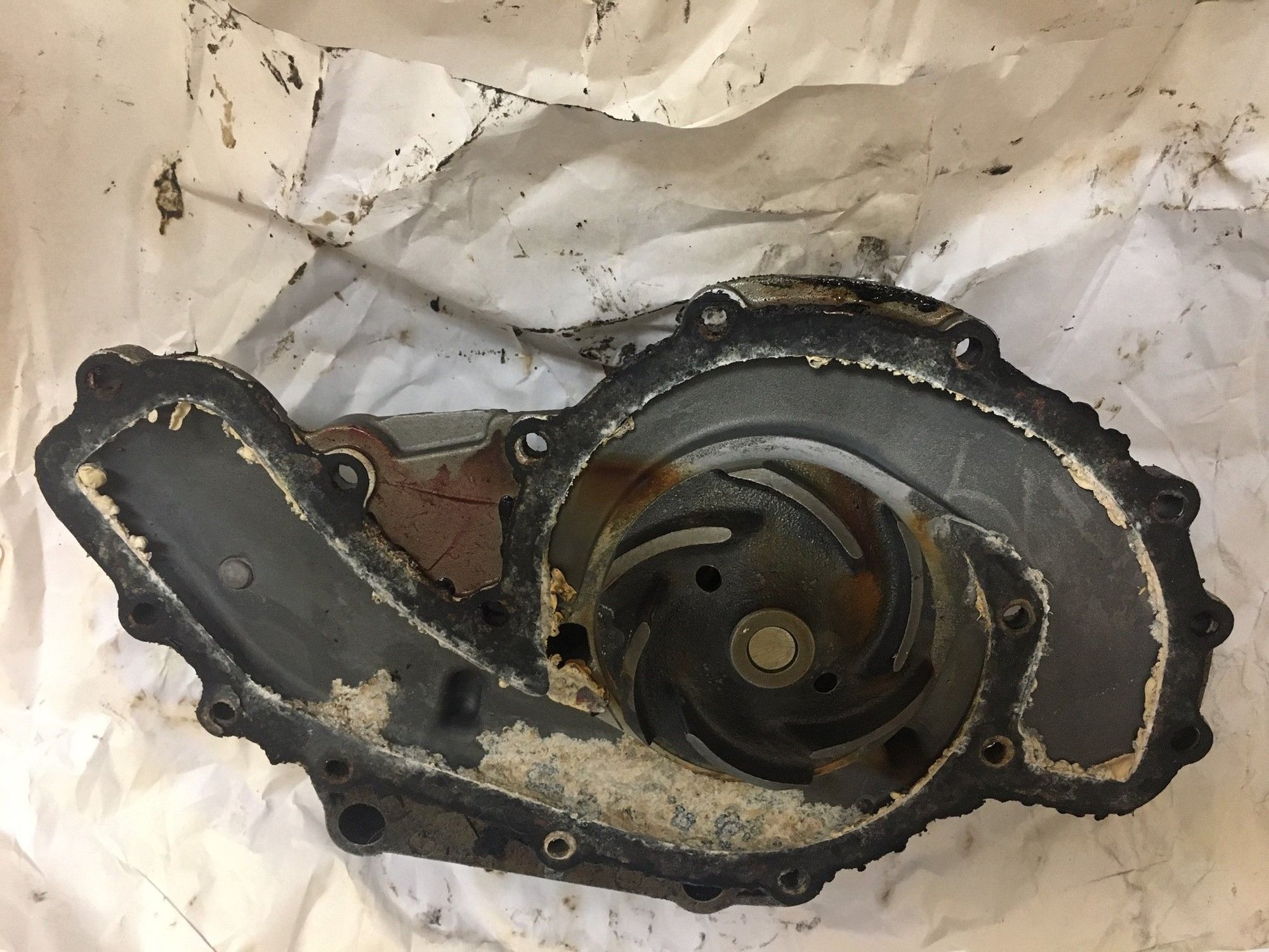

Yes, I also saw I saw another one on A1 Parts also for $55 but if it's too risky to install I may have wasted money on it regardless. I'm not sure if I'm replacing an early style, with the shoulder-bolt and no bracket or not.
Attached are pics of the back (impeller) side and my ViN is: WP0JB0929HS861261
Also attaching photos of front and back of old water pump....excuse dirt but a complete bath and restoration for car is in stage 1.
DIY Water Pump Backside 1
DIY Water Pump Backside 2

The DIY is an early pump, and the old one is different - bolted tensioner post?
jp 83 Euro S AT 57k
DiY lists both types. $55 for the early version and $65 for the later.

Well, the good thing about that DIY brand pump is that the impeller blades look nice and sharp and it appears that the impeller is “factory pre-migrated.”
