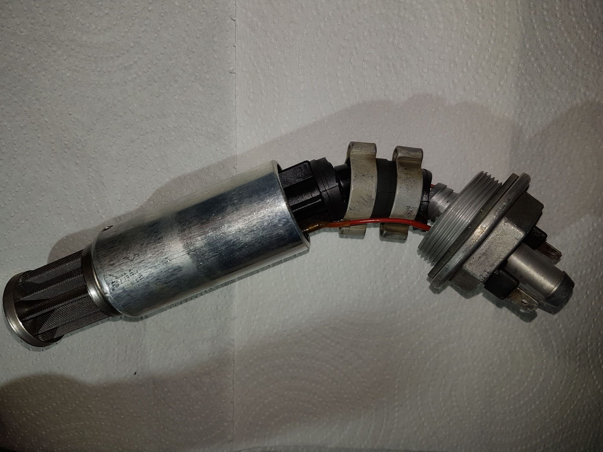

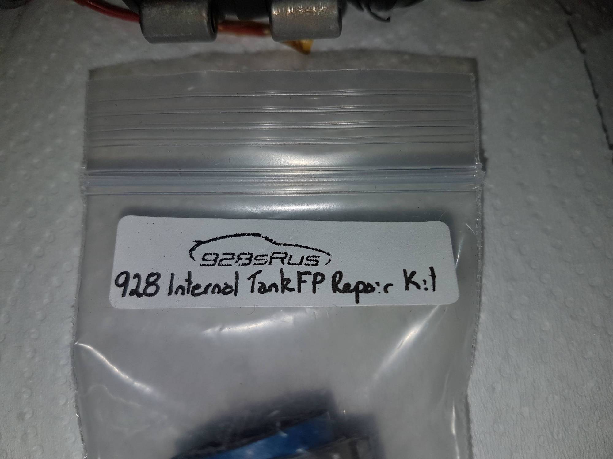

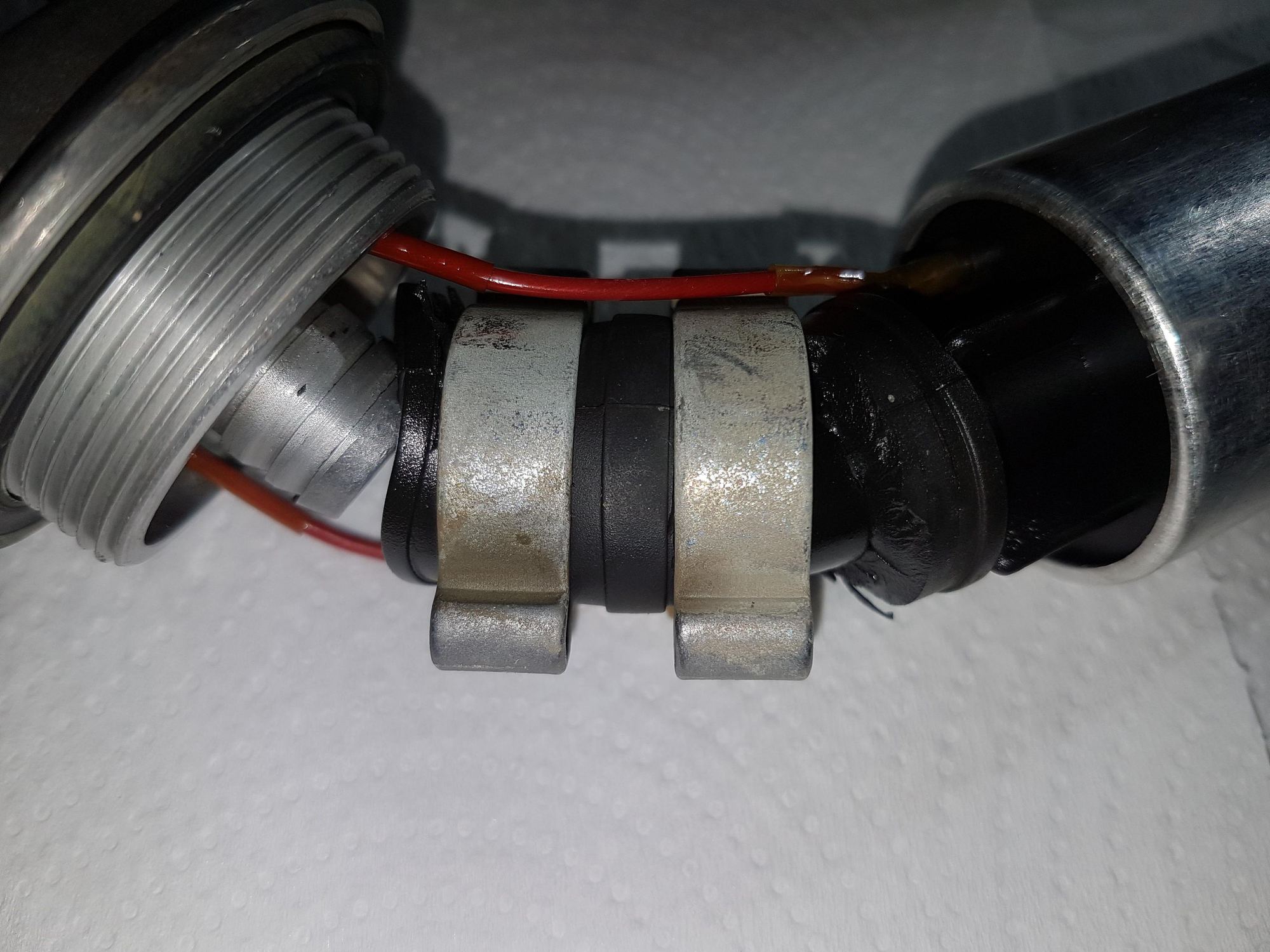

If your intank pump is still running, most likely the hose that connects the metal strainer/filter pump assembly has failed. Greg has a hose kit to replace the hose for good. Roger has the it in stock. If the intank pump is dead, follow Greg's advice.
