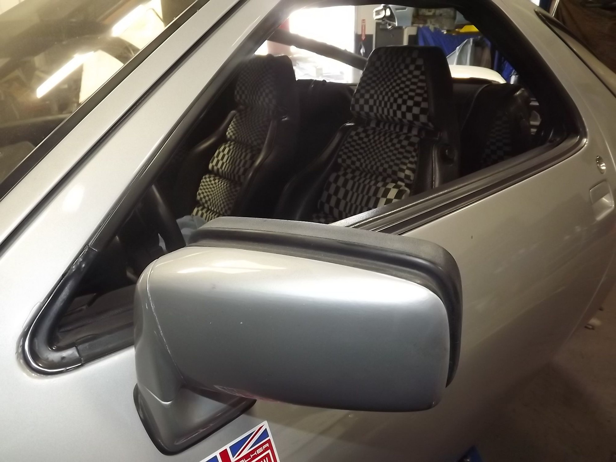

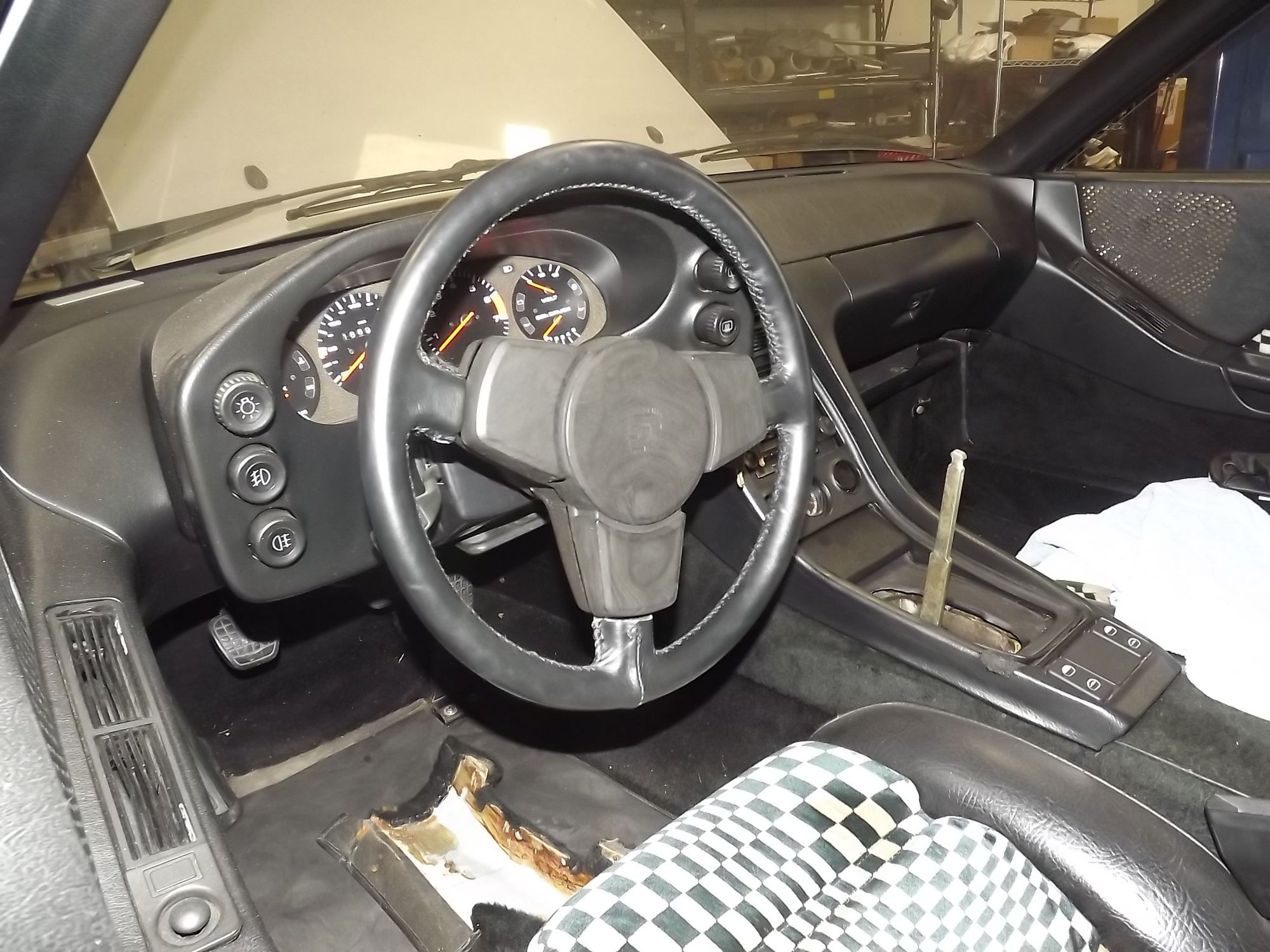

Really nice, very early Euro '78 with Pasha.
Pre-assembly, while I make magical things occur inside the transmission.
Original Pasha
Really original and really nice!

Do I spy a Magnus Walker sticker?
