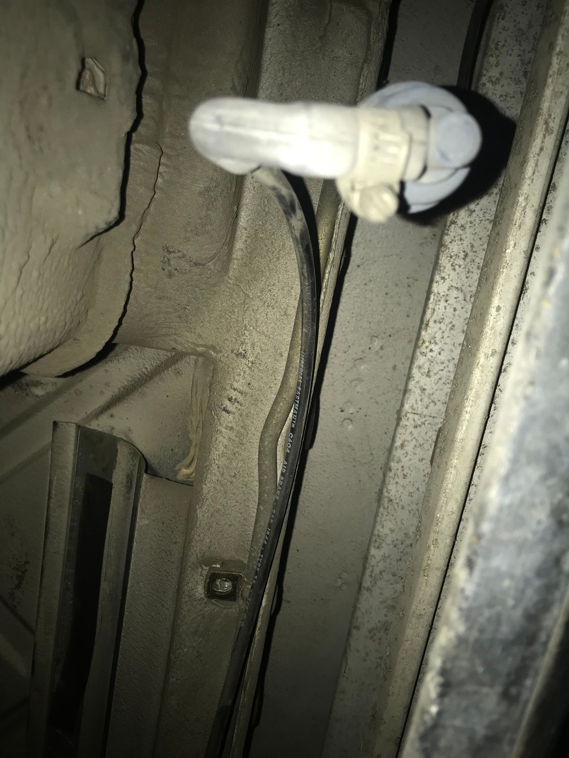

Another question while I’m at it. Why would there be air hose running back to the rear bumper from under the car?

My fuel tank filter sprung a leak, so I pulled it out and replaced all hoses and clamps. I also painted the cradle, and replaced the foam padding.
Any ideas what those hoses are in my last pics? They come up to the middle of the rear bumper and aren’t part of the fuel tank system.

I have seen somewhere a pic of a hose(or pipe?) coming off the vapour thing in the right rear wheel well going around to the centre rear of the car and down to the bumper level, ending with a thing like a reversed funnel - bellmouth. I suspect this is fitted to cars without the carbon cannister up the front - like mine.
jp 83 Euro S AT 57k
aha! That describes what I have too. Thanks for the info.
jp 83 Euro S AT 57k
My '89 C02 (California) car has the carbon canister plus it has that overflow line to the bell mid-car behind the tank. I can't [conveniently] get to that side of the car to see the source connection for that vent line. I may be able to get to it later today with some creeper gymnastics.
