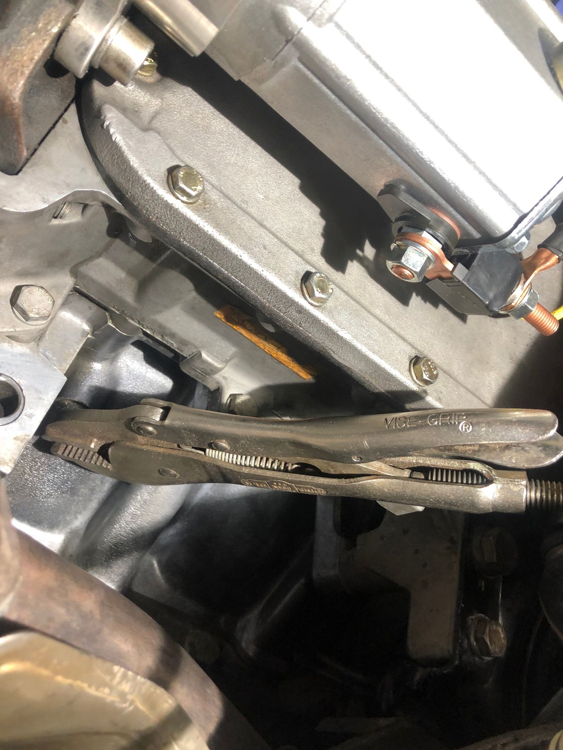

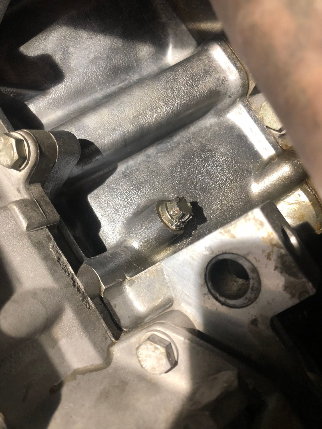

I’m in the middle of draining the coolant for the first time so I can do some work on the water bridge. I was able to get the passenger side drain plug out and that has drained. However the driver's side was previously rounded by one of the PO's and my attempts to remove it have made it worse.
It's in there tight! I’m able to get good grip with a visegrip Pliers but it will not budge. The vice grips just turn off the bolt.
I've sprayed it a bunch with PB Blaser and tapped it with a fairly heavy steel hammer. I don't want to hit it too hard for feet of doing some damage to the block.
Thanks for your help in advance!

See if you can get a two foot long steel pipe over the end of the vice grips with the tightening screw. Make sure it's tight and give it one try warm, and with improved leverage. Also, make sure the vice grips are on just like in your picture, so that the loosening torque squeezes the grip closed, rather than forces it open. I'm amazed how well a cheater bar works.

Hi Dan, the vice grips just turns off of the head. i've tried to grip is a tight as I can, but it still rounds off the head. Heat may be the answer.
Originally Posted by Mrmerlin
will the engine run? if so run it for about 5 mins then use whatever tool you have to loosen the bolt. One other thing I forgot to mention get a big sledge hammer and hit the bolt head into the sealing washer ,you wont get much of a swing thats OK, The weight of the mallet should deform the sealing ring a bit so the plug comes free
Hi Stan, thanks for the tip. I've been hitting it with a fairly heavy mallet and still no dice. The engine will not run as I have drained the coolant and have part of the top end taken apart. Heat seams to be a good tip. Since I can't run the car should I heat it with a heat gun, or is there a good attachment to my torch that I can localize the heat directly on the bolt?
Here are the tools I've been using. I was thinking maybe a smaller pipe-wrench would give me the proper leverage, or maybe a more round jaw vise grips.
I am going to take a break tonight and will hit it with PB blaster and tapping for a day or two while I gather options
