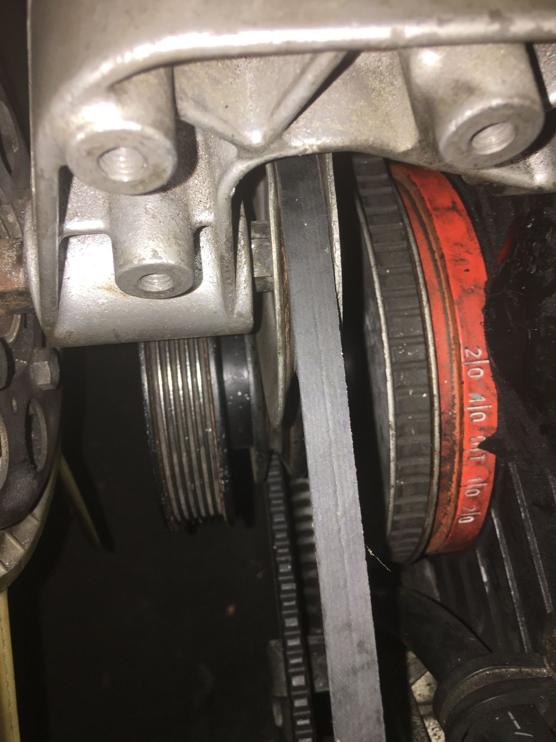

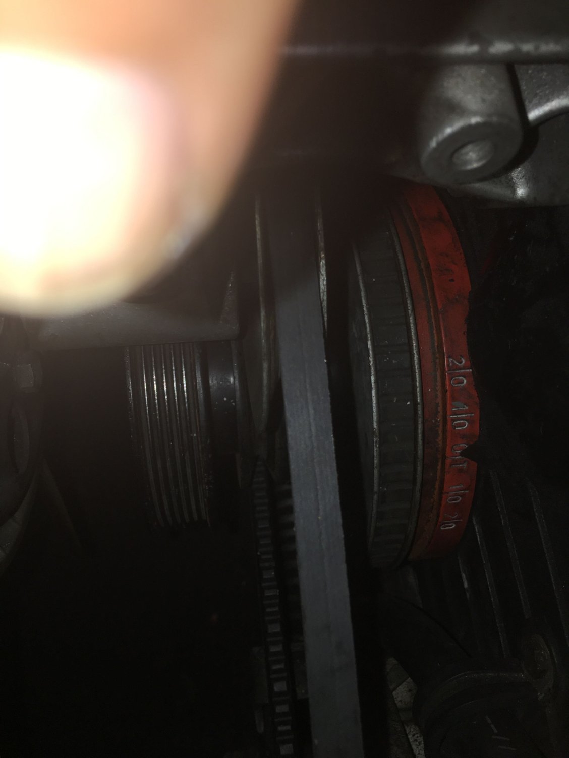

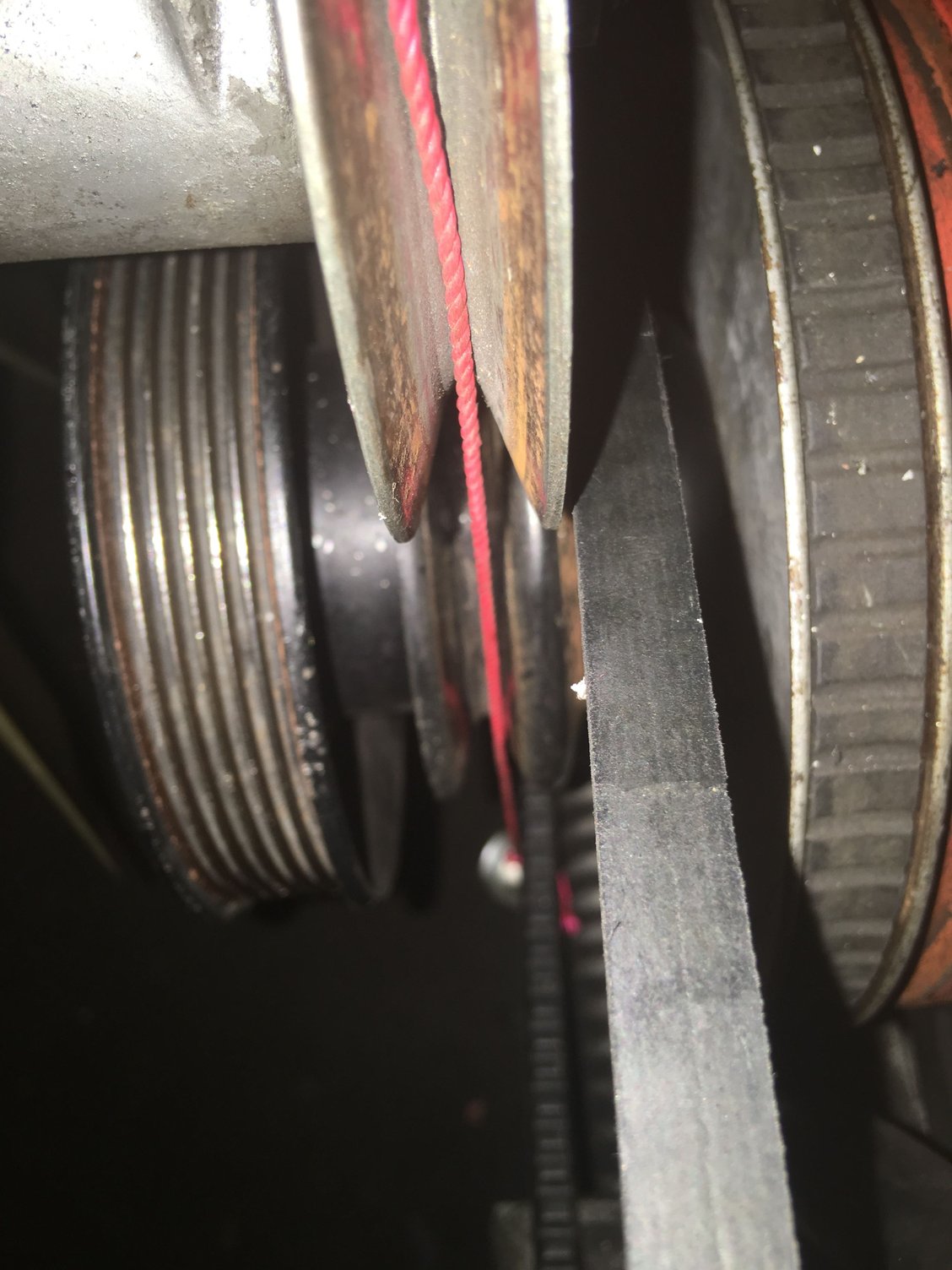

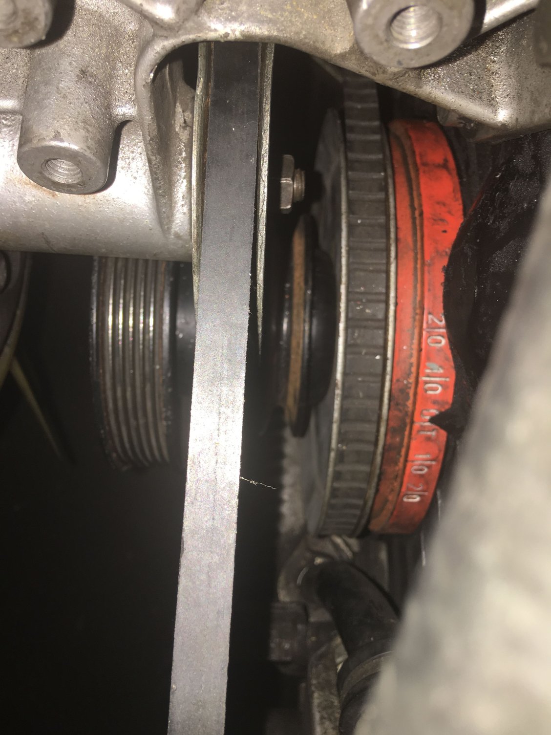

Hard to show with pictures but the fan assembly needs to be moved forward to align with second section of the pulley.

The Cooling fan belt originally shared the Air Pump for tension adjustment, (guessing your Air Pump was removed)
The PS Pump should be a stand alone belt.
Get a short 20 or 21" belt (Roger@928sRus) has them and run that from the Crank to the Fan, then get the correct belt for the PS pump.
I did this one last week on an 86.5 that hasn't run in over 12 years .
Dave K

After looking at the Pic w/ the string, you could use three correctly sized washers and shim the Fan mount out a bit, doesn't look like you would need more than a few mm.
