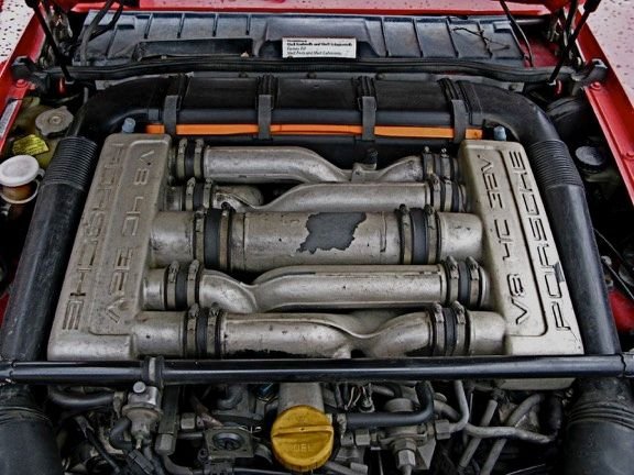

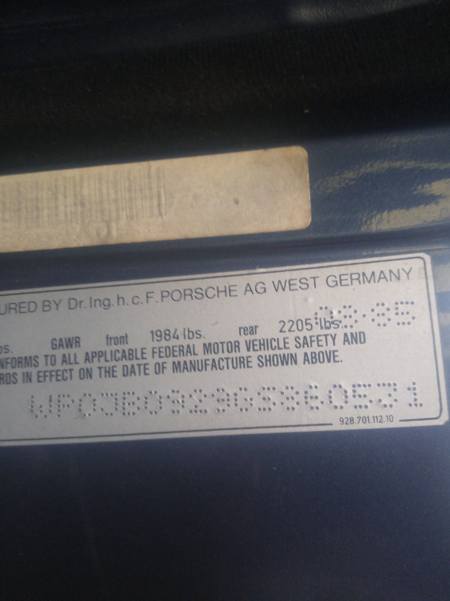

Its been a while but I am just getting to the point where I will (might) be able to start diving into this amazing machine. I have a long ways to go. Its a money thing. A project 1990 XJS convertible,,, a 2002 Jag XK8 daily driver and now this, an amazing 1985 manual trans 928 as it turns out will leave ya turning over shaking the piggy bank. I'm not a rich man.
I do feel a little foolish,,, but I'm a little confused about what to understand as far as the exact make an model of my 928. I have understood it as a 1985 according to the VIN, plain and simple. But I see different things when I google the engine and when going for parts. Mine has the intakes like below (see pic) and all this time I was thinking it fell under the 86.5 idea, but later began to think (prolly for good reason) that I really dont know what I am talking about, thinking or what I even have here. I would love some help.
According to this VIN - what should I understand? What is the magic in reading VINs on the the Porsche 928, if any???
Any guidance at this stage in my "development" (I am a 928 humble newbie) would be greatly greatly appreciated.

Early 86 US model (last four under 1000). Built in Aug of 85 which is the start of the 86 model year in the US...
So basically same as US 85 model.....and not a 86.5

BTW,the "G" in the VIN denotes 86 model year. 85 would have been a "F".
and euro models have VINs that start with WP0ZZZ (US is WP0JB0)

Last four digits of the VIN is the sequential build number. Yours is 0531. so essentially the 531st US 86 model year 928.
The 86.5 is desired because it has essentially what would become the 87 and up S4 suspension and brakes. (bigger brakes, and slightly different underbody changes). Search here on Rennlist for 86 vs. 86.5 to find a full list of the changes.
No real differences between the 85 and early 86 (US models).. Euros are a totally different story .

Just for grins, here's the option list for your car. No rubstrip no Rogerbox, sport shocks and limited slip diff, nice!
WP0JB0929GS860531
1986.0
C02 - 49 state U.S. Market
M28.43 - engine serial # range 81 G 00001 >05000
G28.11 - transmission serial # range 11G 05001>10000
I158 - Blaupunkt radio 'Monterey' - 86
M220 - Limited Slip Differential, 40%
M319 -Changed set-up of fan (additional engine cooling for hot climate countries)
M474 - Sport shock absorbers- Sport shock absorbers Bilstein '78-86.0
M481 - 5 speed manual transmission
M490 - Hi-Fi sound system ( 8 speakers, balance control, 1983-86.0)
M494 - 86- Additional Amp -Blaupunkt Quadro BQB-80
M533 - Alarm
M650 - Sunroof

Yours shows a build date of 8/85, but it came after the changeover in July, so it's a model year 1986. The factory did the model year changes in summer, and the 'new year' became available in fall.
