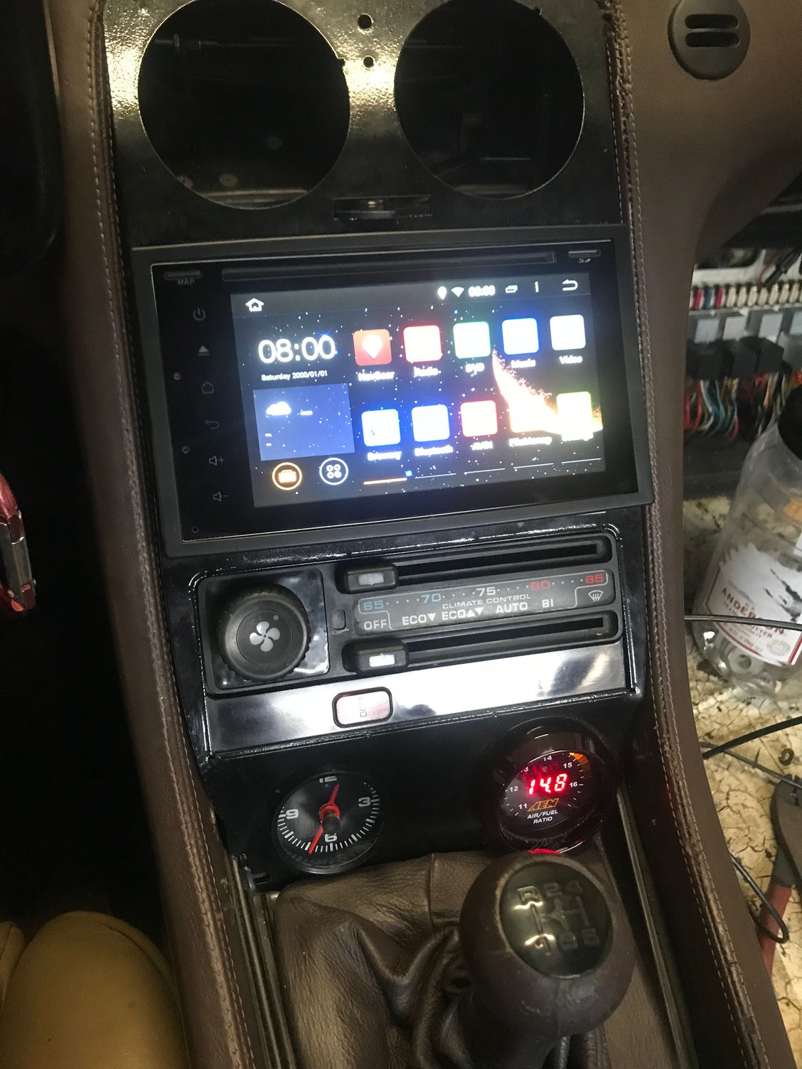

Got console and controls put back in my 82
hvac control head head seems to work, but the center flap won’t open, I get only heat from door vents (all the time), and when I turn the lower slide all the way to off (left) i get a chatter or clicking in the controller.
i believe Walt has a similar issue....the outside air sensor could be an issue, right? The hose is all mashed up in the front bumper....this could be the heat problem
i rebuilt the actuator while I had it out, the P.O. had disconnected and plugged the vacuum lines. There are 2 lines on the center actuator. I assume if these are reversed, it won’t open?
whats up with the “chatter” when I slide the lever to the left?
any help or ideas would be appreciated.
