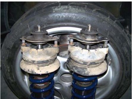

I'm trying to troubleshoot a crunchy noise when going over speed bumps and other large bumps in my front right suspension. I've eliminated many things: sway bar bushings, drop links, upper and lower ball joints, tie rod end...
So today I compared my right (noisy) struts to my left (good) struts and noticed a few differences. Could any of these cause a crunchy noise:
1. Right spring does not look seated properly in the top washer. It looks like it should be rotated another 10 degrees so the end of the spring stops in the washer.
2. Top of right suspension looks like it is missing the mounting (928 343 051 01) or something else. Note: Left side is higher than right side. Is there something missing on the right side?
Image orientation: Right side / Left Side

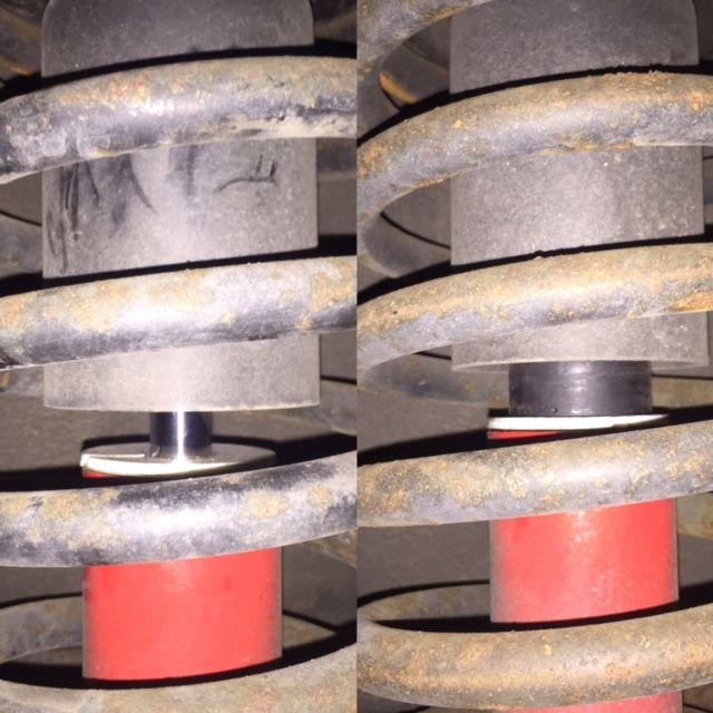

3. It looks like the right strut is missing the additional spring (928 343 527 02) between the strut body and the protective tube. Could this cause over-compression of the strut when missing?
Image Orientation: Right side / Left Side
Could any of these differences be causing a crunchy noise on the right side during large movements?

Is part number 10 from the diagram above installed upside down on the right side?

In picture 3 above, the secondary bumper pad on the right side could just be stuck up higher under the dust boot, whereas the left side one could have slid down.
That seems to be absolutely correct! I found this image on 928motorsports.com. It looks like when the mounting is installed upside down, the shock can over-compress, especially when the bumper is missing in my case.
I bet the shock is bottoming into the adjustment mechanism on the bottom.
It's not there. I just ordered it.

I agree the problem is most likely in the top mount (item #10 in your Porsche diagram).
We have started to see these failing, allowing the suspension to collapse. I punched my first one out during Pikes Peak in 2007.
It caused me to come back and make this billet replacement part:
https://928motorsports.com/parts/front_spring_perch.php
NOTE: this part will only work with 2.5" diameter springs.

The secondary bumper pad probably got mashed flat and destroyed itself. Sad to say it gave it's life to save the shock when it did bottom out.
