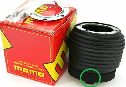

Do you have an original steering wheel? I'd try putting that back in. An aftermarket wheel usually requires an adapter and it's essential that it have a tab on it.
If this checks out, an Internet search will turn up lots of suggestions of things to look for with regards to the turn signal. Including this.

Turn signal have to take the wheel off and look for the little tab..
