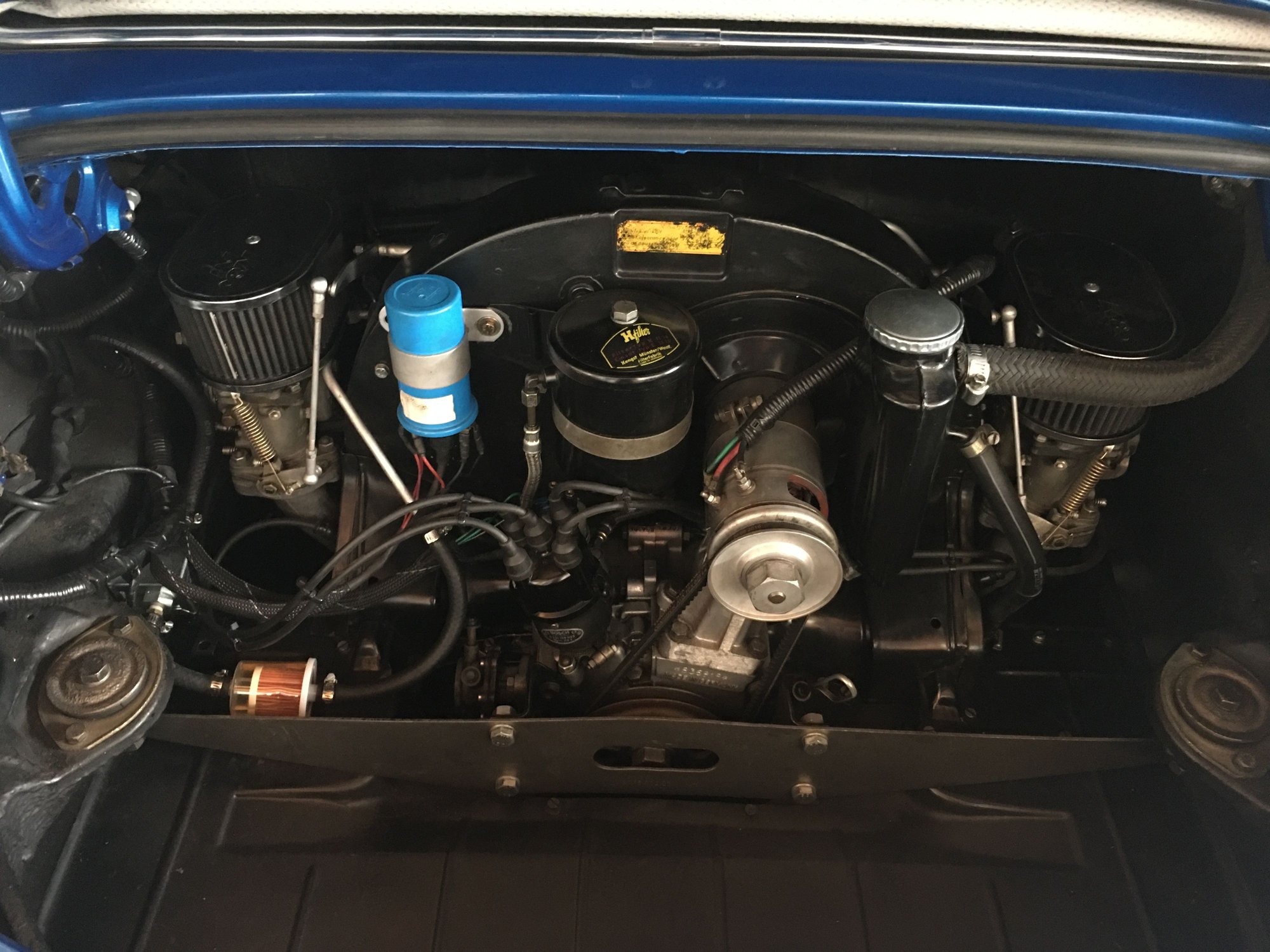

I’m not sure of the condition of your pad but I actually have gone without a pad at all. I painted the engine compartment satin black and since our 912s are really raw I don’t believe the sound deadening does a whole lot.
Now having said that, my car is a Renegade/Outlaw style so having the pad gone does not matter to me.
I think the engine compartment looks very clean painted without it. You can check out all my mods on my string here on pelican.
