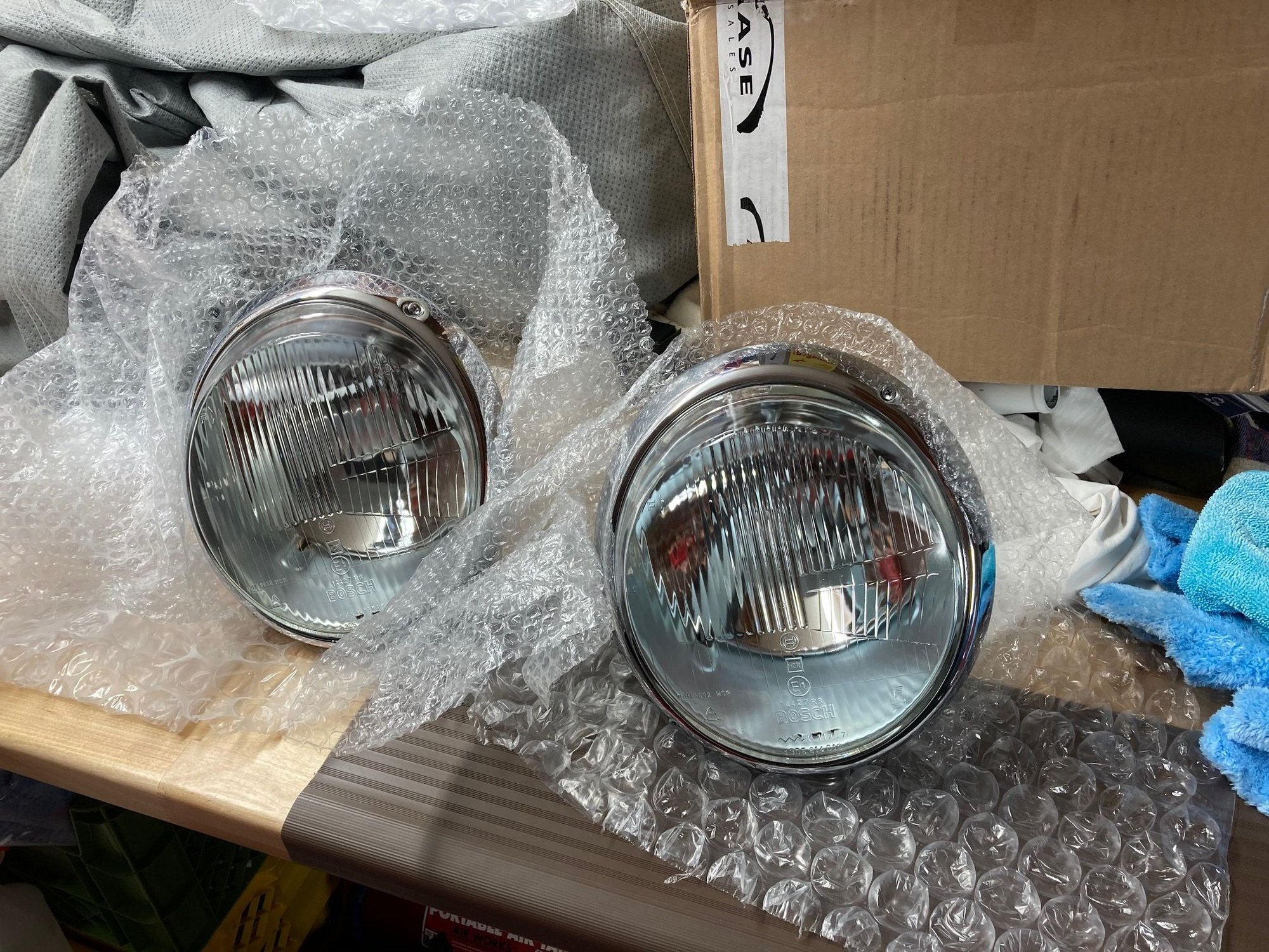

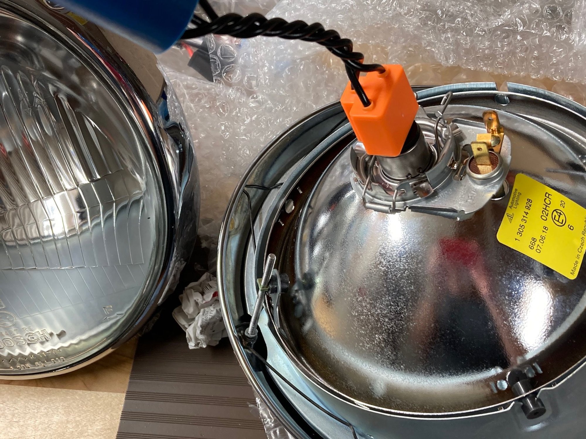

When I converted from H5's to H4's I gathered up the following parts.
Qty (2) h4 headlights, (2) adapter harnesses, (2) h4 trim rings, attachment screws and other small parts.
My h4's were used and required some repair before installation, check the classifieds you might find a good used set.
Had the trim rings painted to match body color, h5 rings don't fit. Running 55 / 65 watt bulbs for now, will be installing relays before installing higher wattage bulbs.
There are relay kits available for 1989 and earlier 911's, 964's have a different fuse setup and a Rennlist member has put together a kit for them.
