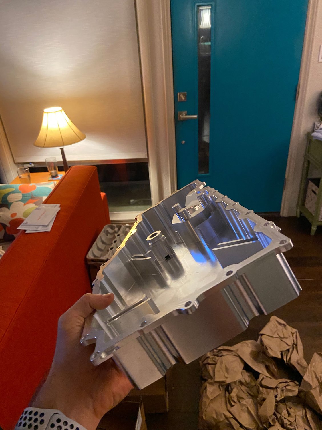

Thats a good looking pan!

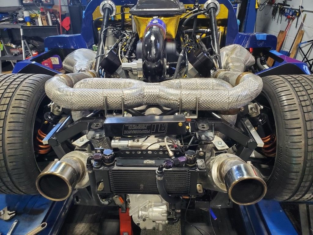

We've also been very curious of how much heat soak the oil system is taking on due to the exhaust running along side it. Our Headershield product seems like a perfect fit for this. We've put it on everything from street cars to Indy Lights and even the new Ford GT factory race car exhaust is standard with it with great results. If anyone is interested in giving it a try to get some feedback lets talk!
We also have good Black Friday pricing on our 718 deep sump pans right now. The next batch is being machined now and will be ready to ship shortly.

Damn, should have waited for Black Friday sales, that’s some significant savings. Car is getting the oil pan installed as we speak.
I’m happy to chat with y’all about the exhaust wrap. Track day is December 12th and I can grab some data with just the pan and see what it’s like with the exhaust wrap on the next track event.

Got the car back and talked to the installer for a while. They said everything fits well under the stock engine cover; but is definitely closer than the stock pan, which is to be expected . They were a little confused by the pickup extension at first. They said it just presses on, over an o-ring; there's no threads or anything. Overall they said it was pretty easy.
Just thought I'd post that since there were some questions on how easy it was to install on the 718forum. Cheers.
