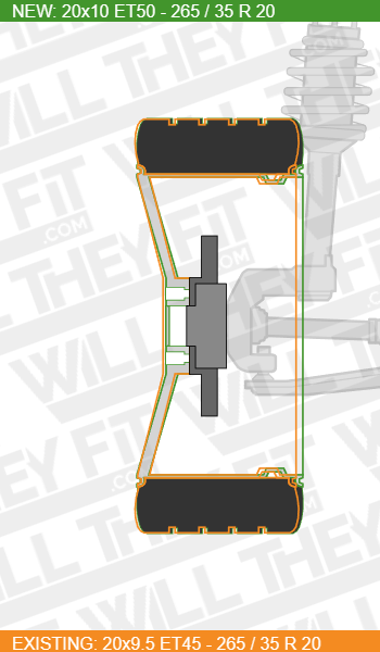

Rear: The 5mm of additional offset on the rear wheels give the final result:
The inside lip of the wheel is 1.35mm closer to the longitudinal center of the car.
The outer lip of the wheel is 11.35mm farther out (wider) in the wheel well.

Can you clarify this?
When I punch the Width and Offset into a calculator compared to the other 20" wheel, it says:
Compared to your existing wheel, this new wheel will have an inner rim which is 11.4mm closer to the suspension strut. The outer rim will poke out 1.4mm more than before.
That seems opposite of what you are saying?
