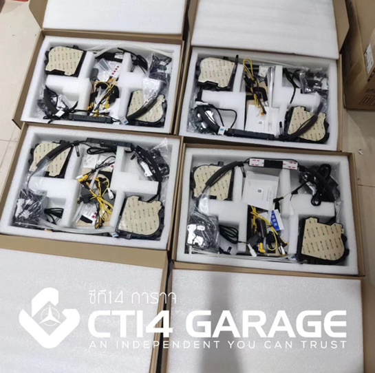

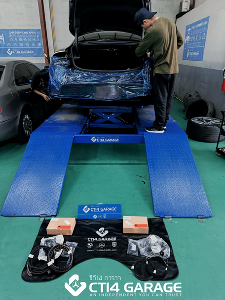

Anyways, today I'm gonna show everyone how I retrofitted Lane Change Assist (LCA) in one of my customer's Taycan. We have retrofitted ACC, RAS, Night View Assist, Soft Close Door, etc. However LCA is among the simplest ones.

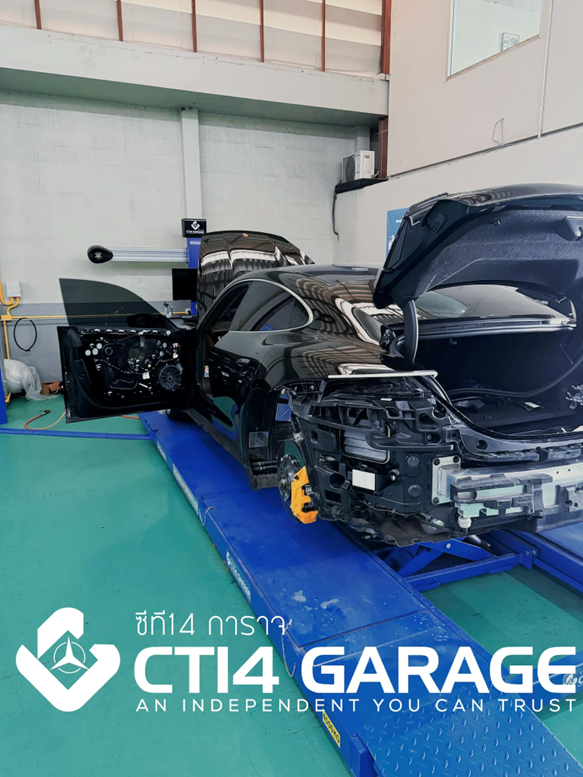

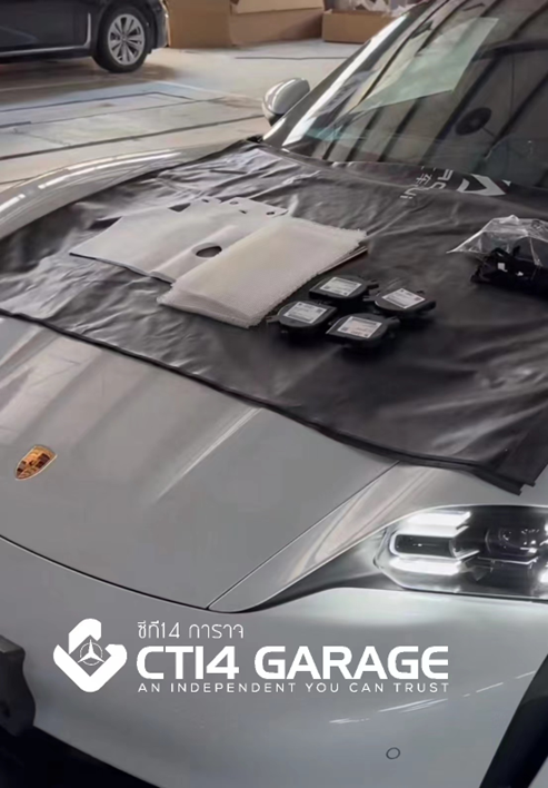

Step 1: Remove the rear bumper, install the frames to support the modules and install them:

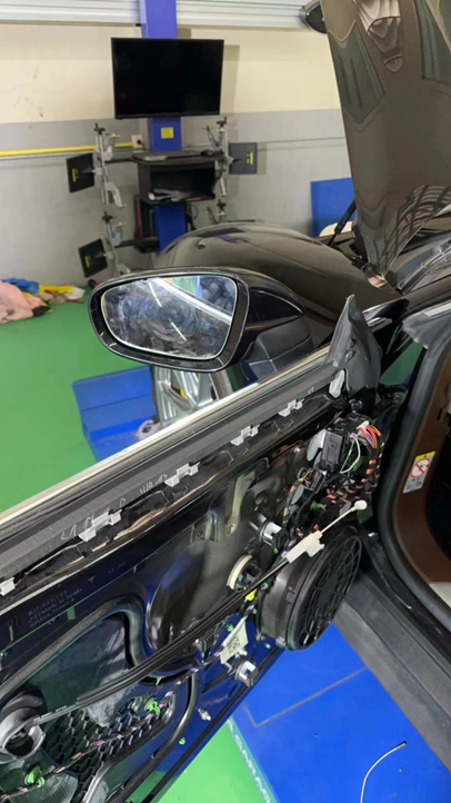

Step 2: Remove the door panels, disassemble the mirrors and wire the connector for the new mirrors with LCA. Then integrate the new wiring harness into the already existing one. My LCA kit comes with a wire with two terminals for the LCA mirrors. Connect the white wire to terminal 12 and green wire to terminal 4 in J386/J387 (door modules)

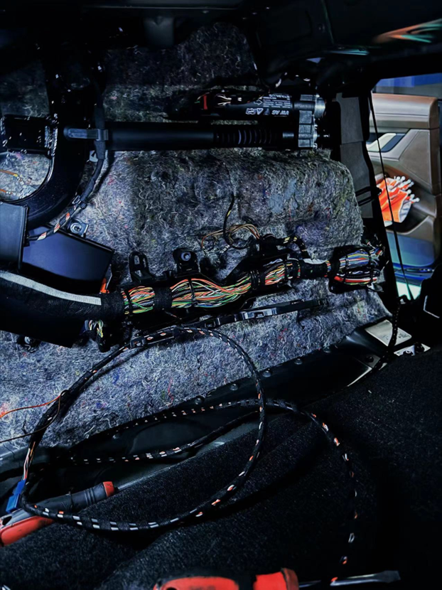

Step 4: Take my wiring harness from the LCA modules at the rear bumper all the way to the CAN gateway module (under the center console):
Step 5: Integrate the wiring harness from LCA ECUs into CAN GATEWAY harness.

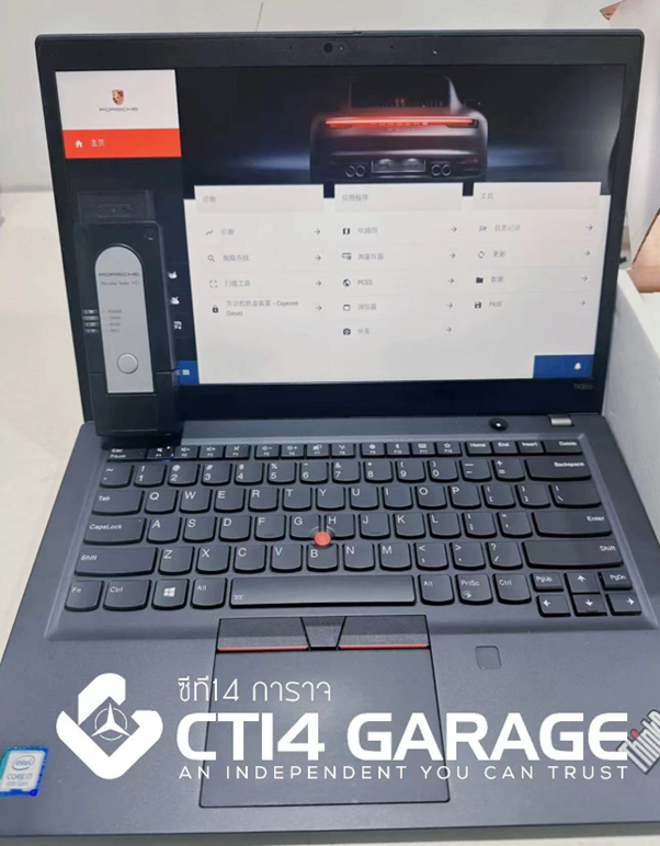

Step 6: Grab your PIWIS4, login to PIWIS ONLINE and add LCA to the car.

PS: We have kits for LCA, LKA, ACC, RAS, Soft Door Lock, Heated Steering Wheel. for models Taycan 9J1, Panamera 971, Cayenne 9AY, 992 & Cayman/Boxster 718.
If somebody needs a kit, I can ship it worldwide. BUT make sure your skill level will allow you to perform this retrofit beforehand. Retrofitting one of these is not like installing a Dashcam.

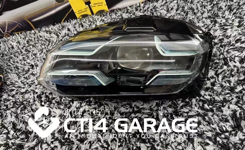

I could provide the Blue matrix for $3,700 US for the set and remote coding with PIWIS 4 included (you need SmartLink C to do it + I need to install a VPN in one of your computers and pray that your network will be fast lol). This does not include shipping to US nor US customs.
Be aware, for wiring I could provide the diagrams and answer your questions etc but you still have to do it yourself as well as disassembling (or find someone to get it done for you).
