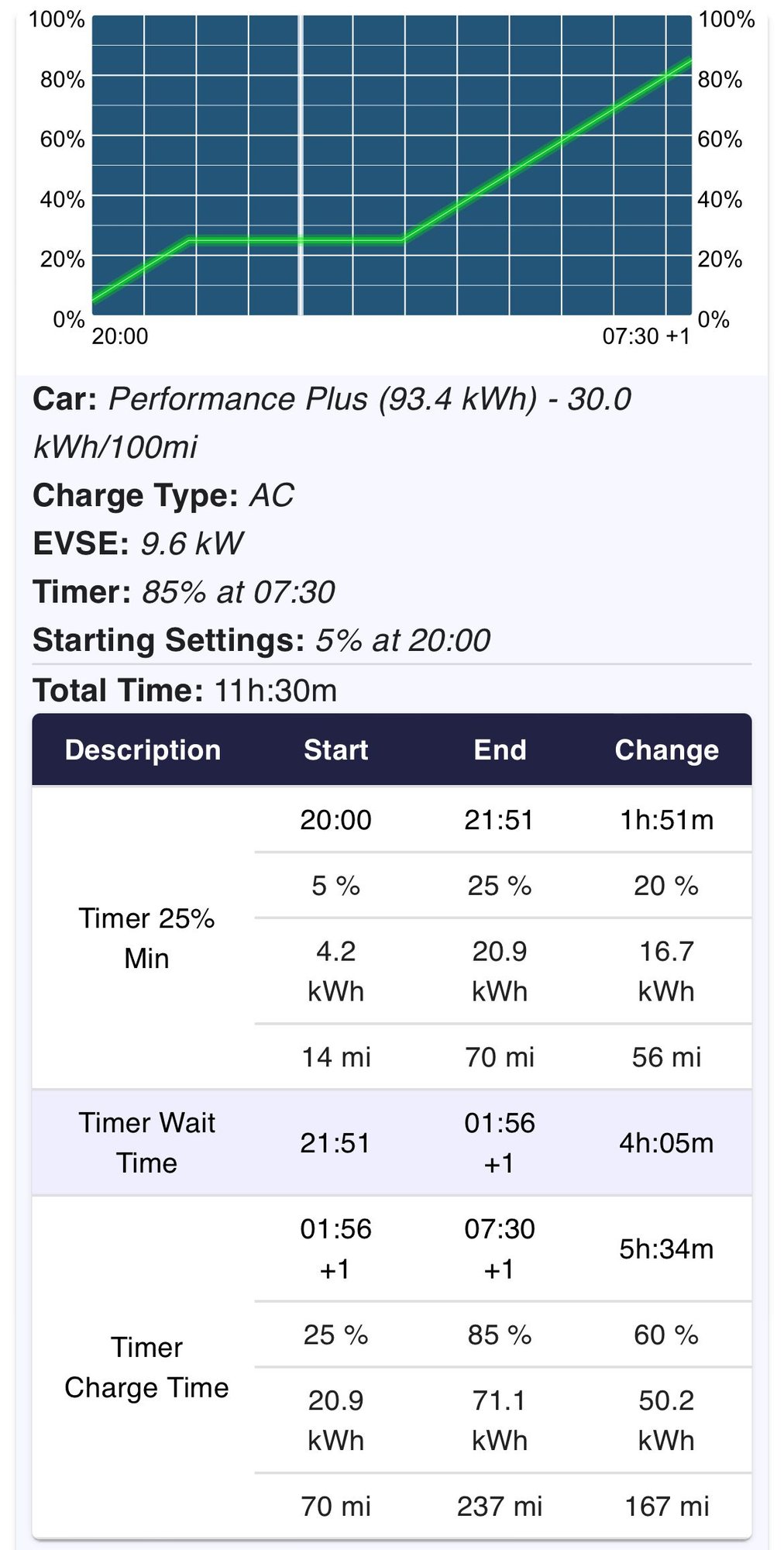

See example below. At 9.6kW and 85% target charge for 7:30am, the car won’t start charging until around 2am. Note that the car still does the 25% min, even without a profile.

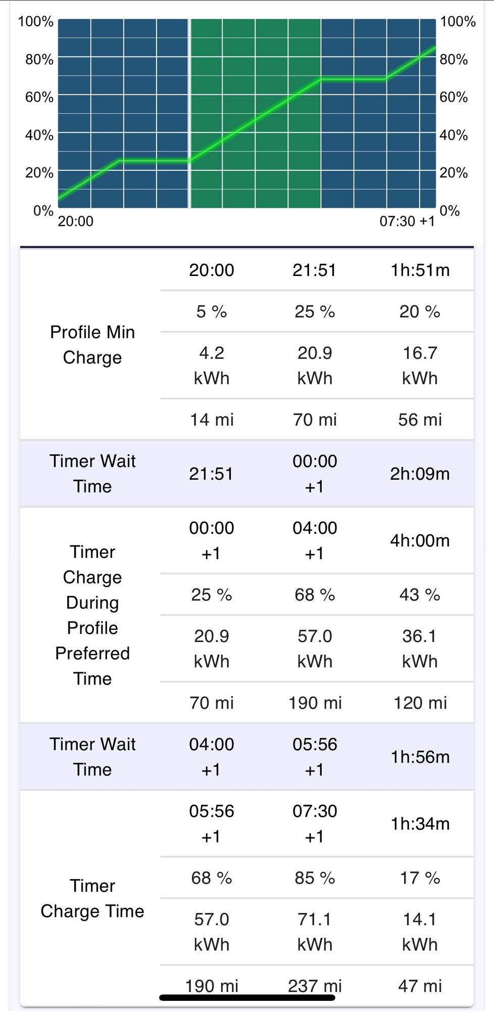

The only benefit to a profile and preferred times would be if you had a short window of time and wanted to force the car to use that window as part of its charge. Then it will use as much of the window as it can.
See below where I added a profile with a preferred time from 12am-4am. Now the timer utilizes that time. But outside of this use case, profile preferred times rarely make sense and timers by themselves are the best solution.
